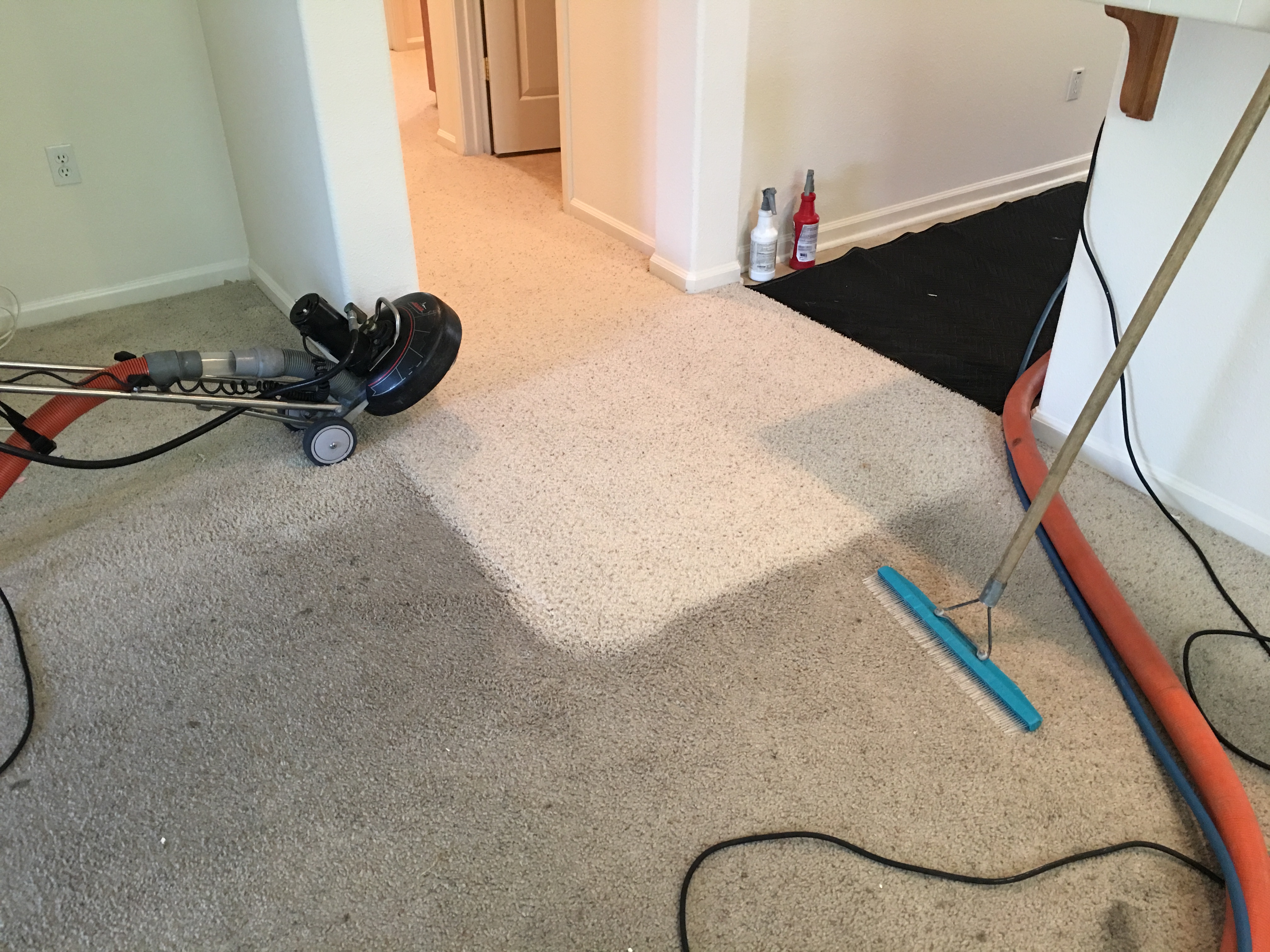

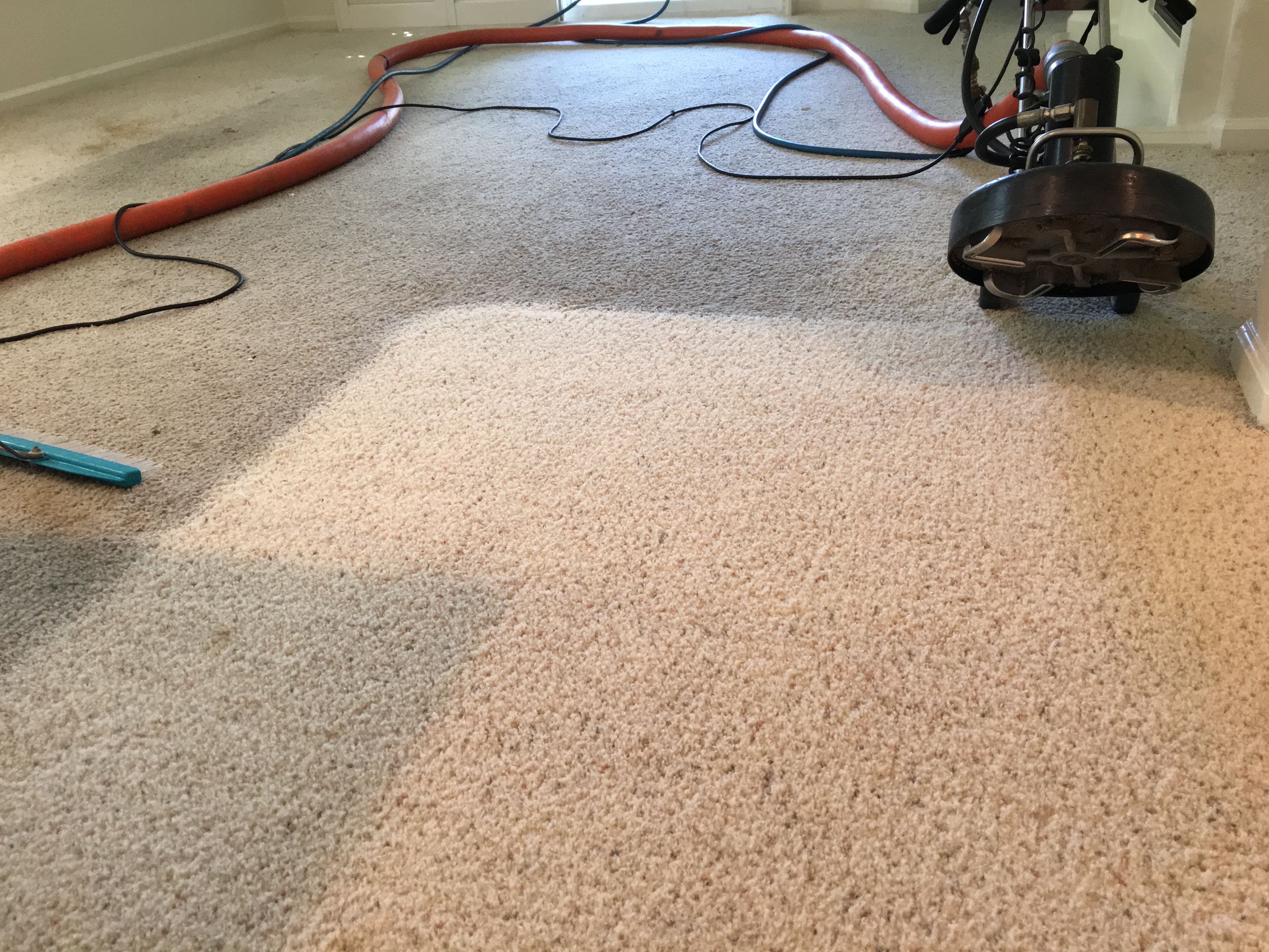

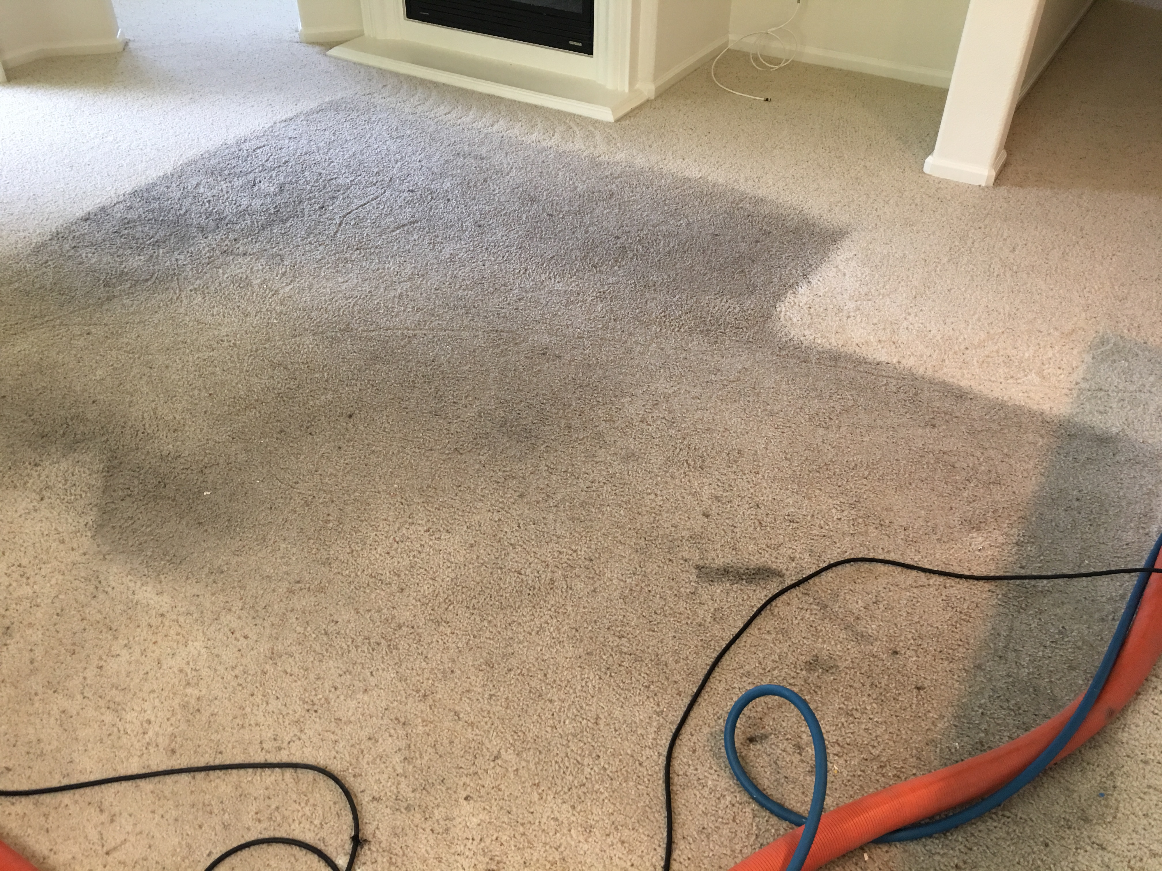

My guy used 65 gallons today to clean 600 square feet at 450 psi and 8 flow, including using a 09 tip'd Hydroforce for pre-spraying.., with the new Everest
How many ounces per sq ft is that, roughly....
I guess I am too much of a flusher. Doubling the water you used on 600 square feet happens all too often. :(
