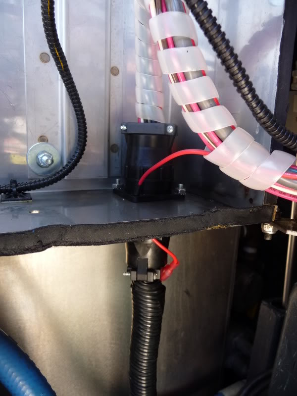

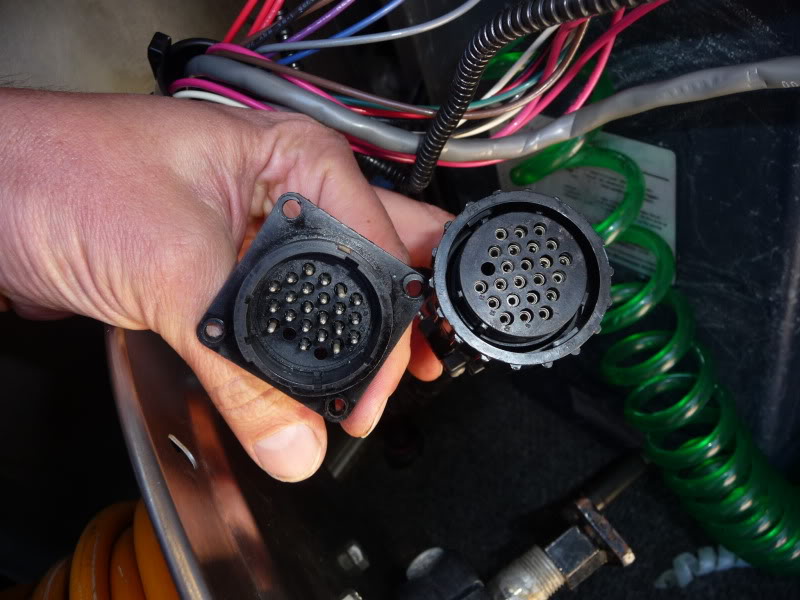

How are your electric skills Fool?
I've had a short that causes my panel to lose power for some time now. Now that I have my guys going out with out me today was the day I could no longer count on "Hit the box with your palm" or "Wiggle that clusterfuck of wires down there"..
According to Jim Martin, a retire electrician this coupler has no business being in a vibrating wet environment.
Yet there is is all 22 wires coming from god no's where into the control panel box.

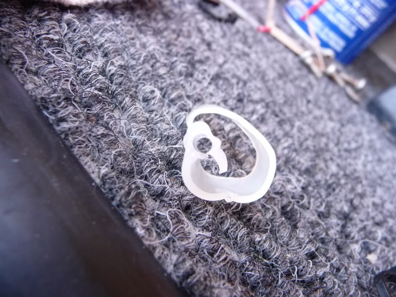

Some hamfisted hack at FMI decided it would be a good idea to include the white spiral wrap under the clamp that holds all those wires together. Notice how it melted around the wire.
So after bugging Jim for two hours on a Sunday afternoon we isolated the wire and took it out of that equation and routed it around the coupler.
Look up N%#@rigged in the Webster dictionary and you'll find this picture.. :shock:
