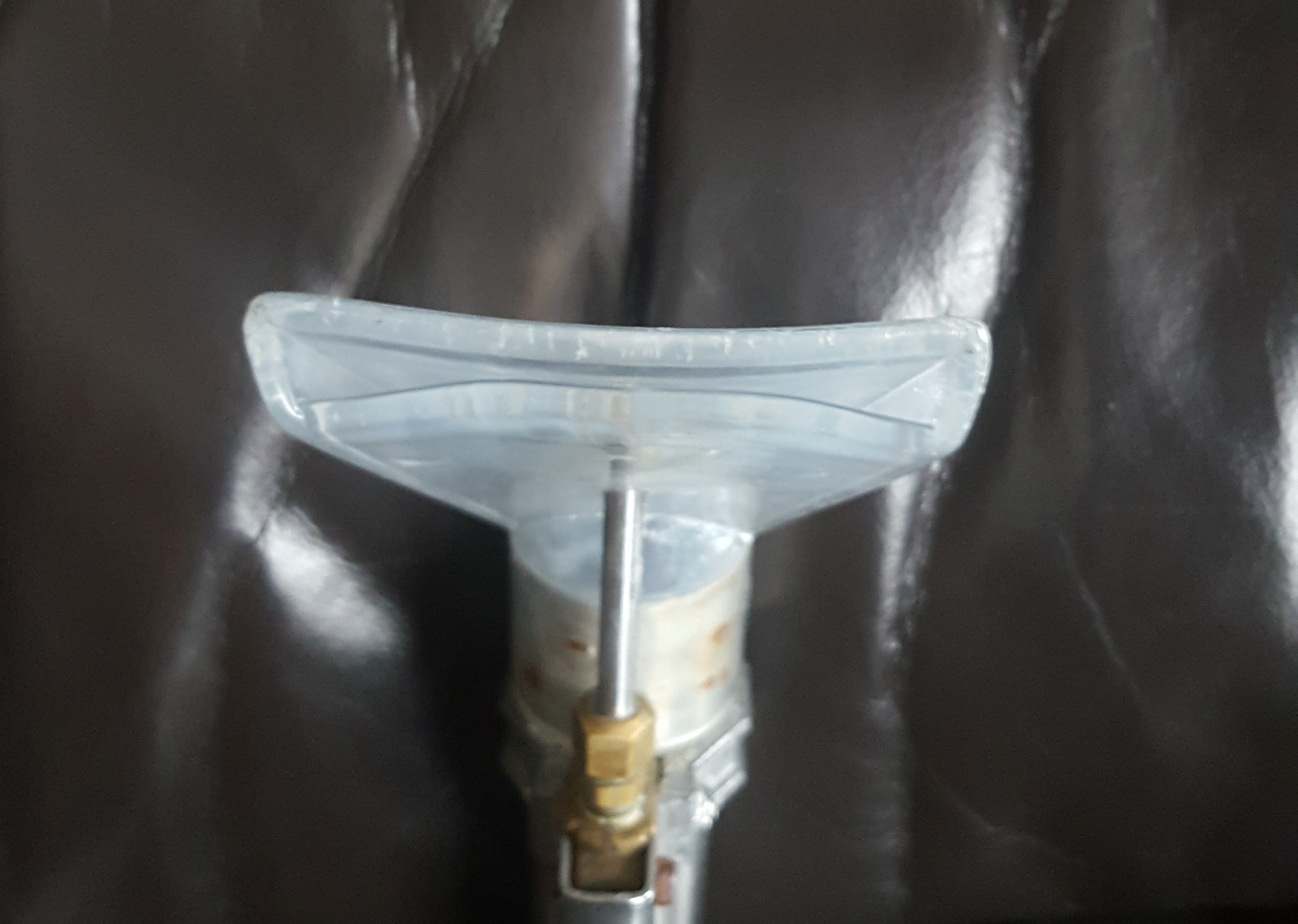

Bob savage touched on it. There are different flow switches for different volumes to control on and off. It comes with a pressure washing high flow switch new because that is the industry the burner comes from and a carpet wand can just barely flow enough to make it go. But an upholstery tool doesn’t, so it actuates a safety and kills pressure. Get a lower flow “flow switch” in it.
