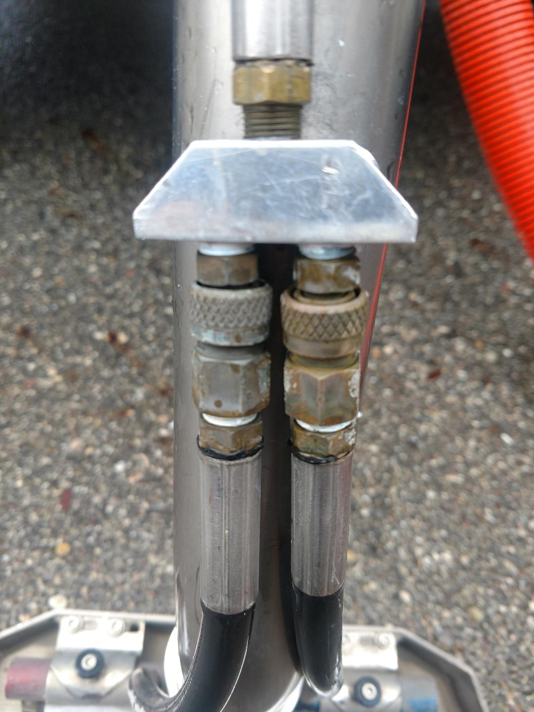

Getting sick of changing out these quick connects at $50 a pop after they start dripping.
What stainless fitting(s) should I use to replace? A union, or is there some kind of male to female fitting that will swivel to thread on?

For all four pieces, yes. I think it might be even more.
11,013
I don't think stainless will make any difference. I would assume the leak is from the O rings, not related to the type of metal.
Maybe you can skip the QC and connect directly to the small manifold.

Whats the advantage of having a QC there?
Is that to make removal of the head faster?

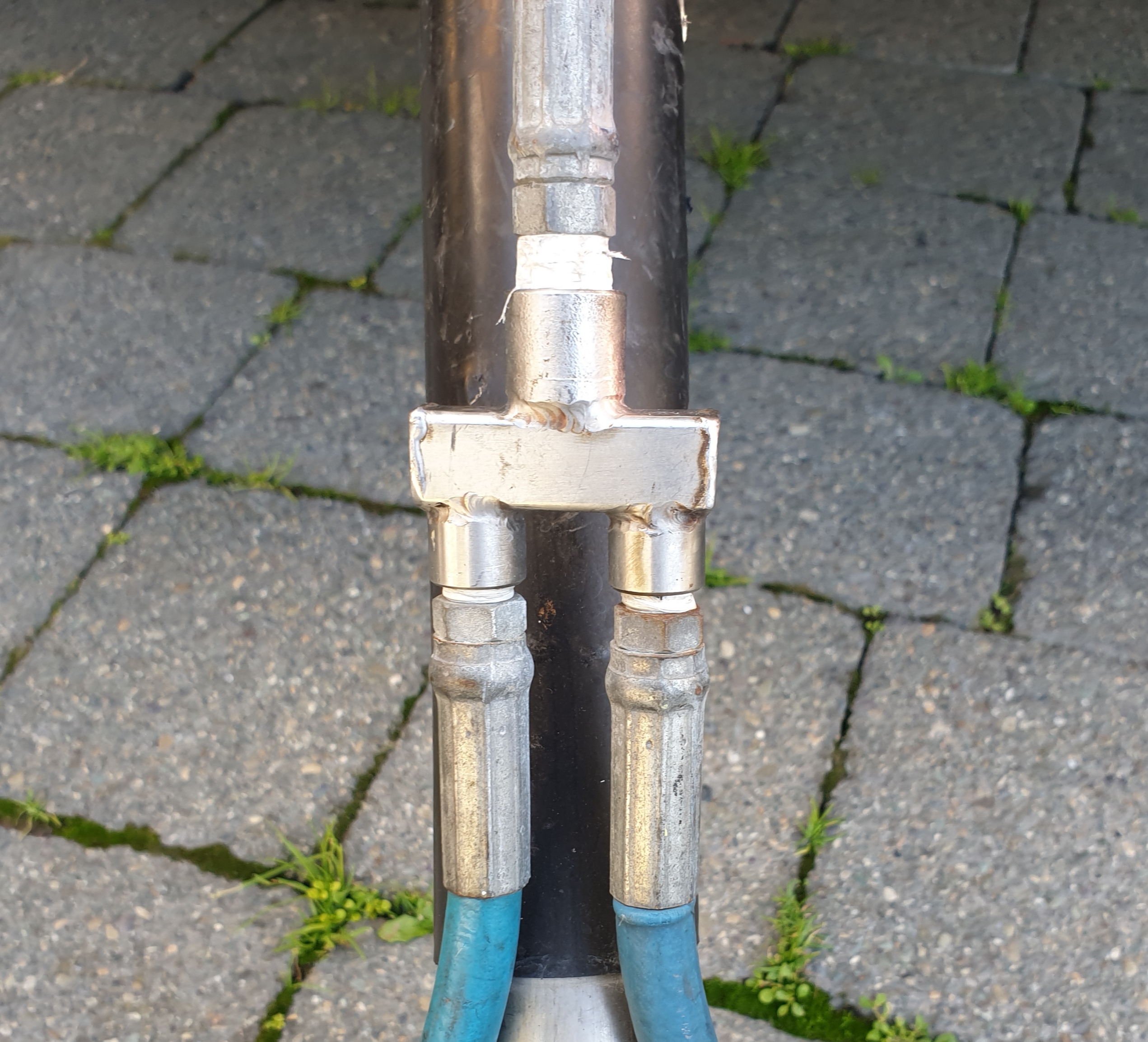

I don't have 1 of the cool kids wands (Tom/Tony dunno lol) but if you felt you needed the QC do it above the manifold?

Never have had any issues with mine either. I haven't sent out a alarming rate of replacements either.
It is hard to figure out why some guys have issues, and others don't, and I'm not picking or pointing fingers at any anvil or anything.
We have had a recent call for rebuild kits for the valve in the last few weeks.
50.00 seems kinda high, all have to check.

The reason for the qd's is to take the stress of the twist out of the lines, if they were not there then the twist would be going right into the manifolds, and probably strip them out....that would be anvils luck, and probably yours too.

That makes sense.
I re-checked and it's more like $30 from Jon Don to replace, not $50, so I guess I was being a little over dramatic.

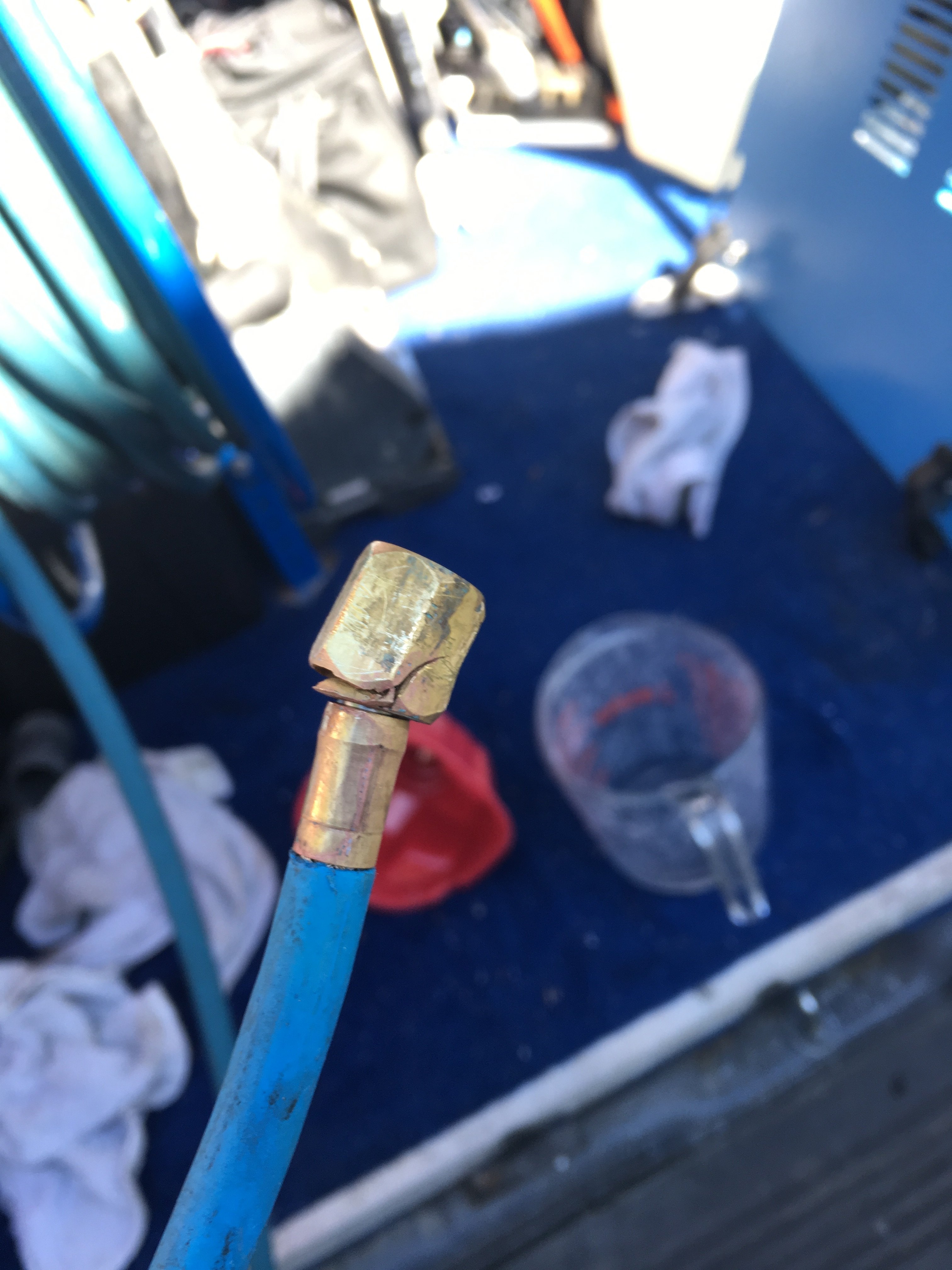

24,146
I blame this on my rinse. I think it weakens the brass. Had this chem injection line crack on me yesterday.

24,146
Yup. The acid rinse eats the brass. I’ve changed out most of my brass on the chem stsyem due to evaporating/disolving brass.
28,277
As far as I'm concerned, acid rinsing is idiotic unless you are doing corrective cleaning. If you really feel you need to counteract the alkalinity of your prespray, use a neutral pH rinse such as prochems axiom extraction detergent. pH is 7.5-8.5, close enough. You will get better cleaning results and if you take a pH meter to the wet carpet 20 minutes after you finish rinsing, it will be close to neutral. Much easier on your equipment.
