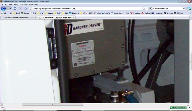

What size blower is this on your 327?
and will we be able to test one @ Vegas?
Bill Bruders
Jan 10, 2009
268
Burlington, WA
Bill Bruders
its a Gardner Denver (Sutorbuilt) 406 trilobe plumbed 2.5 all the way. Yes we will have it plus a 3rd model in the line with more performance,

Bill...i briefly thought about going wit a tri-lobe blower recently...but after thinking it over for a while decided that an EXTRA lobe taking up space inside the blower would NOT be conducive to more air volume....
Was i wrong....convince me?
Bill Bruders
Jan 10, 2009
268
Burlington, WA
Bill Bruders
Bob
There are several differences between Bilobe and trilobe blowers although they vary by manufacturer. So I will focus on the Gardner Denver (Sutorbilt) brand
1. From a vacuum performance persepective trilobes go approximatlely 2 inches deeper into vacuum than their bilobe counterparts at the same HP and torque levels. So they are more efficient.
2. A trilobe blower creates less vibration which reduces stress on the truckmount frame and other components
3. The reduction in vibration reduces noise
4. The shaft size of the main drives are larger and handle torsional shock between the motor and blower far better.
5. The oil lubrication systems on a trilobe are cleaner than the bilobe grease type and provode better heat distribution as well as overall lubrication
6. Finally trilobe blowers use ring seals on the lubrication system rather than o-rings
Of course these differences come with a higher cost but all in all we believe they are worth it. When Mike Roden was at Prochem he worked on the engineering team along with engineers from blower manufactures that developed the trilobe design for the cleaning industry just as an FYI.
