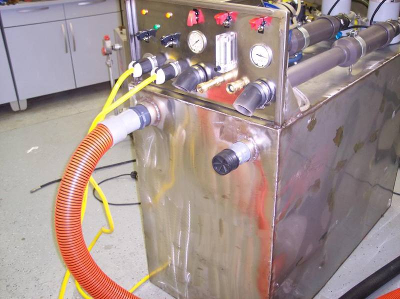

day 6 and ODIN fliped! the switches on the 180 GALLON BEAST
May 12, 2007
2,242
Rambo
162

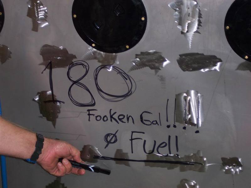

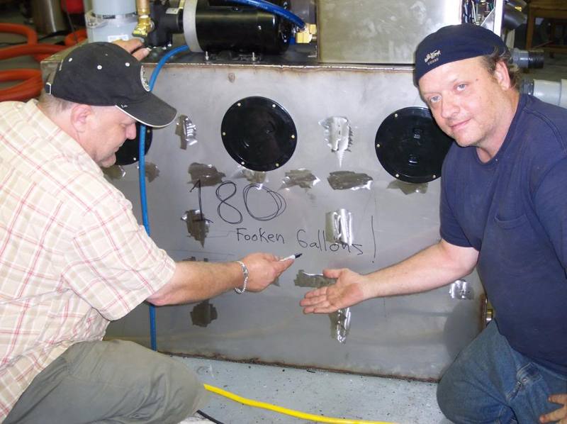

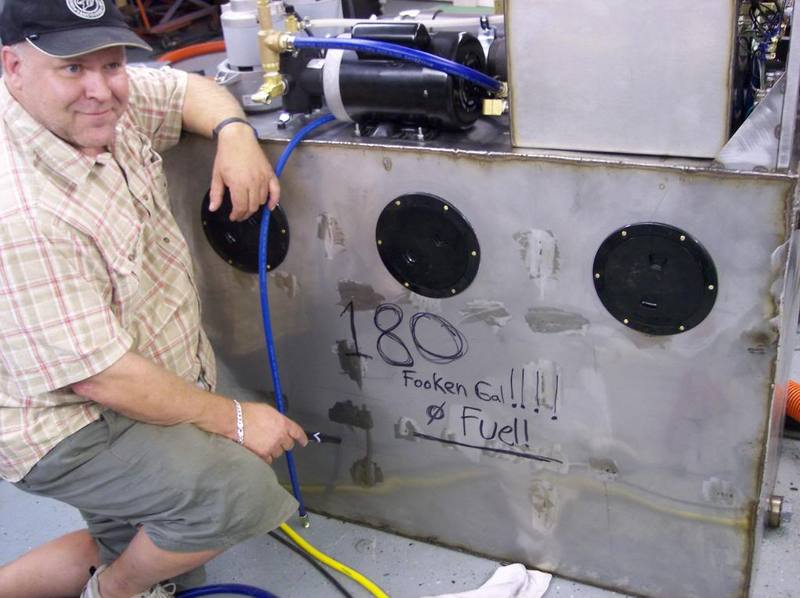

Awesome! No Fuel! 180 gal. waste tank, work all day w/o dumping. Built in the USA by two Giants in our Industry.

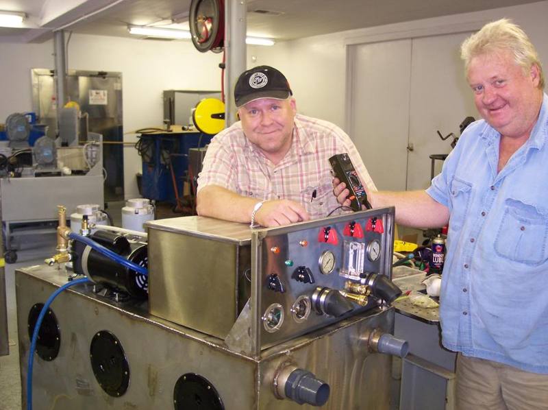

Where in the heck do you plug it in?
It looks like two 220 volt plugins.
Your running one to the stove and one to the dryer?
What do you do if they have a gas range?
What are the specs?

Nice job on the electric TM.
One question I do have is the total amp draw ?
I am guessing 13 each for the vacs and another 10 amps for the pump motor for a total of 36 without the inline booster.
Any two of those is over 20 amps. Do you plan to tie in to 230 VAC for power ??
Larry
TimP
May 19, 2007
4,055
You know brick layers tie into 220 to run their saws all the time. They usually get it from the AC.....however I don't know if it is wise to have to do this in a home.....yes mam I need to cut off your ac while I work cause I get my power from it...
Anyway many people don't have electric dryers or ranges. So running 220 probably isn't the most user friendly for a carpet cleaner. However finding multiple circuits in a house shouldn't be too hard. You just need some thick 12 guage cords.
You know you have a dedicated circuit to the washing machine.....one to the refrigerator...and usually one for the kitchen.....and i'm sure you can find one on the rest of the plugs in the house....just taking the time to run all the extension cords....what a pain. You can always bring a generator but that aint saving then......you know it is kind of hard around here just to find a modern 3 prong 110 recepticle in many houses.
And btw all my regular plugs run 20 amp breakers no 15 amps in my home.....

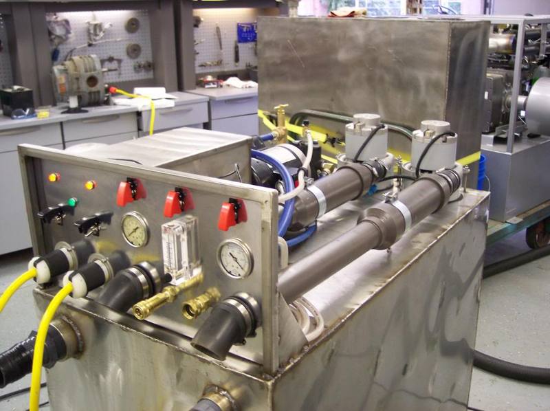

For a wild stab,
One light is for when the two cords are plugged into two seperate circuits.
If I remember correctly, the Hypro pump only requires a 3/4 hp motor @ 5-6 amps. So, with the two 15-amp circuits combined, you can run both vac motors and the pump off of the two cords.
Its going to be interesting to see that unit run w/heat, vac booster and the Greenhorn wand and see what it can really do.

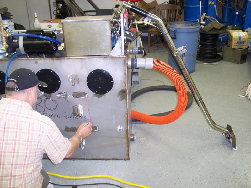

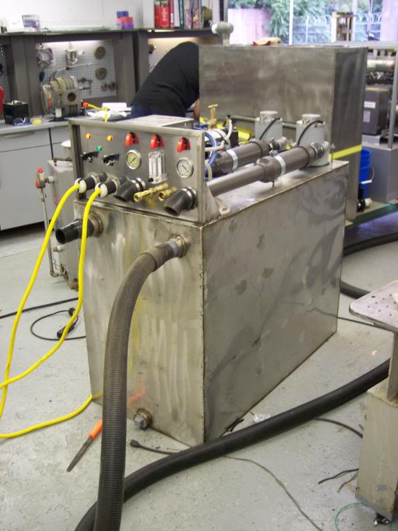

How many cords need to be plugged in? What do the end of the cords look like? I can not see them on the pic.
Golden Boy

Where is the 2.5 inch vac hose?
