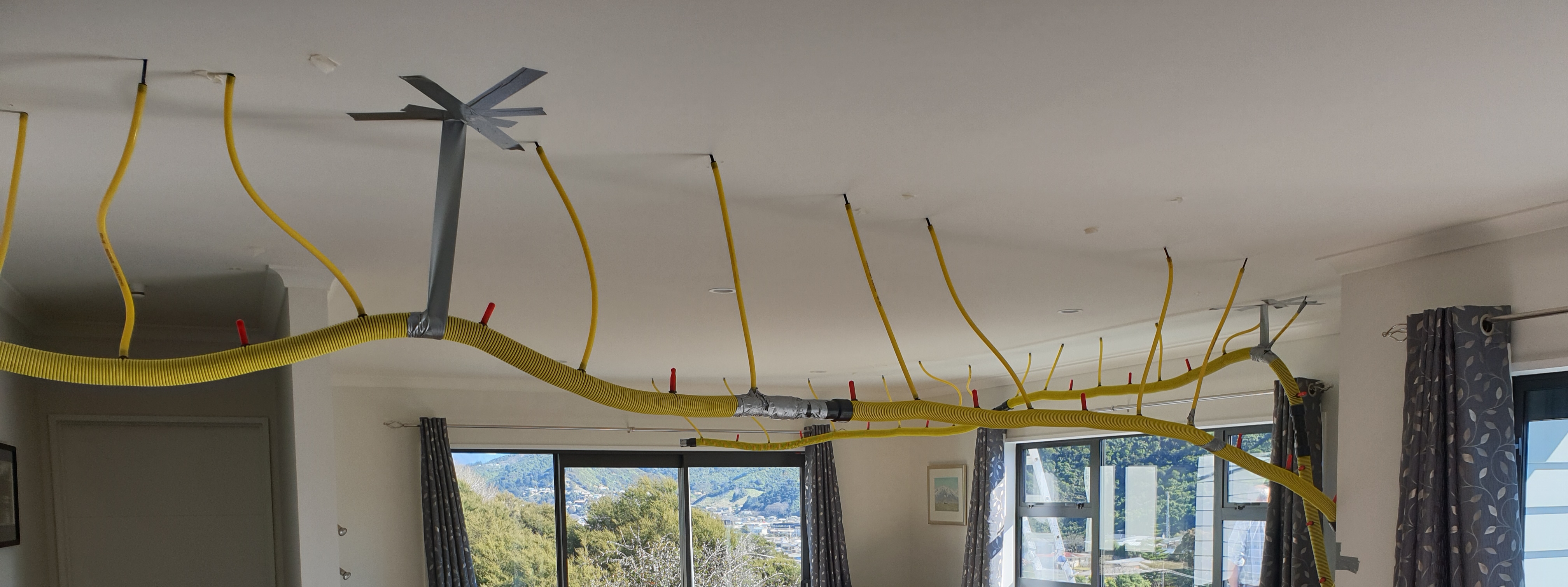

Not personally what I would want to see hanging from my ceiling in my 6 month old home.
But they are paying for my creativity 😉

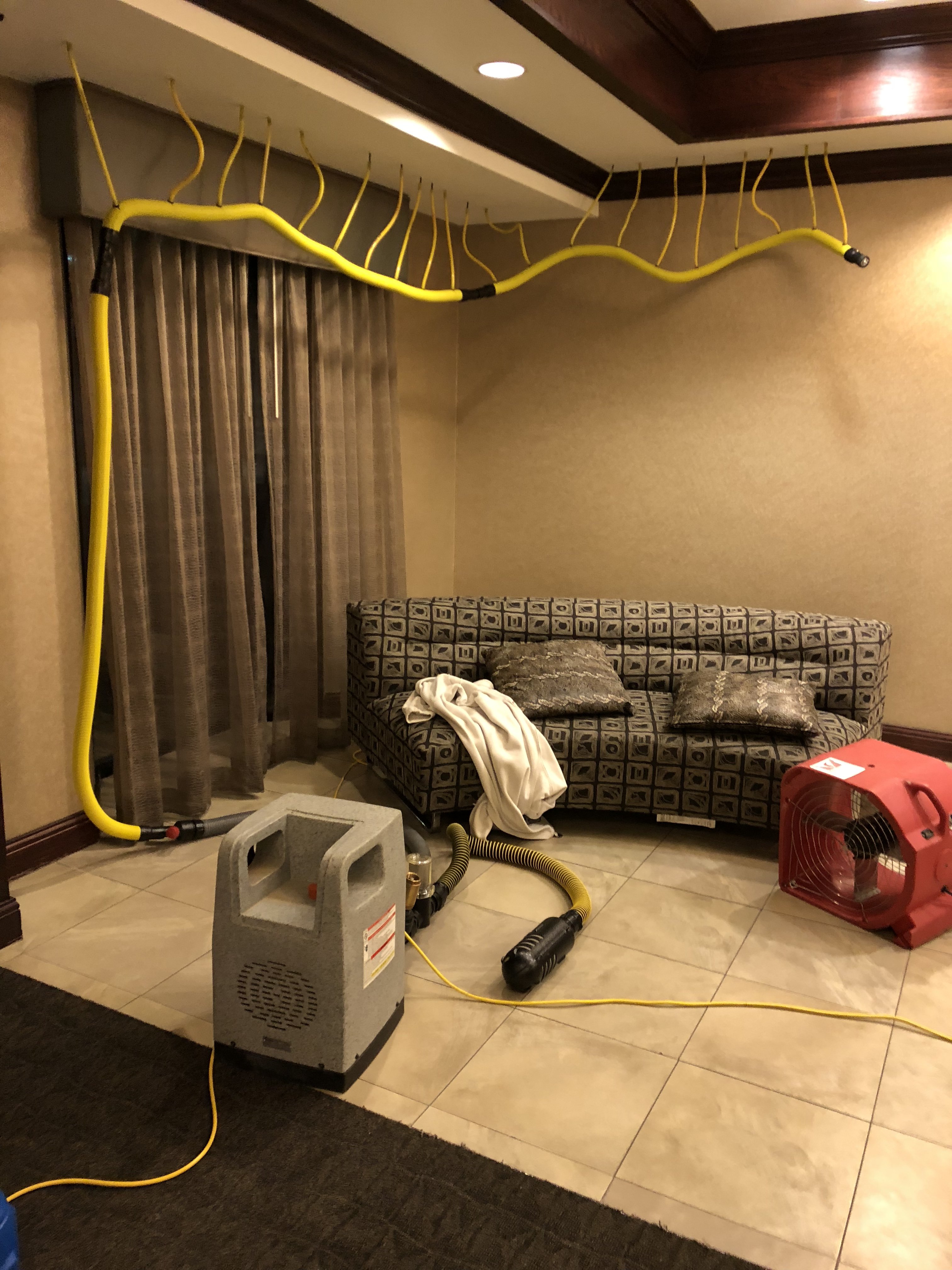

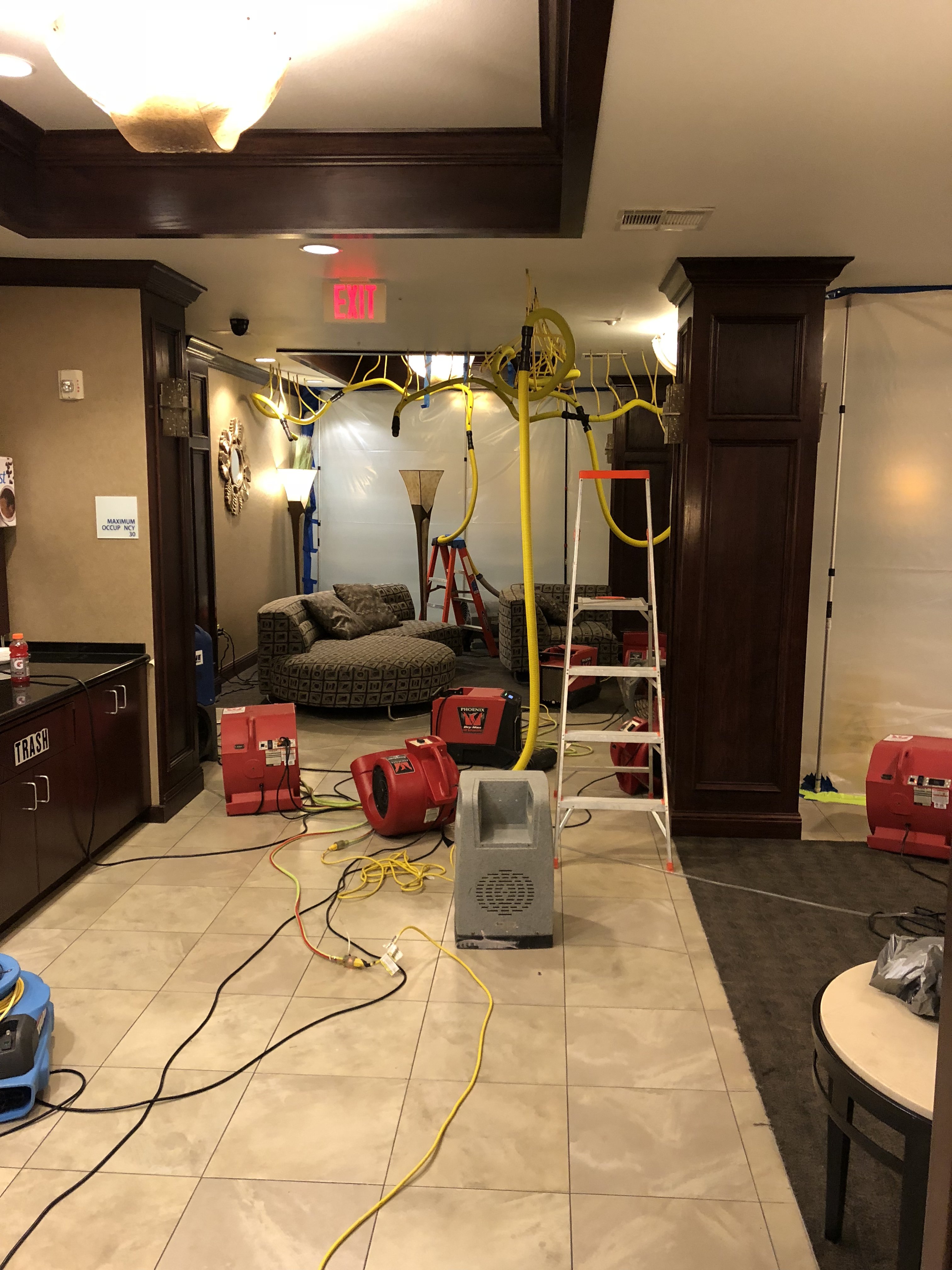

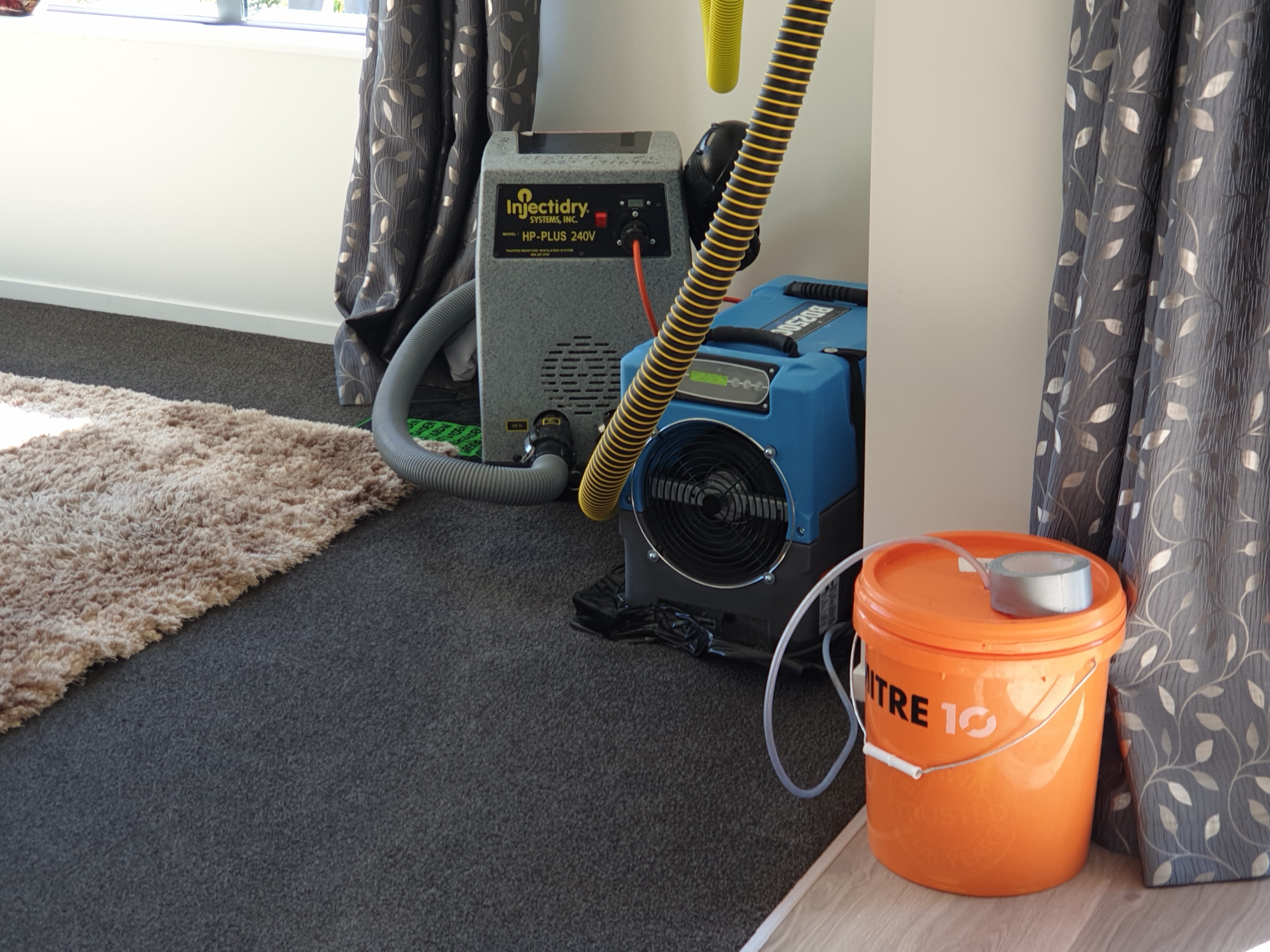

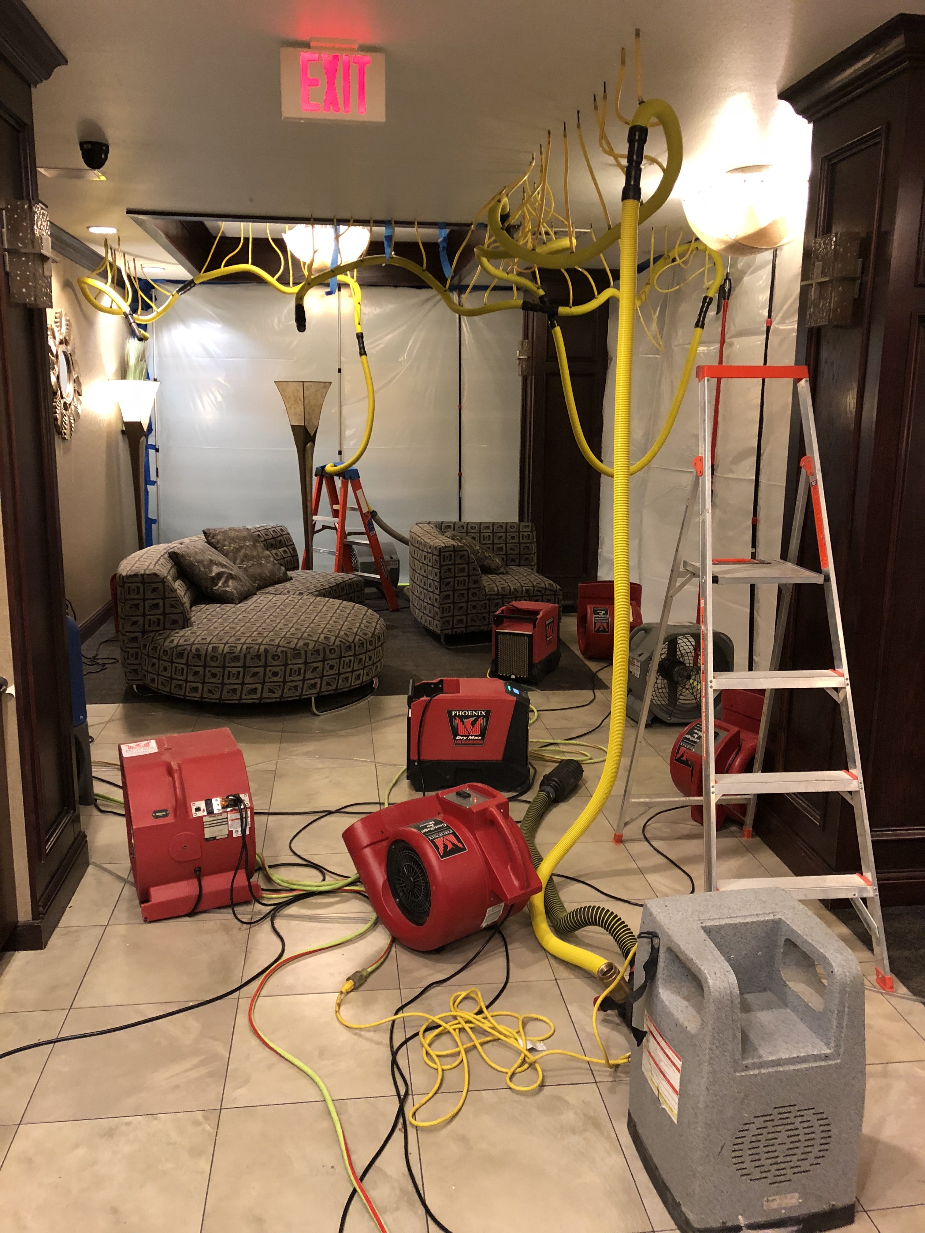

Nice pictures! I am a big fan of Injectidry. You should consider getting a water separator to protect your expensive power head. The separator is about $150.
I also invested in the in line HEPA filter ($425) and was surprised to see the amount of crud
that had been going into my power head.
Fort Worth , Texas
I use hepa and separator if I am pulling(negative air) but if I am pushing and area is clean then we don’t use them.
