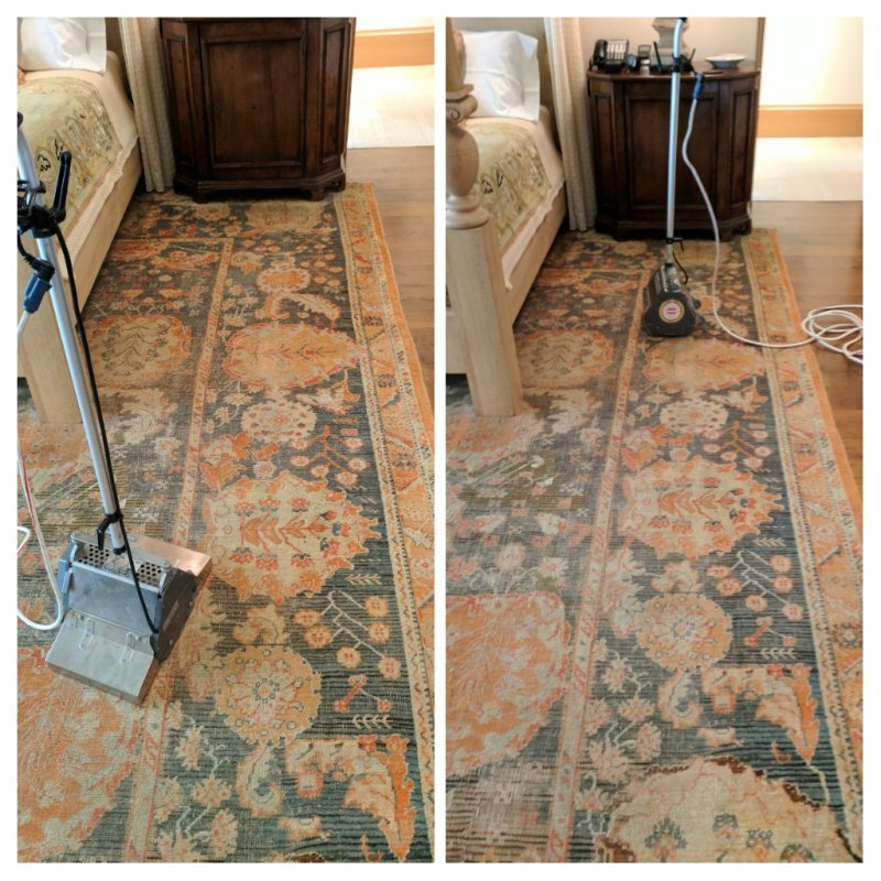

I've done a handful and saw the Host magic at the MF skating rink and of course seen Will's pics but golly gosh darn it, I'm sold now.
Potential curlers, bleeders and thin rugs will now all get comPOUNDED.
Risk free, easy and they love it.
After and before, brighter and smelling clean. The excess powder was funked.
I can't tell the difference.

Opens up a lot of possibilities for customers with delicate bleeders srinkers or otherwise that they won't send out due to how sensitive they are or have large furniture on top or high cost or a number of other factors what you can't see in the picture is still there definite improvement and the happy customer.. we did two very large rugs for probably $2,500 in a couple hours

Not so much ?
Add an Encap and or do it twice.
The problem is that some of these rugs can't tolerate a scrubbing with a crb even with the wool brushes. I have 2 $79,000 rugs that I am tempted to use it in but I've seen how the pile distorts am still a little afraid. I will have to get the customer to sign off first.

When we did rugs in our cleaning cleaning company, we used soft brushes on CRBs with powder if we couldn't get them out of the house and they seemed to have unstable dyes or dimensions.
It wasn't what we wanted to do, but it was safer than HWE on location and problems. It's difficult to fix shrinkage and dye bleeding on location.
