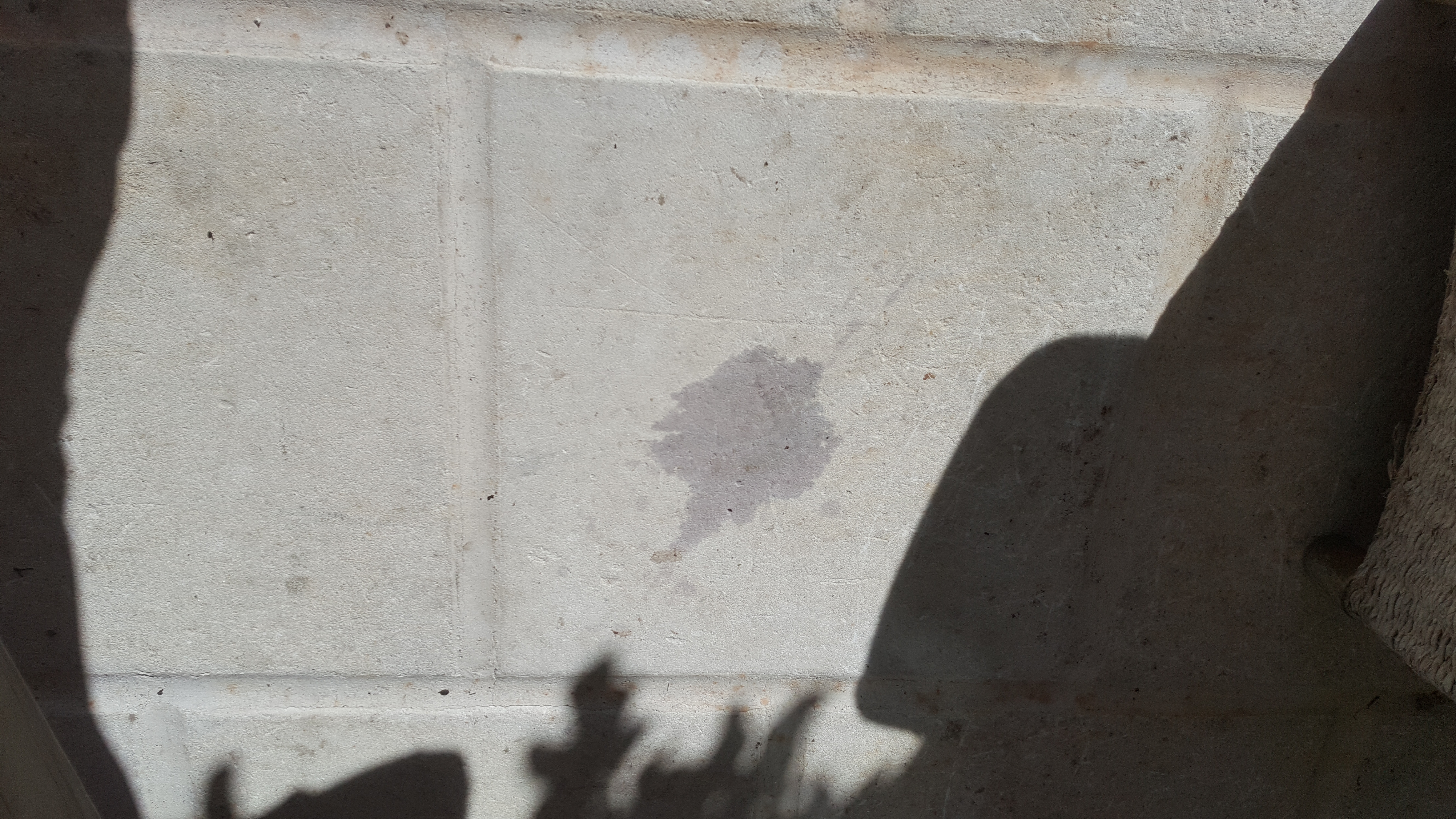

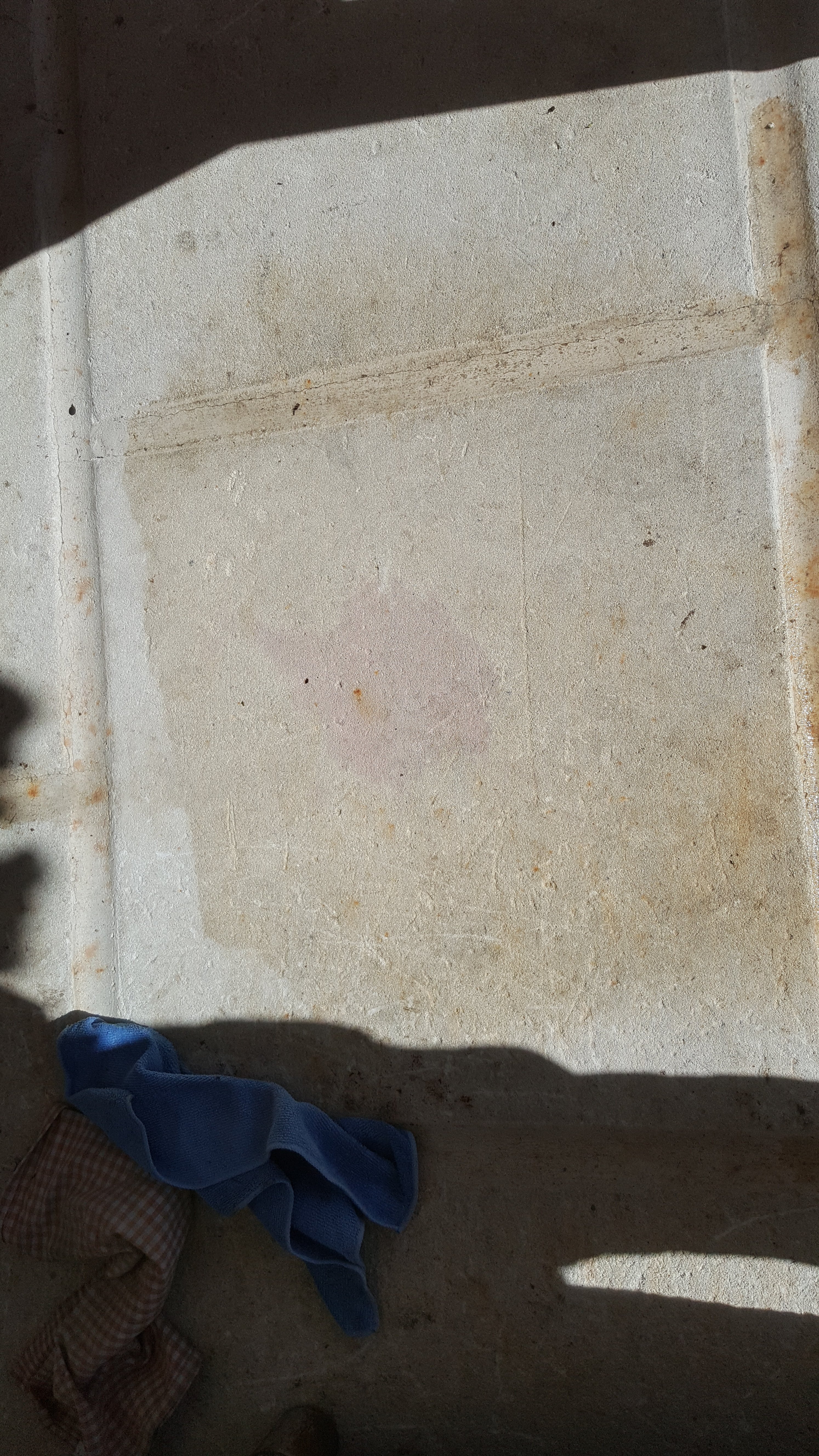

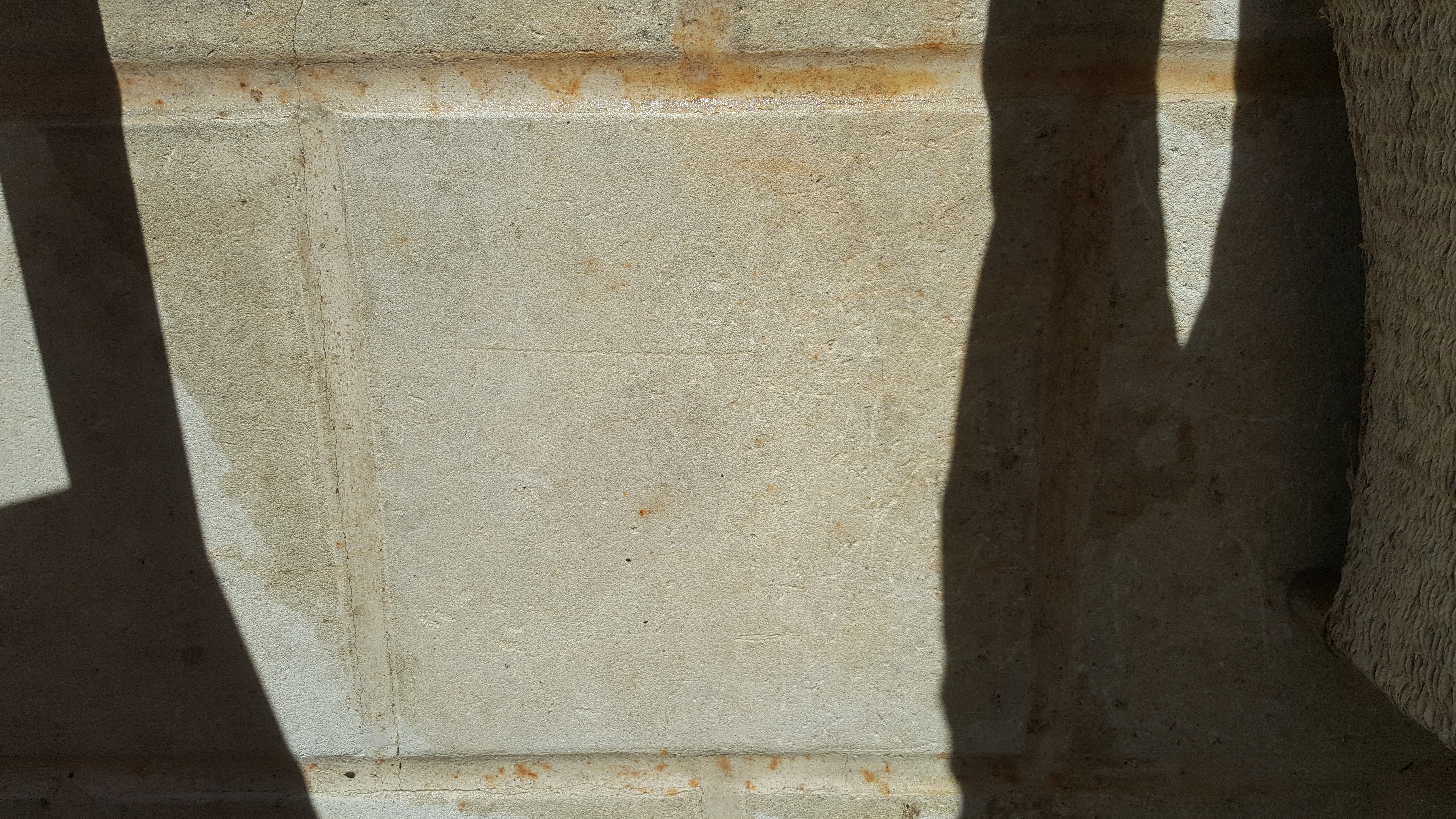

Limestone with red wine on an outside deck I did today
Before I started
13,371
Oil dry and foot scrub.
But I'm a hack.
Just spin it and then wand it just water. Touch up spots after the spinner and then wand it.
