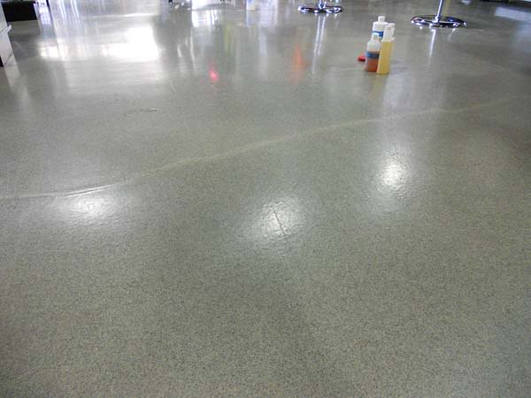

I looked at a commercial place today with sheet vinyl. It's got tire marks and scuffs.
I didn't have my op on hand to do a demo but I think this may work fine. Is there a cleaner that I can use that doesn't require rinsing?.

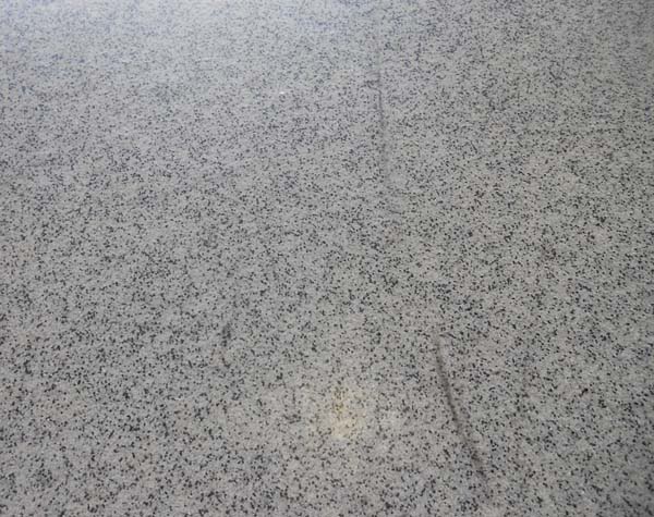

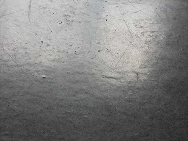

I did a little test today. No rinse stuff is not going to cut it for the tiremarks. It will need scrub and extract.
Questions,
Does anyone know this material?. I could only find one seam that was sorta welded together but could not find the width.
Is there something I can seal this with that will hide the scratches but keep maintenance to a minimum?.
The scratches in the pic are not from a topical.

Its either an Armstrong or Forbo Commercial sheet flooring.
Might be medintech
http://www.armstrong.com/commflooringna ... m_id=92489
Though I'm curious.. did you try a floor stripper by chance?
http://www.armstrong.com/commflooringna ... 7sZ1z141xp
I wonder if someone did not try to wax this thing already.. Your picture look like some texture is showing through.
I think I'm looking to hard and its prolly closer to the medintech product.
Possible Forbo types:
http://www.forboflooringna.com/DesktopM ... 454&bid=-1
(I'm thinking its Forbo over Armstrong product. )

David, from the looks of it it does look like the first link you posted. I did try a stripper which is what took off the tiremarks. I did put a few drops of it on an area for a few minutes. After wipping it slightly hazed the factory sealer so the lino safe strip sounds like the thing to try on it. BTW, the few drops of stripper I tested was straight without dilution. Home depot stripper.
It does look like the scratches are from the original factory top coat. I'll give them a cleaning quote. I've already told them that applying any type of floor finish will require more maintenance.
