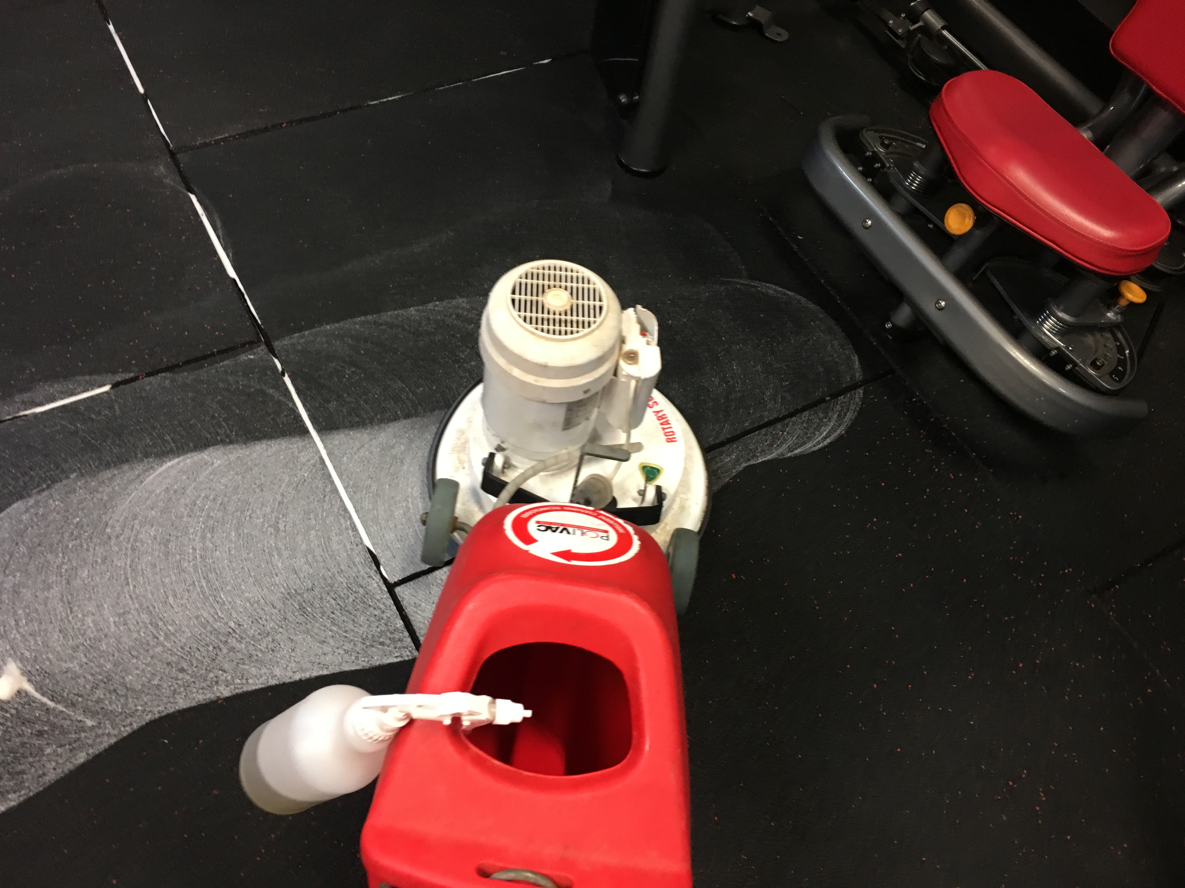

Better idea: move to Tampa and drop big yellow off for service.
Best idea: sell it on craigslist and buy a VIBE ! Makes the cimex a big yellow dinosaur that needs to be extinct.
