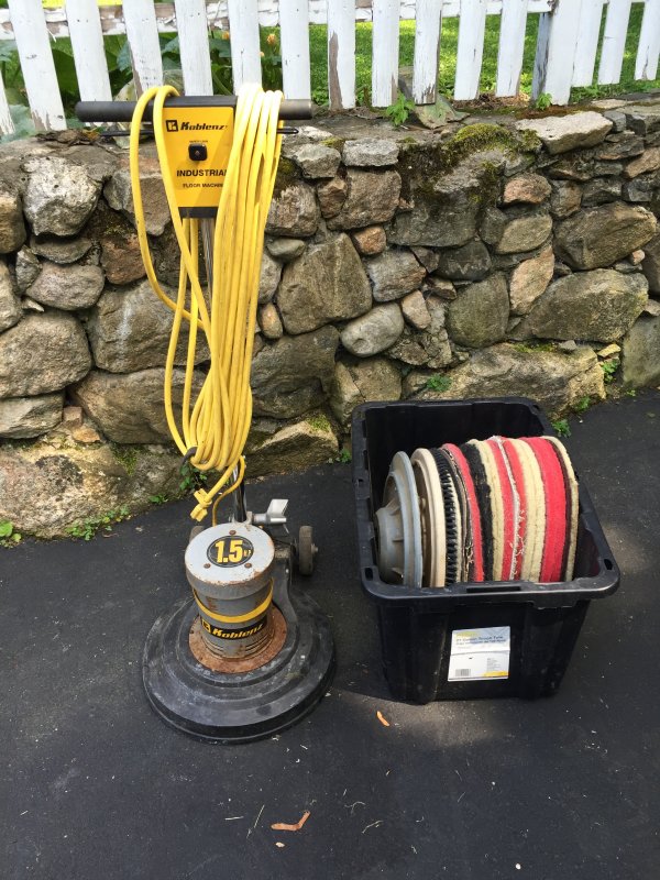

Your cymex looks different then mine mine do not have the plastic cover .
Is that a upgrade ?
I know your messing with me the nice gentlemen told me I could tell it’s a real cymex because if that there yellow
so anyways I barelygave him 3k for it what a moron
