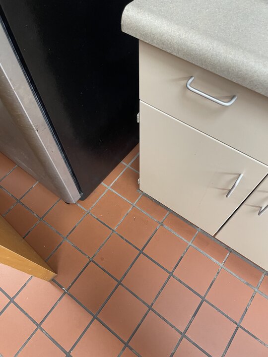

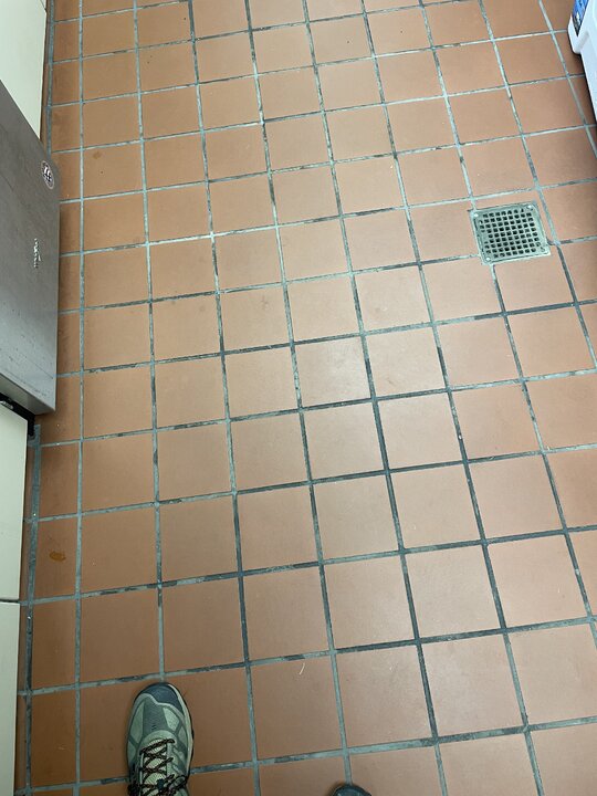

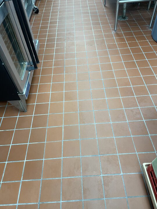

Several years ago I tried to clean a floor just like this at another church with dismal results. Now I have this floor another church is wanting me to clean. I’m asking not for tool advice but I’m looking for chemical advice on what to use.

But if you want to give it a shot using extreme alkaline like Sager tsunami with a lot of agitation and dwell time but low pressure maybe 6 00 or so through your two jet wand..
Then use a strong acid to brighten it up such as prochems or sagers or whoever else's just mix it couldn't strong..
Then put down as many fans as you got and watch the efflorescence occur which is a given it'll happen in random spots in the grout as well as some areas on the tile itself let it dry for a few days then come back and try and brush it all off or pad clean it but if you get it wet again it's going to start all over
Just tell them this is all going to happen so there's no surprises or finger pointing it's just a fact of life when you're cleaning terracotta clay tiles that are super absorbent and get over mopped virtually every night..

What Mike said....less his earlier unkindness.
Can I use an acid cleaner on this @Jim Pemberton ?
Acids can help after your high pH cleaner removes grease and other soils. They will help to brighten the grout as they "etch"/remove a microlayer of the grout itself, leaving "new" grout showing. But alone, acid treatments are not themselves good cleaners of the type(s) of soils you routinely find here.
The efflorescence of which Mike speaks is an annoying and probably expected problem on these types of floors, so forewarn them.

I've had great results with Rotovac's Oxygen prespray with hot hot water in a mop bucket for dissolving the grease.. I've used a 16" spinner with self-recovery and a pressure washer 3,500psi.. Then a few months later I used the same solution but with the hot water 800psi with TM recovery.. This was for grease..
Are you asking about the salts in the grout lines?

I really don’t know how much of the black soil in the grout lines is grease or if it’s just 30 years of mopping. I ordered a case of Saiger’s Tsunami and Vengeance.

I think the kitchen is split between an older and newer section. The reason I say this is because the back half has lots of damaged grout in it. This damaged grout didn’t clean up very well. I had a great looking white grout with random areas of black patches left in it. I steamed these areas a second time and then acid treated them to no avail. The soiled looking areas are only where the grout has been chipped away. I have no idea what to do about these areas. I’ll see on Monday what they say.
This grout turns dark when it’s wet. It looks dirty until it’s dry. My thoughts on this are that the damaged, chipped, grout allows penetration of the water into the sud straight and takes a lot longer to dry. I’m hoping it will dry out completely over the weekend and look fine by Monday.
Oh, another possibility is they’ve had those areas regrouted at some point and the tile “professional” matched the grout to the dirty grout.
