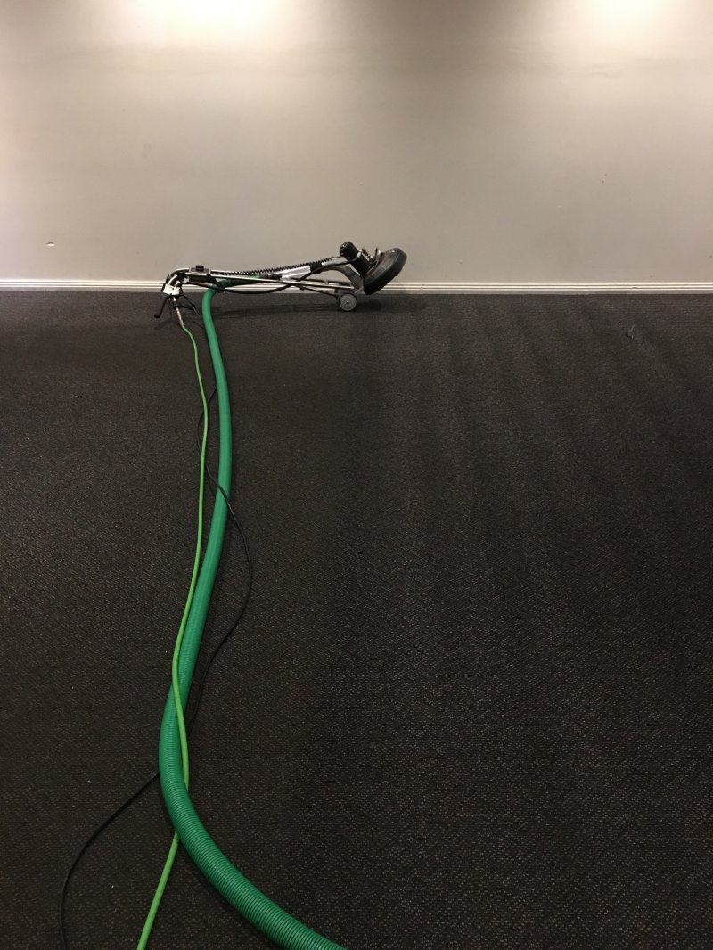

Based on the input and what I have to work with I will go back with just the wand, using Attack again and bring some fans. Making sure my suction is good and filters are freshly cleaned. I guess I am too enamored with the Rotovac 360i.
I doubt she will let me use the 175. I will fix this issue, get more practice on other jobs using encap method, and maybe try it again in 3 months with her.
Thanks for all the input!
I don't think it's the 360i.
I have a Nautilus MX3-500H porty and a vac booster and I do a Chinese annually. Used Blitz this year.
Just hit it again. Clean in the opposit direction. Dry pass.

Uneven floors in this video...I also have a lot of videos using different tools for these jobs. Zipper SS Super Spinner king on the super nasty...but again without pics, not sure what you have going...and the Super Spinner, you need a large enough truckmount to handle it...

Most Chinese restaurants that are getting cleaned every 3 months are being neglected.
It's not nearly often enough.
Once a month contract is where I'd start.
They won't like the price (probably double what you charged) and will be looking for someone else.
You got the job BECAUSE of the inexperience and low price.
Fix both of those, and the Chinese Restaurants won't even call you!

I was a little slow on the uptake about the alkaline rinse- it's simply putting carpet cleaning solution into the fresh water rinse.
Anyway, I appreciate the feedback and y'all have restored my confidence to tackle solving this one.
I anticipate that with extra dry passes and the fans it will look great.
Next time I will use the 175 machine after hwe.

Pre-sprayed just the traffic areas with ReleaseIt DS and used microfibre pad with 175 machine. It looked great at that point.
Your answer is right in front of you.
Although you need to figure out what caused it to be left too wet, it may be better to just pad it again with some more DS and MF pads, place some fans and be done with it, instead of wetting it again and risking more wicking and possibly loosing the account.
Make sure their HVAC system stays on overnight with fan setting on "ON" not "AUTO".
