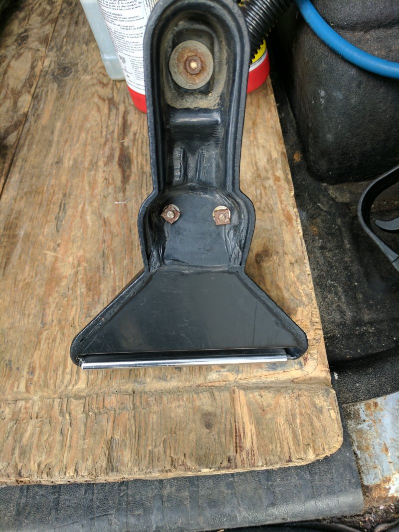

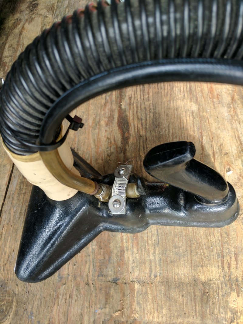

Ron Tony uph tool?
What a mess, how did that happen?
Ron Toney taught an upholstery course here in the mid 90's and demonstrated his unique upholstery tool. Might look a little crude but it is the best tool I have ever had for large flat surfaces. Still using the original valve. I called the lady with the ink this morning and it looks great with the exception of the area under the heater that Dan noticed but you can't see it from a standing position so she's not worried about it. Most ink removal jobs, I find I still have to use an oxidizer at the end.
