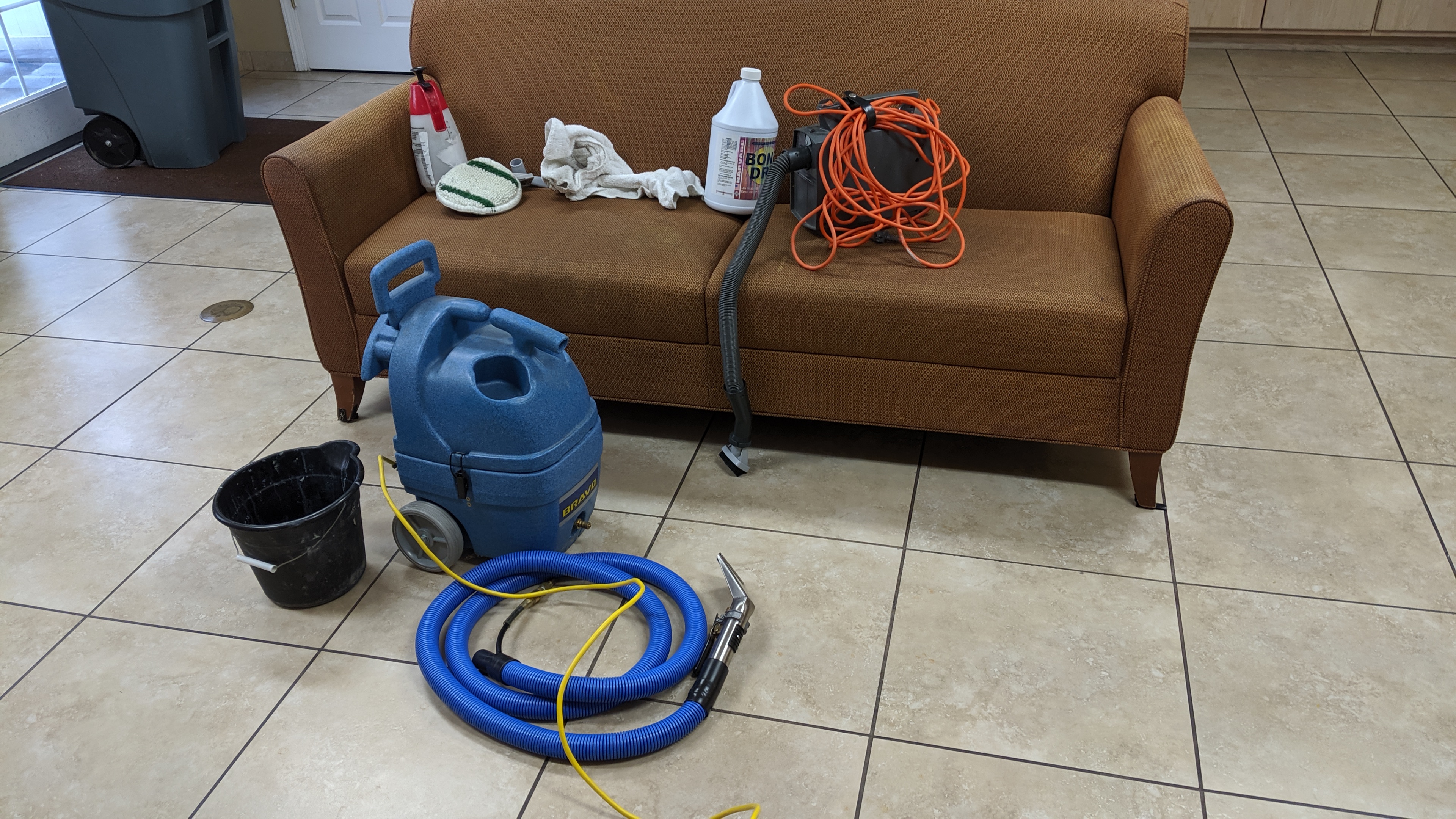

Can you spot the issue?

Vac port, and nipple for solution line is not mounted in same area...
Which is why it doesn’t come with a hide-a-hose...

You need a bigger machine. That’s too small for a big man like you.
And other reasons.

The pump in the Edic is not powerful enough to drive any of the 3 tools mentioned... it doesn’t drive enough solution to the tool head to be effective....
117,333
well thats an issue for sure but not what you guys are not catching...
of the three tools I tried, the RVSD allowed for the most water to "interact" with the fabric, as it's jets are furthest from the vacuum port.

nothing hackey about the Hoover PortaPower
I have one similar from Oreck. I like em for exactly what you are using it for. If I was doing production commercial upholstery I would use my proteam backpack vac due to comfort and more power. but those lil vac setups are plenty of power for what you are using it for.
