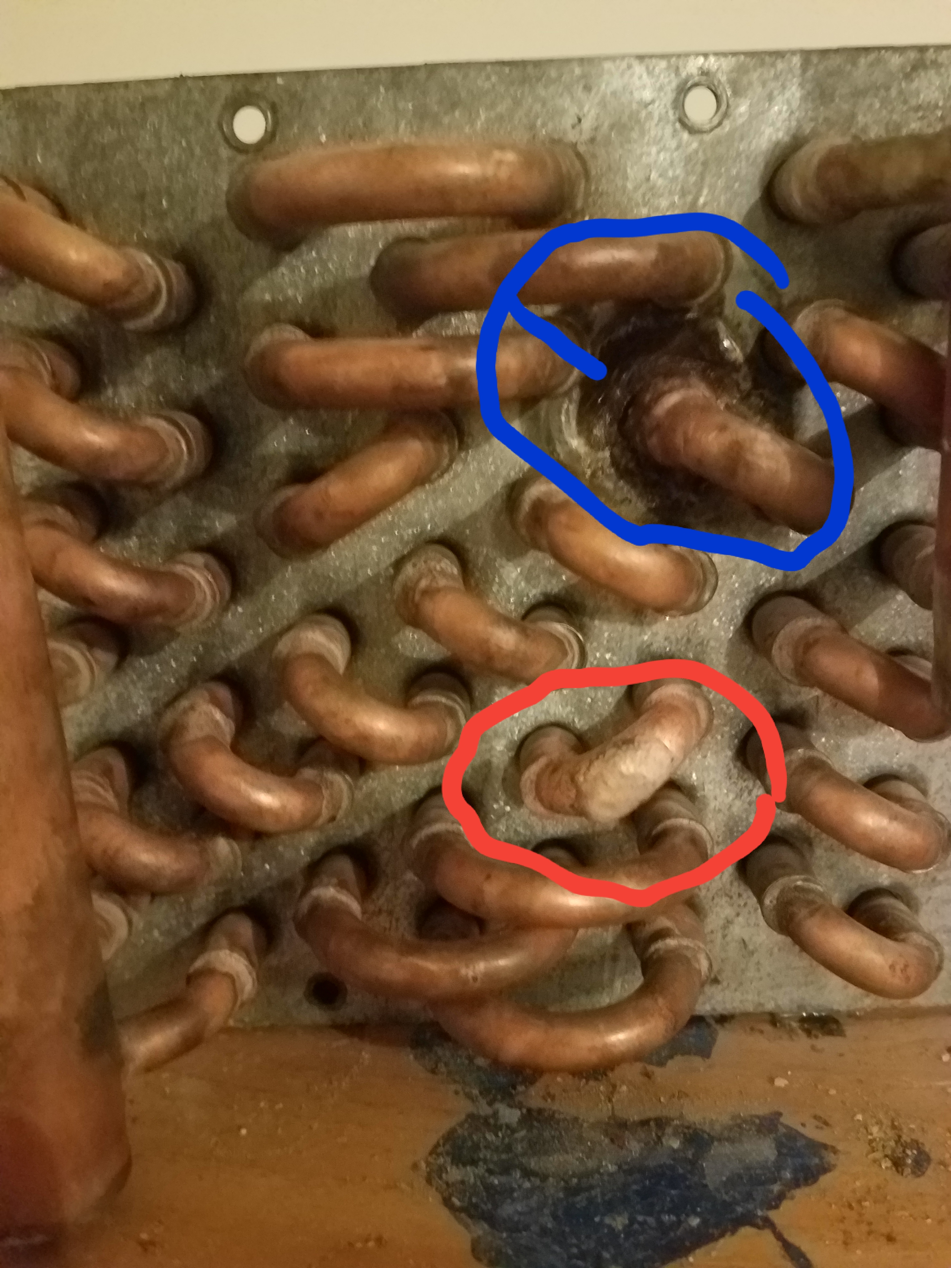

All back together but... it's still leaking in a spot. It's still building pretty good heat. I've got a job tomorrow, can I still run with the leak or is it going to be a blow out.

Picture and circle where it is leaking on picture please.
The heat exchanger is upside down from my very 1st post but the circle in Red is the original hole I posted and isn't leaking anymore. But the circle in blue is the new pin hole leak. You can see they did try to do a repair there.

I hope you didn’t pay that much for that repair.
As it has a very high percentage of failure in the future.
Those fittings needs to be ordered and switched out to make a permanent repair.
That is more of a tempo repair they performed.

It looks like those guys just made a mess. How much does a new heat exchanger cost? If you already have a little giant, then yes, hook it up until this problem gets fixed.
If you don't have one, and funds are tight, bypass this heat exchanger and hook up to your customer's hot water until this problem gets fixed. Don't let it slow your work down. If you're still working, it'll be easier to fix it the right way. I'm worried that those guys made more problems, trying to bandaid it
if they pressure tested it, I'm not sure how they could of missed that :headscratch:
....unless reinstalled, then pressure and vibration opened it
(my original concern of stressed/weak areas due to a hard freeze)
as Matt mentioned, you should be able to by-pass the unit with hi-pressure hose.
That allows you to limp thru jobs in the interim by using whatever hot water in available, as Matt said
Using hot water from custy is a big PITA though unless it's an empty...and water to the wand will be luke warm "at best'
Unless it's a big job....then you use up what's in hot water tank and run cold
(and it's SUCKS to rinse pre-spray with cold water)
Little doubt you could retro a propane heater
but if you have to buy a Little Giant, I'd bite the bullet and just get another HX'er
consider this;
add the price of 4ht, hardware to plumb and propane tank(s) it might be worth spending a little more to eliminate all the PITA factor (and lose of van floor space) to convert .
an propane heat is a PITA in general with tank filling and wind flame-outs
When a direct replacement HX will have you up an running again in an hour or two
You have a "real" job...and a good paying one .
No need to hillbilly yo-chit
Take that HX back to the shop that soldered it.
Ask if pressure tested and at what PSI.
Make them aware of what PSI they're run at
go from there
and start rolling your change for a new HX

Just brought it back in. They said it's warrantied for 30 days. They said it should be done later today.
Cleaning Professional
Ask if they can order the fittings and replace the damaged ones not just patch them.
Also ask up to what psi they are able to test exchanger.

I got the heat exchanger back and it's installed and running with no leaks. They said they could replace end fittings if I wanted. I opted to just have them braze it for now. They said the leak was a tube that was splitting on the inside. They fixed for free. I found another heat exchanger from a guy and I'm going to have that one totally gone through and tested so I have a back up. Thanks for everyone input!
