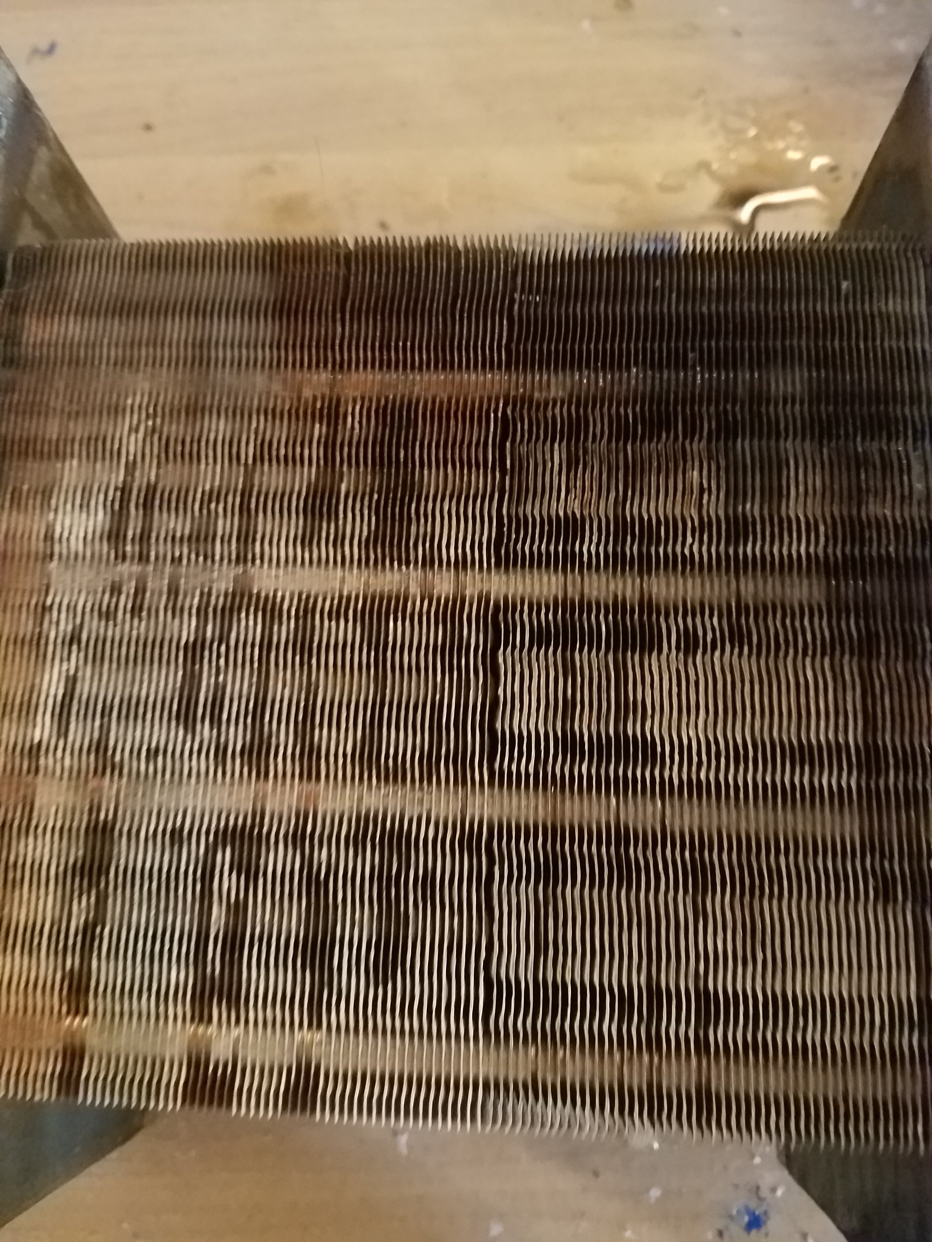

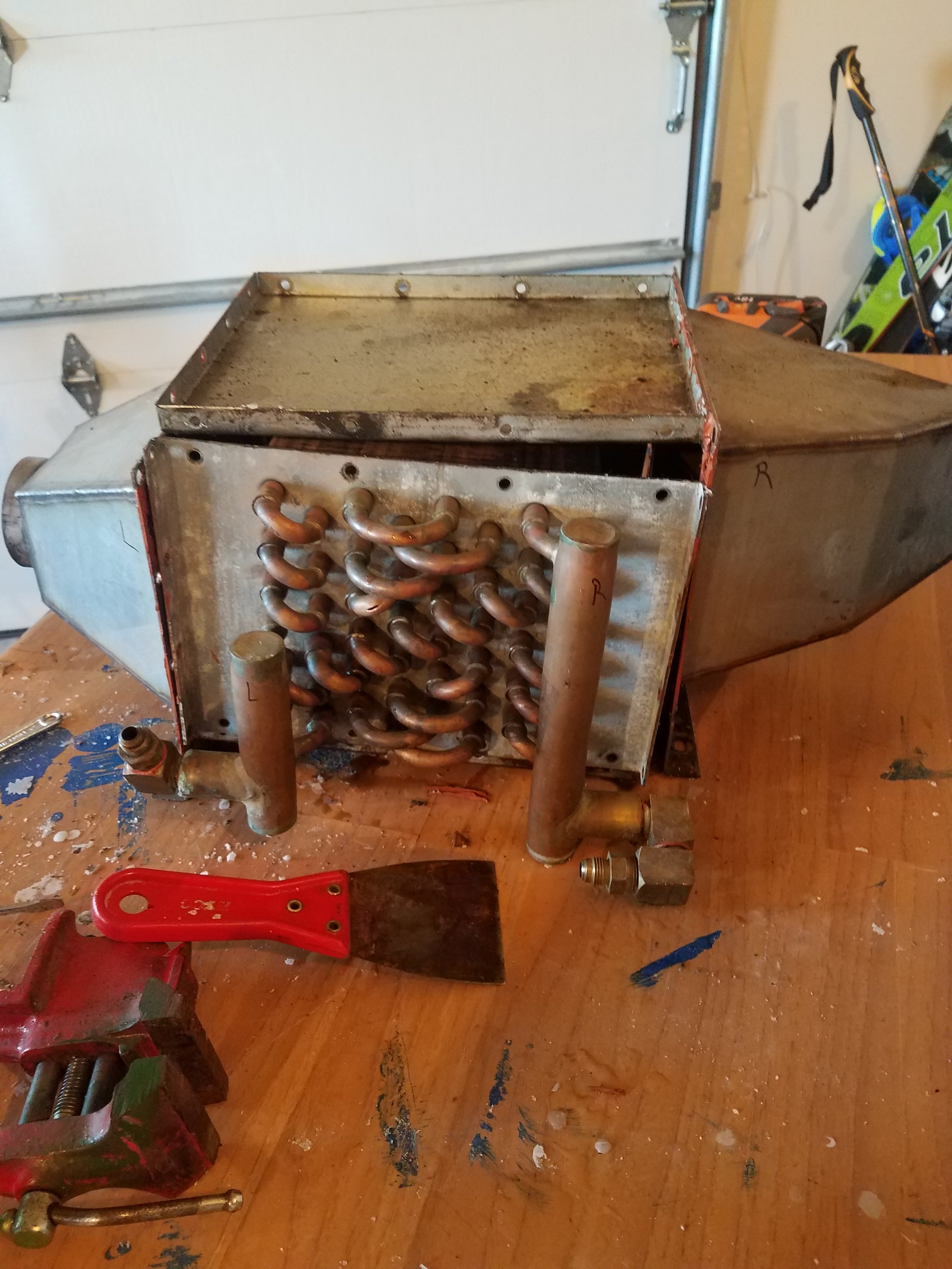

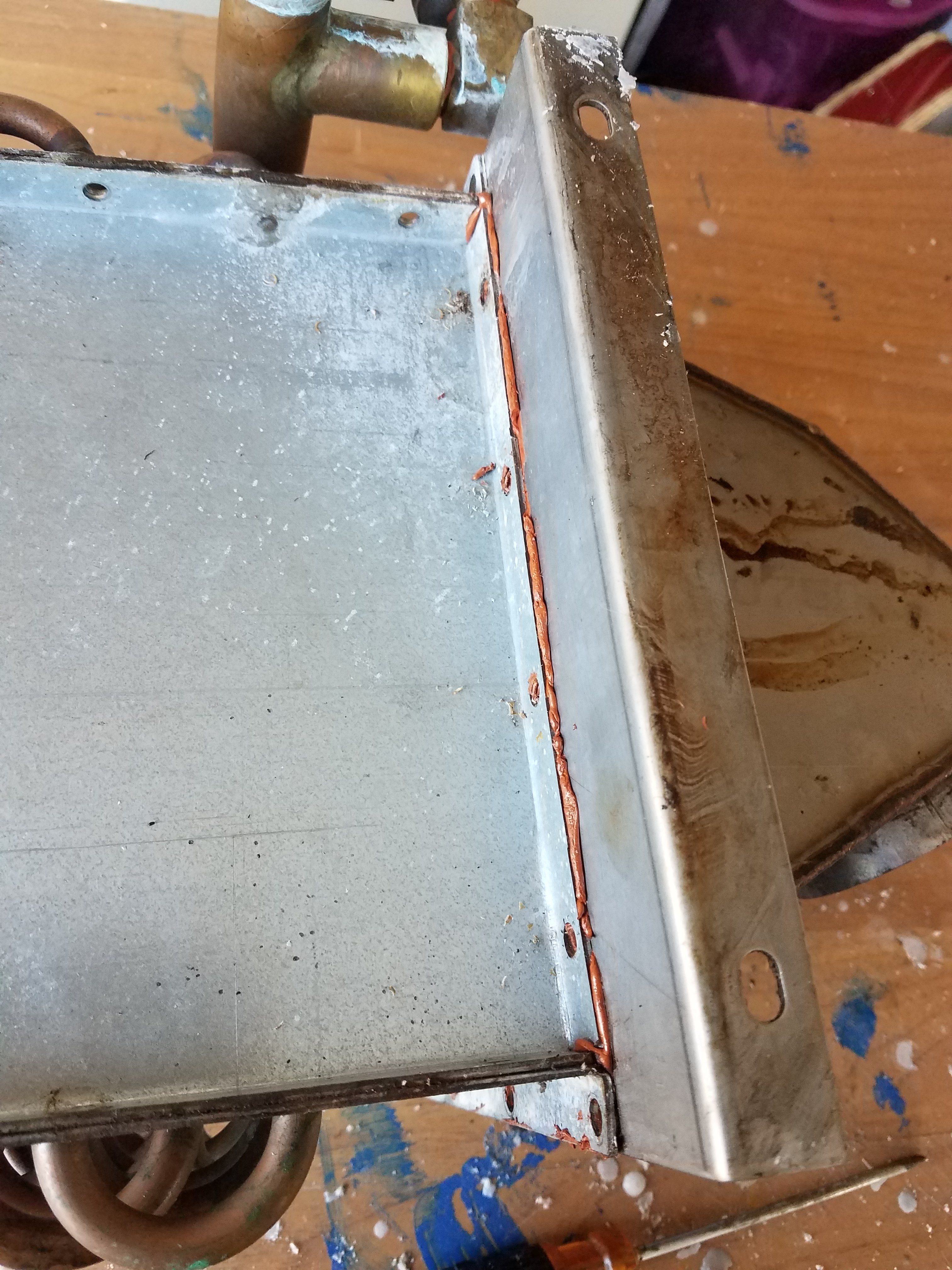

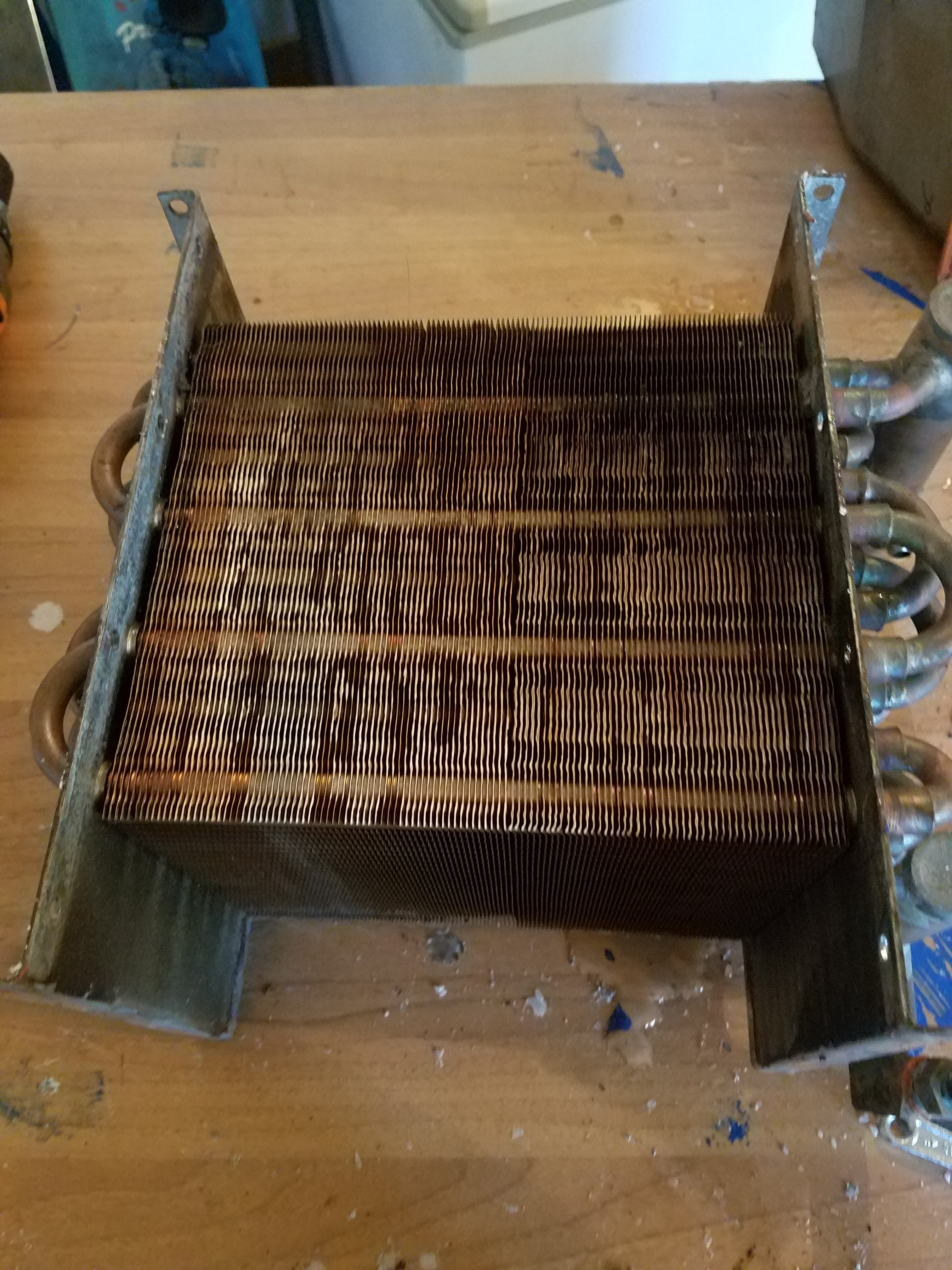

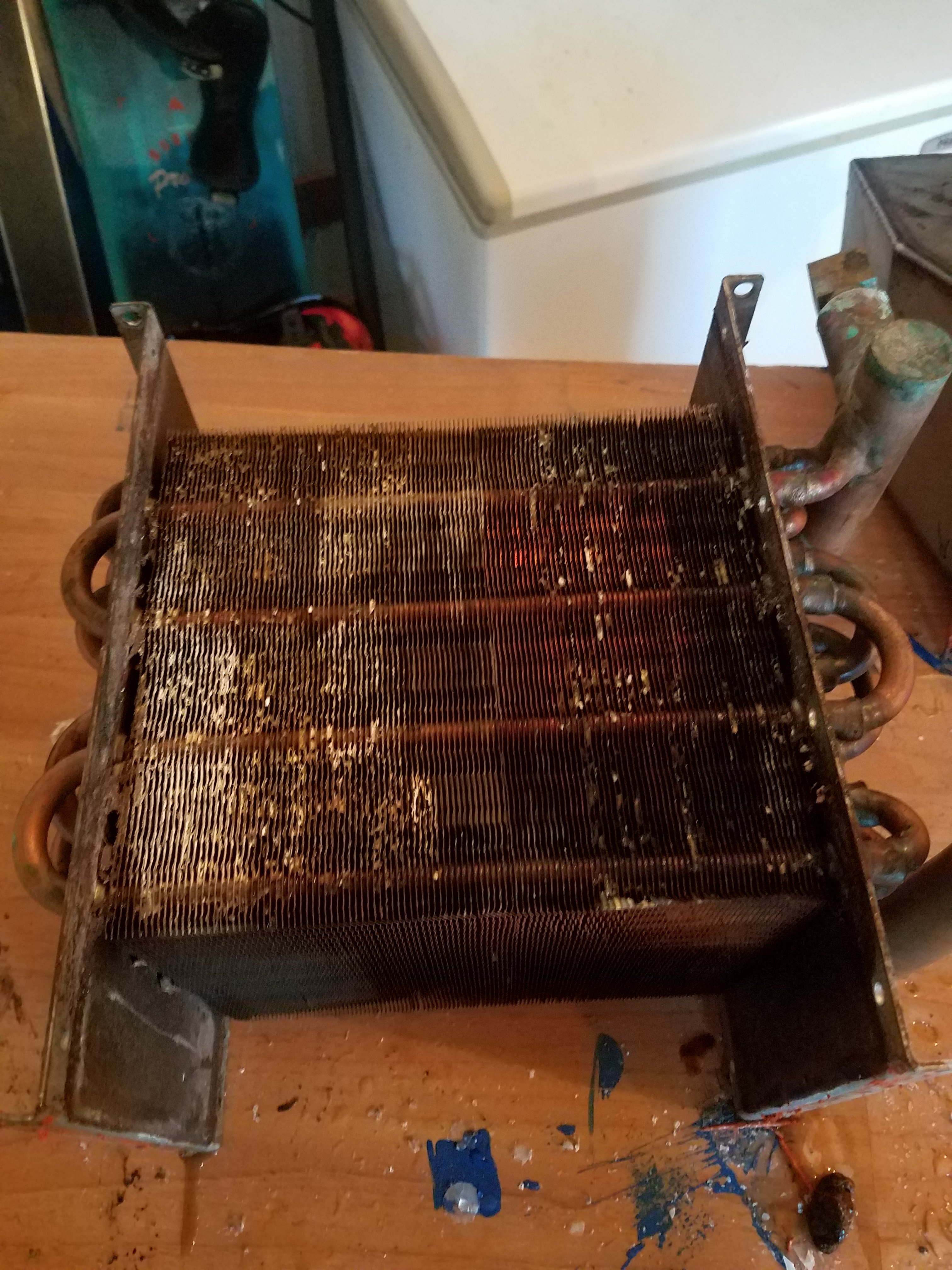

But don’t get this wrong, YOU ARE NOT FIXING THAT U FITING YOU NEED TO REPLACE THE FITTING.
Heat the fitting evenly on both sides and once it turns Red jiggle fitting out.
Sand the inside of the receiving pipes and sand new u fitting .
Heat the receiving pipe evenly until the metal starts flashing heat. Apply the Silfos rod to the metal not directly to the flame but to the metal and if up to correct temperature the silfos will be sucked down the outer diameter of the u fitting and seal between the u fitting and recieving pipes on the coil.
You will need a couple of hoses once repair is done to stress test the coil In order to check for any other cracks.
If just 1-4 cracks are visible go ahead and try repair aslong as it does not exceed 100-150 dollars for the atempt to repair l.
If 5 or more are visibly damaged you had a complete hard freeze and it is going to get expensive as I have to recommend changing all machine high pressure hoses, chemmeter, pressure pump, rebuild chem pump, quick disconnects and change out any thin brass in the system.
