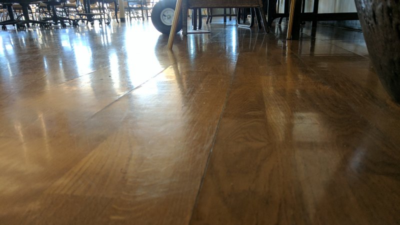

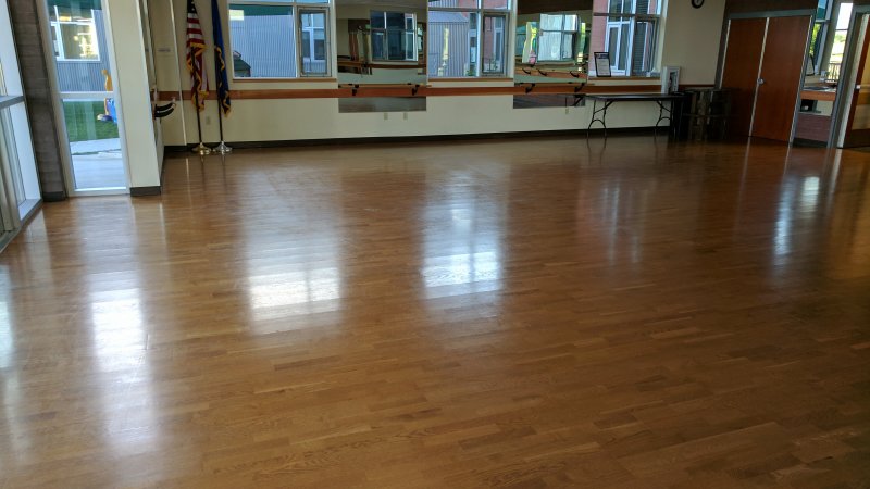

I did a bit more than half of my Community Center tonight.
They asked for my opinion on their laminate flooring..

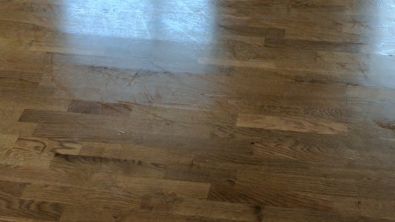

Management thought the satin floor would look better shiny and the Professional janitorial co didn't know any better. The first finish they applied wouldn't harden so they stripped it off and got a Betco gym floor product to stick.
It's wearing like hell and they now want to strip it again and try something else.
The else I recommend is LVP...
Check out this mess...
Probably 8000 feet..
Less than three years old. Ruined by an idiot.
13,416
Georgia
How do you remove that much gloss finish without using floor stripper, causing the lips to curl up? Is the floor ruined?

I would be hesitant to get involved in someone else's problem, it could become yours. That floor is already starting to delaminate.

Is putting some kind of "Restore" mop on product filling in some of the scratches and then buffing up a gloss an option?
Looks like a mess to deal with by stripping and recoating. Put a band aid on it to appease them.
Or pass on it.

Find a good wood flooring contractor and get a price for screening the floor. Screening won't remove all the finish but should remove enough to give you a better base to work with going forward and you should be able to change to a satin finish.
