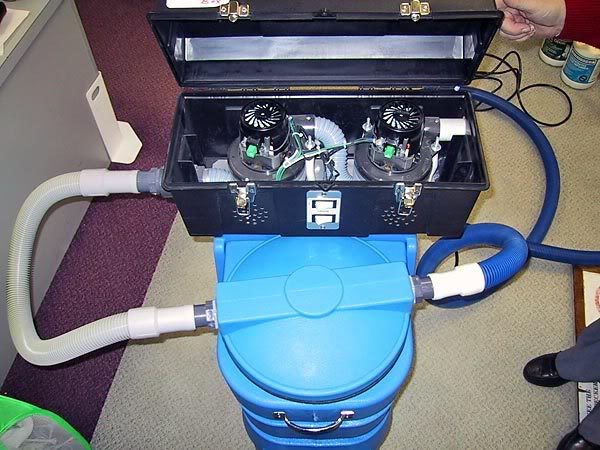

Borrowed pic (To show vac booster)

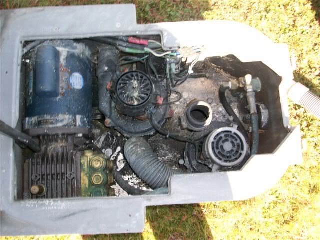

Dumbass mechanic couldn't get a bolt loose on a spring. Decided to try the torch to heat it up a bit. POOF! $17,000 in tools and equipment burned to a crisp, van gone. I found my insurance useless as they gave me a whopping $3200 for equipment and my other insurance gave me $6000 for the van.A pothole in the road for sure, but I bounced back.
