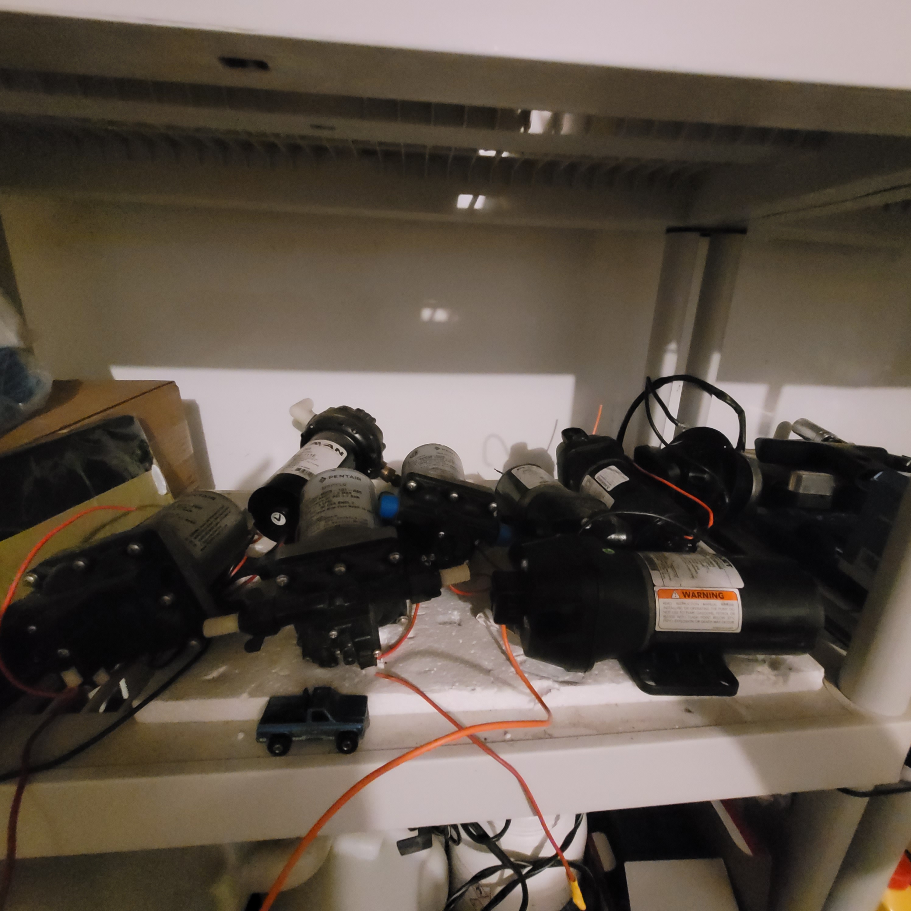

The " grave " of transfer pumps. One of them is a Delavan by Powerflo, bought by mistake ( 70 psi)
