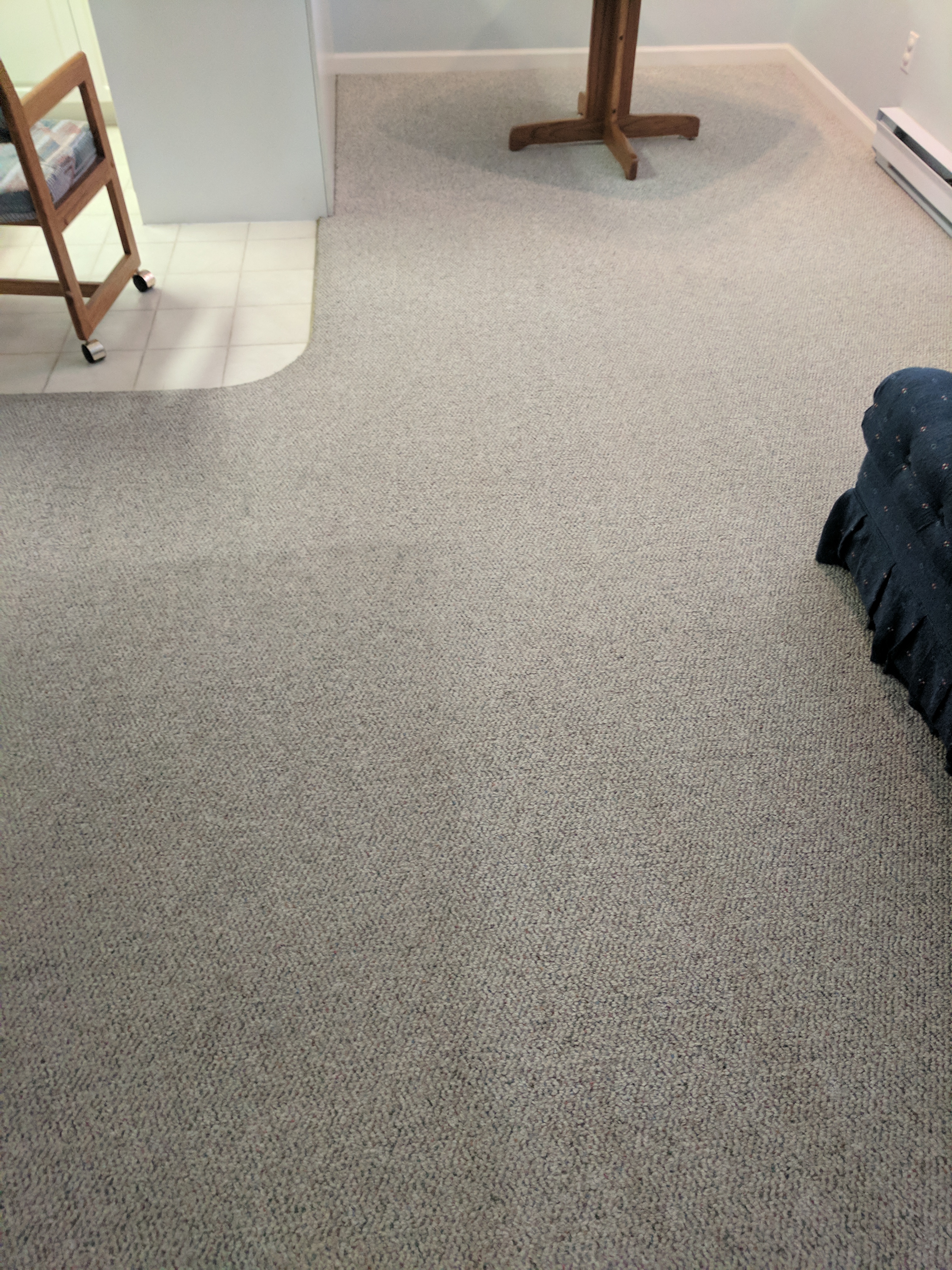

What would cause this and how should I try to fix it.
Took too long to dry. Acid rinse is fine.
If you don't wanna spent 30 minutes setting up the truck.
Trigger sprayer and some peroxide, it should be gone in a minute(if browning).

pretty much doesn't matter how much you prespray as long as you rinse it properly (general rule lower pH are easier to rinse)
doesn't matter the pH you use as long as you bring it back down (same general rule as above)
doesnt matter how wet you get it but it matters how dry you get it
I'll push a trashed wool berber past recommended pH if I have to, but ya better rinse and rinse and dry stroke dry stroke

Our observations were it primarily occurred in Olefin. I’m not familiar with what we termed “Chemical Yellowing” in polypropylene. Nor have I heard of “cellulose browning” occurring as someone else suggested as I’m not familiar with glucose being present in olefin or poly... of course I’m not scientist..

Probably rushed through the job. Berber or other rough textured carpet or carpet with different pile heights need a lot more attention paid to your dry passes. Most carpet cleaners can feel the difference and will know that they are not getting a good seal on the carpet and will slow down and let the wand work. I've never browned out a Berber and find it is one of the easiest carpets to clean. There is no glucose in carpets. It's cellulose. It's a plant sugar found in some backing, fibres and glues. It can be broken down by over wetting or high ph cleaning agents.
