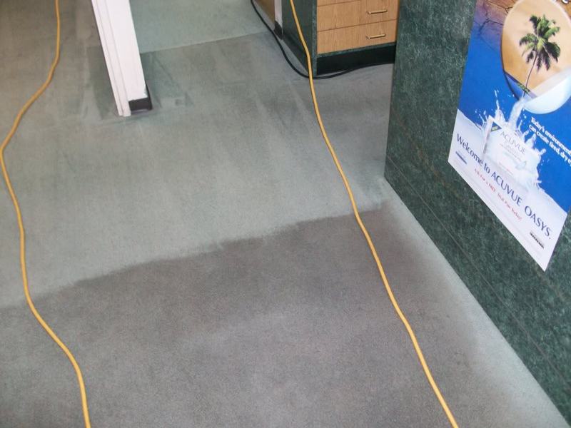

Optical store. It was black before I scrubbed the O2 in.
