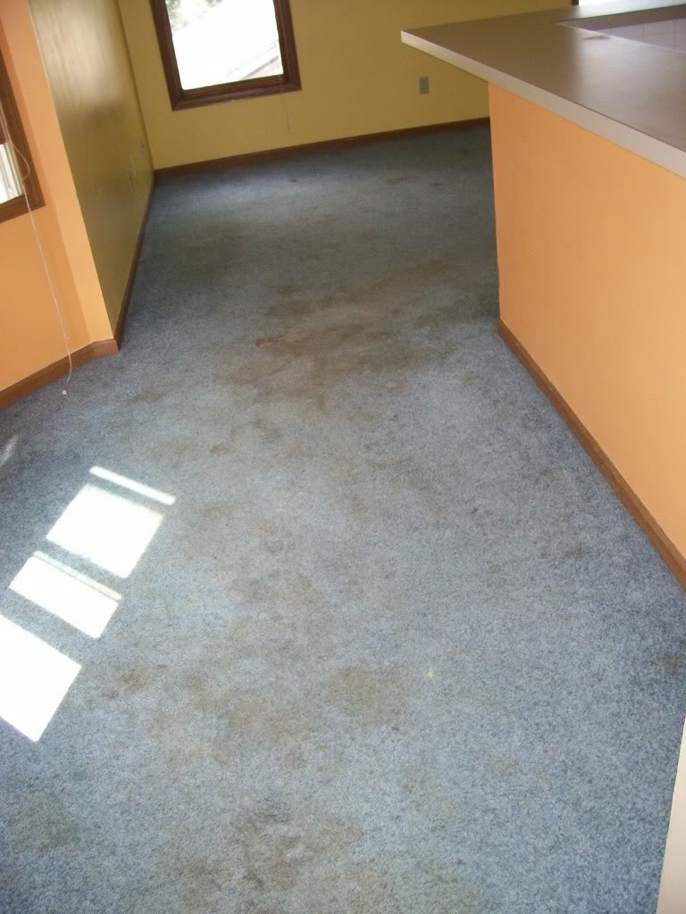

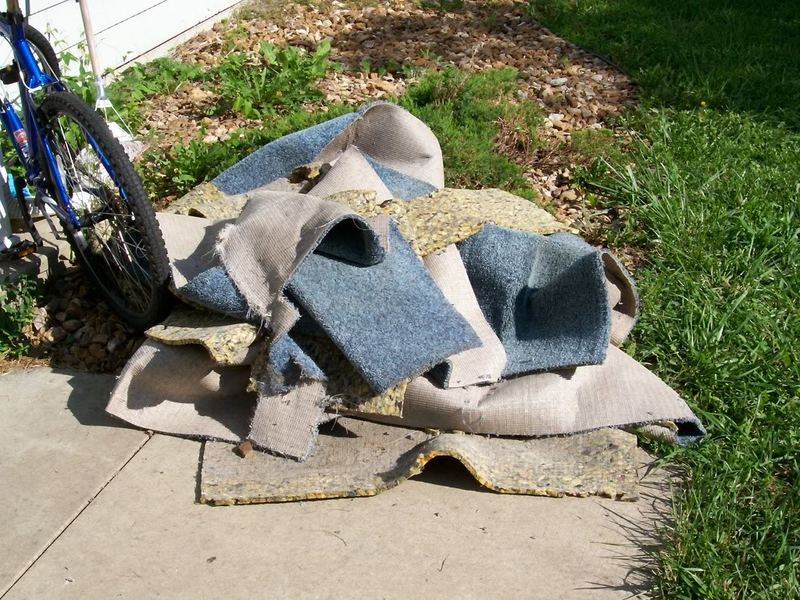

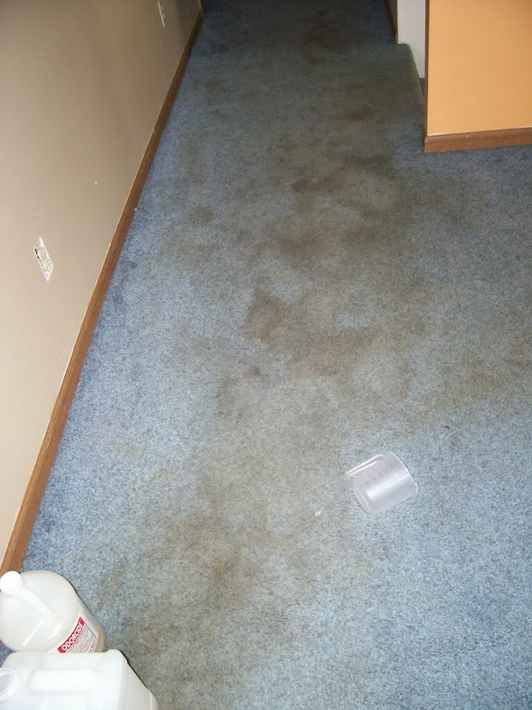

The landlord said he needs this done fast because someone is moving in the same day. He says the main thing is odor. I explain that with the sub-surface extraction method (OSR), I can usually remove urine odor 100%. I told him that I due the extent of the damage sub-surface extraction would not be practical. I tenets had dog(s) cat(s) and a ferret. I told him I would treat the surface for odor but It would only do so much. I sprayed down 4 RTU gallons of odorcide, used an enzyme pre-spray, scrubbed with CRB and extracted. I come back a few hours later to do another unit and the carpet was on the curb. I really need to learn when to walk from jobs.

Personally, i would of recommended replacement from the get go on a toxic rag like that

you were straight up with the guy
(though I don't believe for a minute you'd of got "100%" of the cesspool w/OSR and claw)
Never the less, you explained the options and he made the choice, right?
AND you charged for the treatment, right?
AND got paid, right?
what am i missing?
don't worry..be happy...Deposit the check
