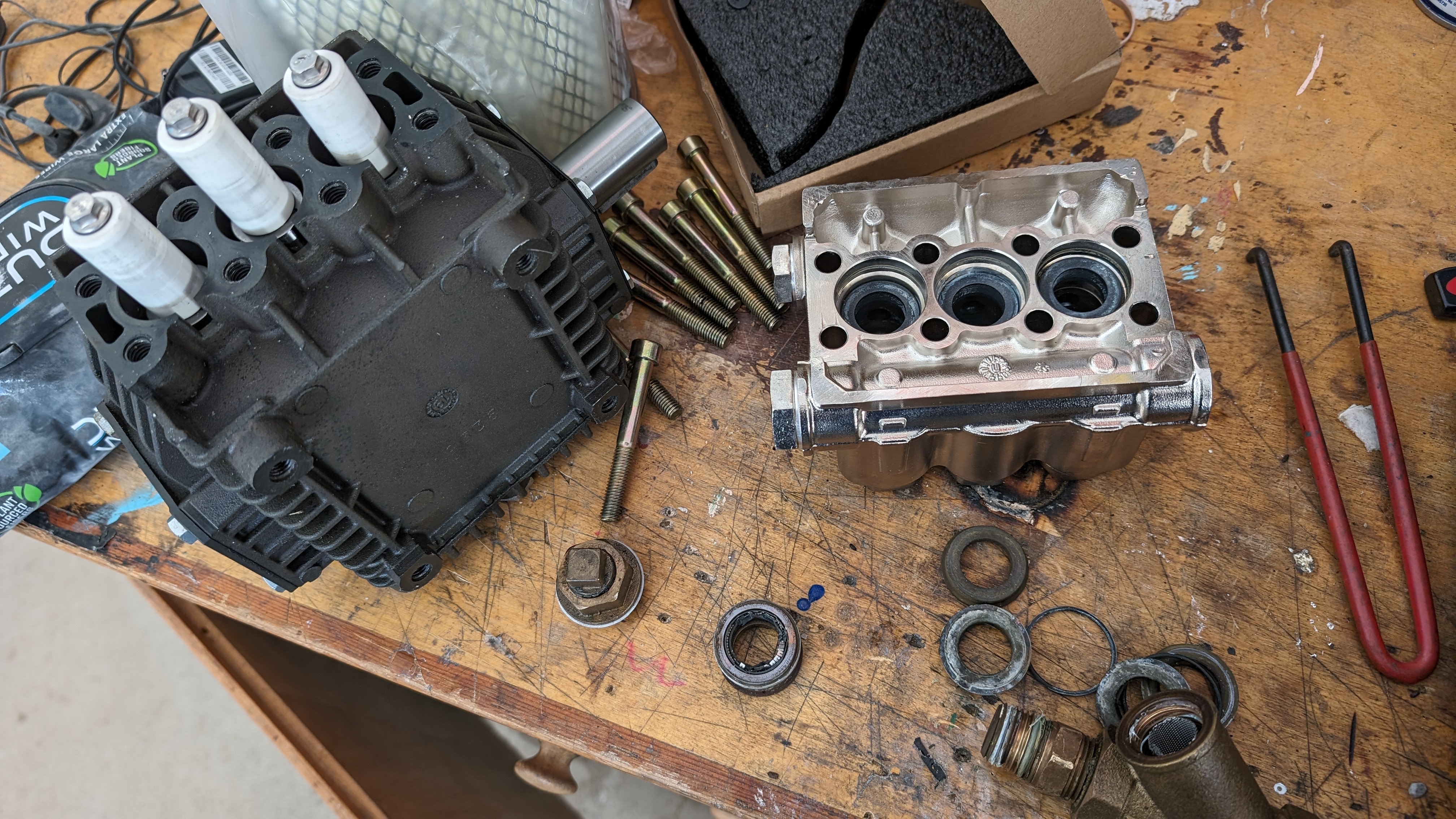

I did the fittings this winter, then the water pump started leaking so I replaced that. Then the radiator started leaking. I put some sealer in it to get by until I got the new radiator. Yesterday, the water pump was leaking again so I ordered another water pump and will get it done this weekend. The inside of the machine is a disaster at the moment
