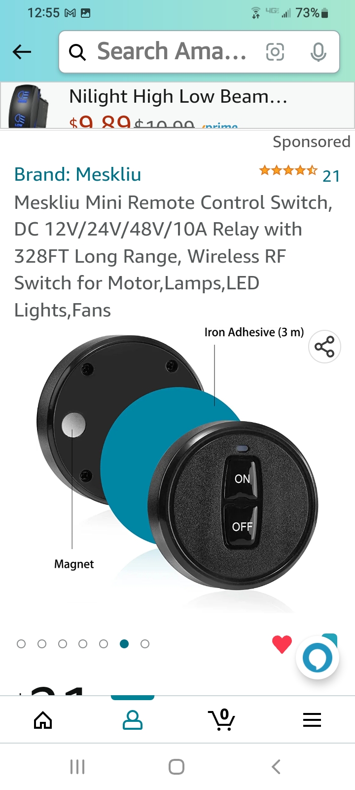

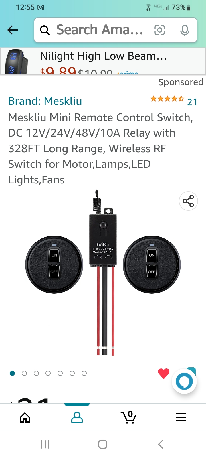

Mr Mikej i have another solution for your conserni ordered this remote also so i can have a button handy on the machine, as it turns out i tend to leave the remote in the home on a windowsill next to my coffee cup. As it turns out this unit comes with 2 magnetic remotes i only need 1 so if you pm me a shipping address im more than happy to give you the extra one,it comes with a metal pad if you don't have any steel handy where you want to install it. This way you too will always have a button handy. Dwaino
Screenshot_20230302-125522_Amazon Shopping.jpg Screenshot_20230302-125541_Amazon Shopping.jpg
