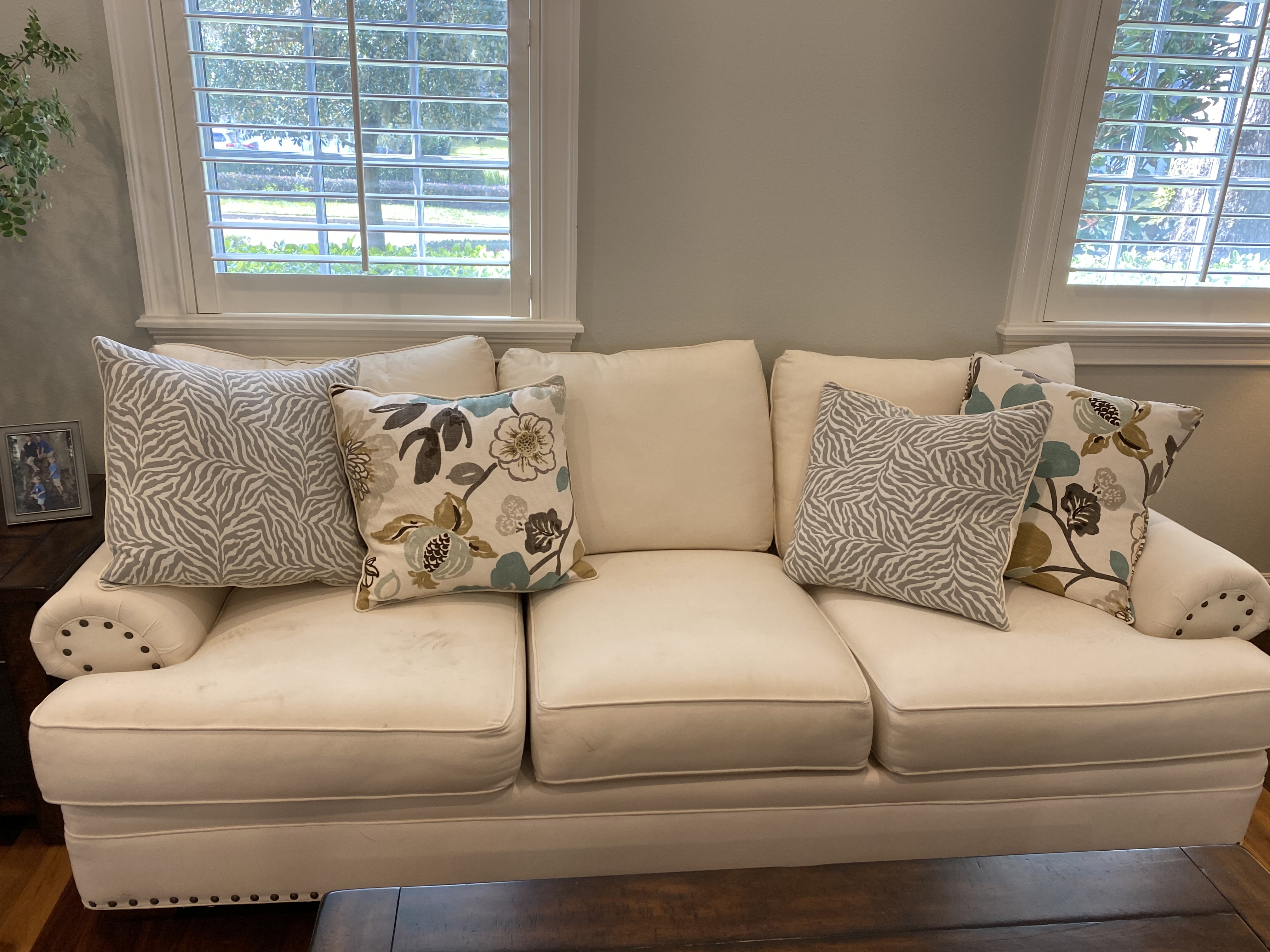

I have cleaned these before. The upholstery browns so quickly.
I have used a Dry foam method with a sponge. I've also HWE with an upholstery tool using a low pH product. The products claim to be anti-wicking/browning. Both ways do not get the results I am seeking.
Other than dying from the fumes. What can I do to clean this couch with soil removal and wicking? Even if I sneeze on this, it will brown quickly.
Burn test shows polyester/cotton blend. Inside has feather stuffing inside a white covering (IDK what fabric is covering the feathers. It may be cotton also).
I just zoomed in on that pic. Is that an after shot of the job or before?

That's good. But no, I am not. I just shared this photo because I have been coming across this type of upholstery far too often.
I always test the fibers (burn test only) and see what I am working with. The last few I have done were already stained heavily (browning) and I did not want to proceed with this particular couch since it had minimal damage. Light staining from dog trafficking soil from outside.
