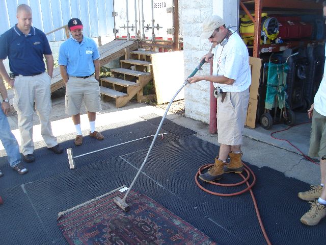

We are currently designing a permananet rug pit. We expect to process 30-50 rugs a week. It will be a submersion type similar to what Jeff Bishop demonstrated at Connections. Obviously we hope it will process more buy we are being conservative. Rug Badger or Compressed air? Which and why? Any advice is great appreciated.
