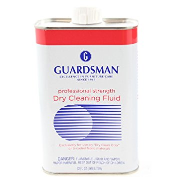

Like Guardsman?
I have used this before on unknowns, but never on adhesive.
Reactions: Living The Dream
28,118
Like Guardsman?
Probably very similar, I just prefer to something specific to carpets like Prochem or whatever but if it is volatile(fast evaporating) it will work. That product however is flammable. You might want to think twice about that.
