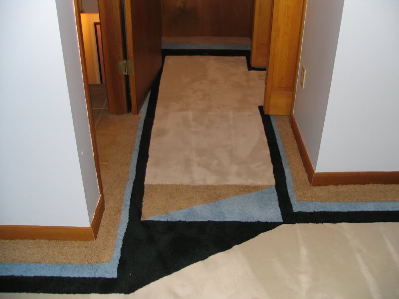

Here is an installation that had triple borders and some inlays. The interesting part is to give you ideas of some thing that can be done.
The entry area, the light colored carpet right off the door way is a piece secured with the Kool Glide. Additional carpet of the exact type was saved. The reason? In the future when this entry piece gets worn or soiled or what ever, this can be easily removed with the Kool Glide and a new piece put back in its place. This allows for a long tern usage of the carpet in this room.
A similar condition can be done in a home or commercial establishment. The same principle can be applied by making of a Logo Rug and inlaying it into the entry of the location. As time goes on it can be removed an a new one placed in.
Also, if you have an entry area that is worn and beat up you can replace the entry with a logo rug and make everything look great again.
Lots of options in this repair business.
Just thought I would share a thought on this concept. I have done some of this work and it has worked out great.
seam is in the middle of the closet door, this can be opened and the large piece in front of the door removed and replaced
All of the rest of the carpet, borders and so forth are permanent and cannot be removed but the entry way was installed so that it could easily be removed and replaced at a later time, if and when needed.

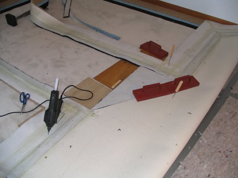

Here is a shot of the backing work done here as well, just to show some of the layout
