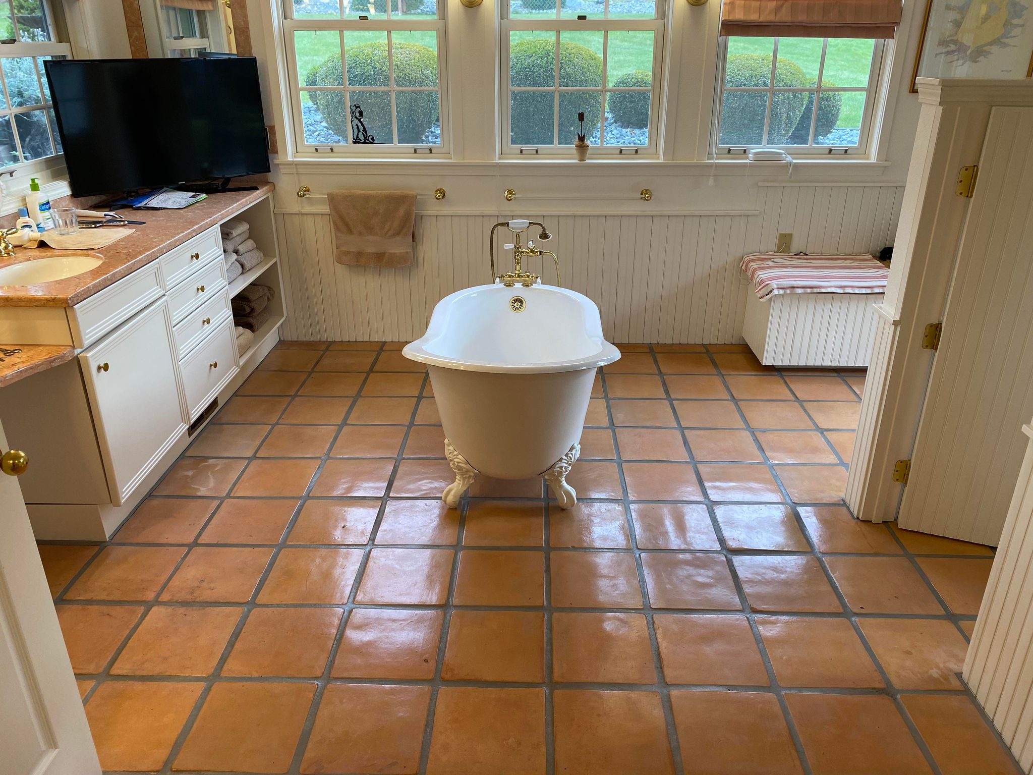

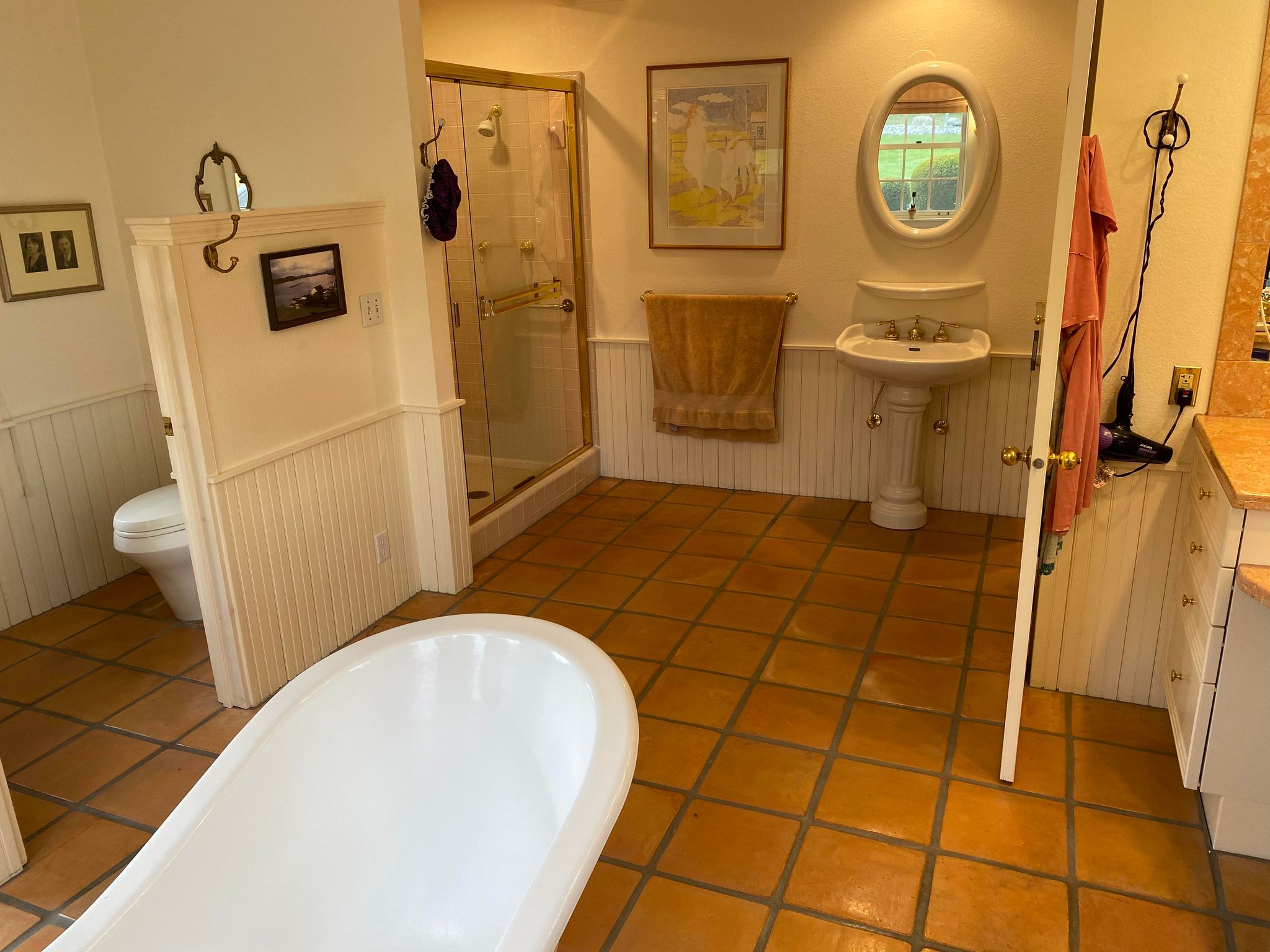

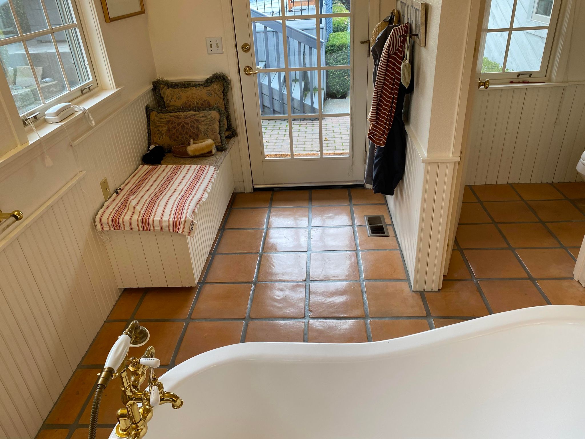

BEFORE (a perfectly fine Saltillo)
387329702_1762985027480718_2319105787710071403_n.jpg387330978_350646217514589_5815721812769460170_n.jpg393813228_870725647982616_2522561905866066020_n.jpg

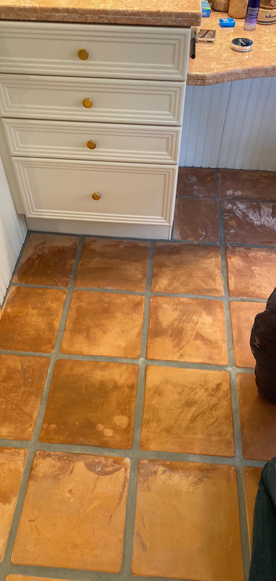

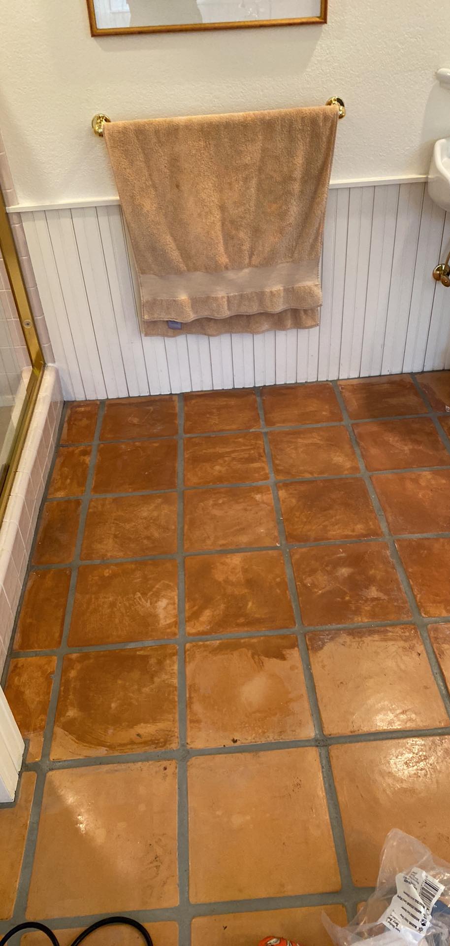

During/after
THIS being using soy strippers, a 5in1 in one scraper and acetone...
NO rinsing with a truckmount or shop vac.
He tried a wood floor machine like "Courtney Lee uses" to rinse but the squeegee couldnt deal with the groutlines and uneven man made tile.
I know this guy and really wish he would have called me insted of going straight to You Tube.
I got a bunch of infrom him and determined his ability to attempt a fix, but sadly, there isnt wiht his skill and equipment.
I told him to stop and find a pro to fix it.
Which will probably take a FULL and proper stripping of the entire floor, which will efffect the walls and woodwork, and cost a small fortune.
