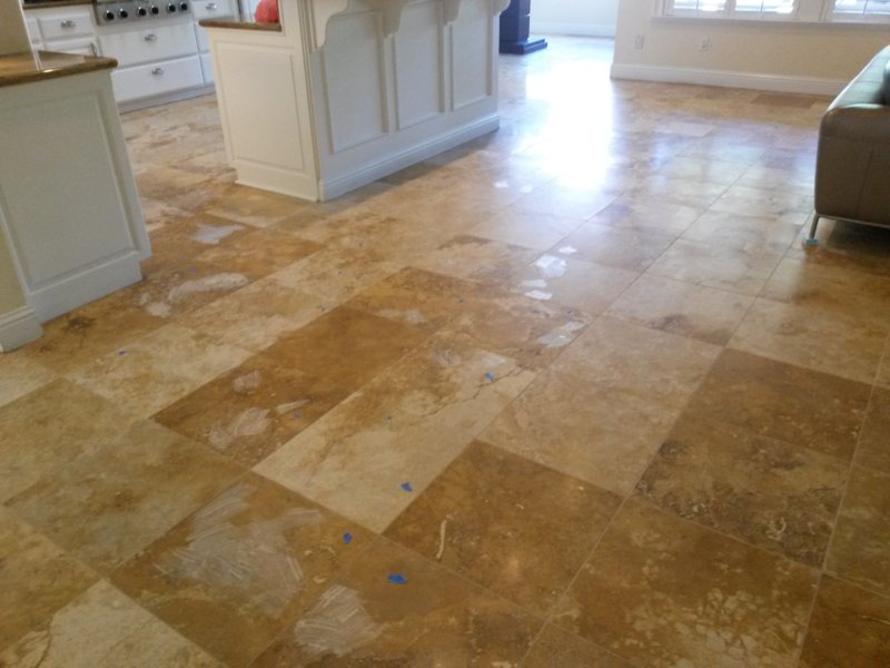

May 11, 2016 #2 clean image Member Joined Oct 5, 2012 Messages 969 Location Orlando Name Carl Maddock please tell me you didn't put a topical on there
May 11, 2016 #3 Mikey P Administrator Joined Oct 6, 2006 Messages 113,218 Location The High Chapperal just wet...
May 11, 2016 #4 Mark Saiger Mr Happy! Joined Dec 26, 2006 Messages 11,197 Location Grand Rapids, MN Name Mark Saiger No way...too much work on hands and knees.... I would still be down there hoping someone could roll me outside....LOL

May 11, 2016 #5 Mikey P Administrator Joined Oct 6, 2006 Messages 113,218 Location The High Chapperal I was asked by no less than 25 Blue Hairs to go home with them to clean their floors I was called Cinderella four times I got 8 "Wow Your job sucks! I handed out 5 cards Got watched by one competitor and could have sold AT LEAST 30 Rollie Knee carts from Harbor Freight Reactions: Old Coastie, dgardner and Mark Saiger

May 11, 2016 #6 GeneMiller Member Joined Mar 24, 2009 Messages 3,541 Location Boca Raton Name gene miller What did you fill it with, Unsanded grout . I don't do it anymore , I just start to lock up if I'm down to long. Most of the guys here use the expoxy filler now.

May 11, 2016 #7 Mikey P Administrator Joined Oct 6, 2006 Messages 113,218 Location The High Chapperal Sanded, mixed 50/50 with Acrylic Admix and water

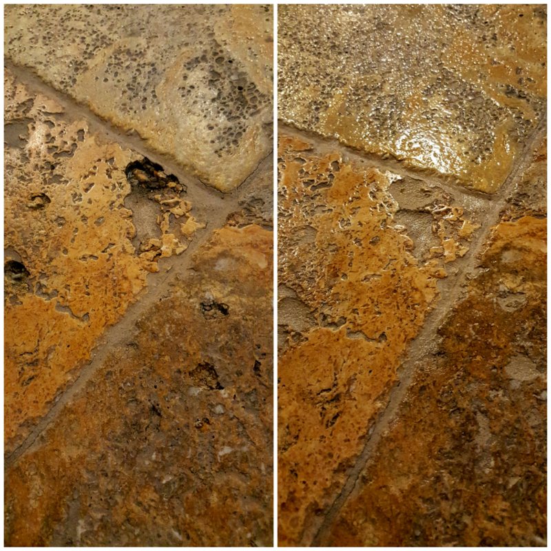

May 12, 2016 #9 jcooper Member Joined Oct 7, 2006 Messages 3,232 Location IL Name Jerry Cooper clean image said: please tell me you didn't put a topical on there Click to expand... Why wouldn't you seal travertine? Mikey P said: just wet... Click to expand...

May 13, 2016 #10 Mikey P Administrator Joined Oct 6, 2006 Messages 113,218 Location The High Chapperal We sealed the floor with a PENETRATIVE last month..

May 14, 2016 #12 clean image Member Joined Oct 5, 2012 Messages 969 Location Orlando Name Carl Maddock Impregnating... Ok Not film forming sealers

May 15, 2016 #14 GeneMiller Member Joined Mar 24, 2009 Messages 3,541 Location Boca Raton Name gene miller didn't know you could use sanded grout. i always thought it would scratch the finish.
May 15, 2016 #15 Mikey P Administrator Joined Oct 6, 2006 Messages 113,218 Location The High Chapperal Huge holes...
