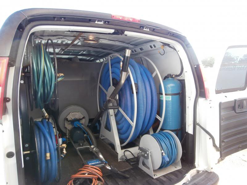

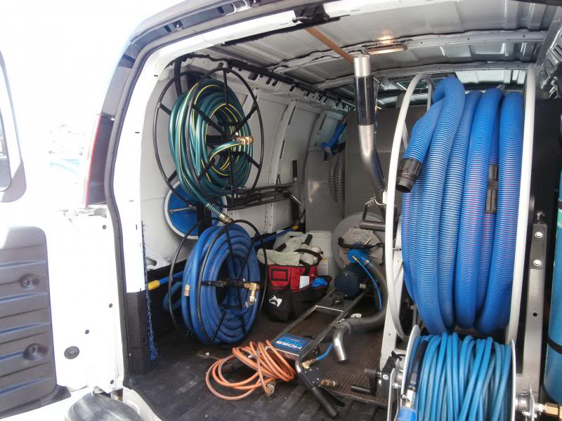

Hook your Hoss up to the 570 and you will never look back...............

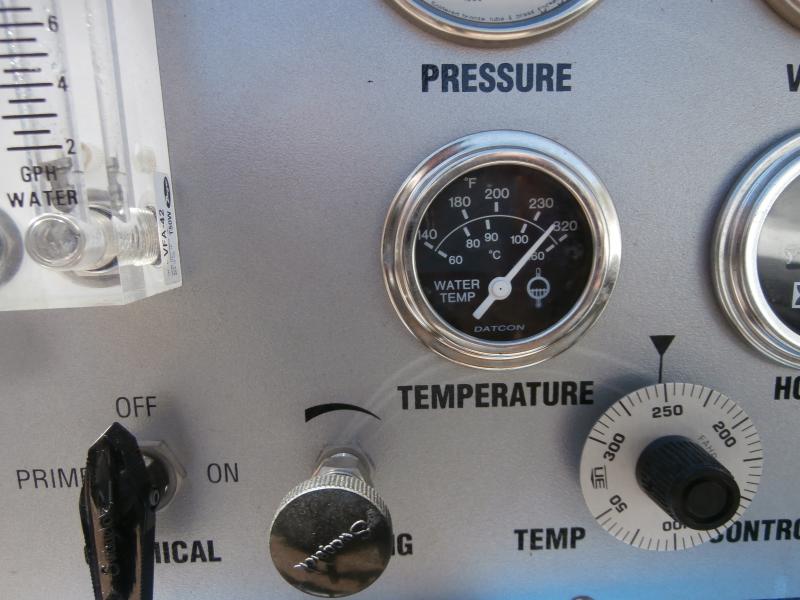

Jim how many feet of hose u run? Ever duel wand? How hott does it get?
How do you have those hose reels mounted on the side like that?

I am running apprx 150 of 2inch and 50 foot of 2.5 inch..........
I don't duel wand...If a job is that big I would much rather take both trucks....I don't like one truck stuck in one spot all the time...
I can have all the heat I want....and then some...and this machine can maintain it...
I made my own stand for those reels....top is a live fresh water and the bottom is a live APO....
