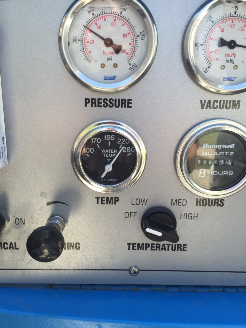

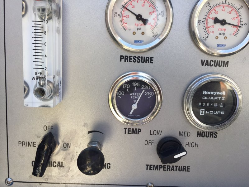

Is this normal????
11,137
Its constantly bypassing water no matter where I set my temp gauge off low medium high the machine stays about 220 to 240 and bypasses alot like one job full tank.
Had Mitch look at the temp switch, the magic potion had blocked the out bound screen and left alot of white crap so he cleaned it all out said that was the problem. I had cleaned and it was working but He never checked the temp switch which still seam to work.

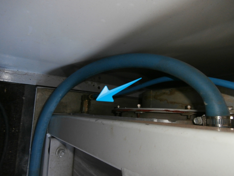

to be honest with you...IMO...I don't think these therm valves can handle the 570....I have been through 2 of them and the one I have now sticks now and then...I know others that have had to replace theres....it is either the location and crap is getting into them and making them stick...or the heat from that box is cooking them...from the 2 I have already pulled...they look like they got way to hot............
I run the exact same one on my thermalwave and I have yet to replace it...

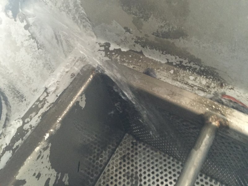

I just got off the phone with a friend of mine who has a 570...I was telling him how mine is always dumping...once that tank warms up..that machine can generate so much heat that I can set it on 230 and hold that temp all day with the therm valve dumping...most the time even after I have shut off the machine and disconnected the fresh water hose...you can still here it dumping into the tank....

Thanks sapphire empire called this morning for me to bring it in.
The thermal valve was closed when I took if off this morning could blow through it.
Richard prochems and sapphires have an out bound last step chemical injection screen. Meaning any chemical would affect the screen and brass connections leaving the machine only there was some dirt in the in inbound screen but I always have had great water flow.
I am understanding this correct...if you took the thermvalve off this am and the water was cold...you should not of been able to blow through it...it should of been closed while it was cold and it opens up and dumps water when it is hot.....
