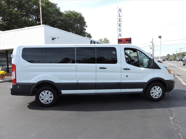

2015 Extended Transit 350 passenger (35k miles for $26,500= saved 15k atleast) is on the way from Texas

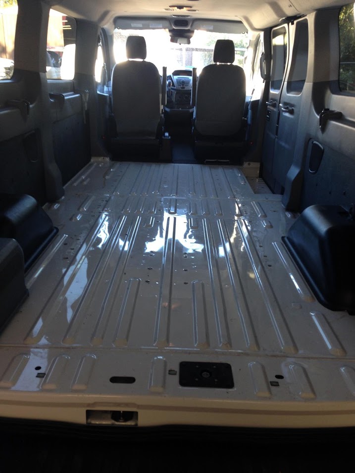

The dealer pulled the seats and carpet kit for me..
Pulled out the HVAC system as well..

The allure of a passenger van is rear AC and visibility. We'll wrap the whole thing with the perforated vinyl. Back up camera and lane change alert included.

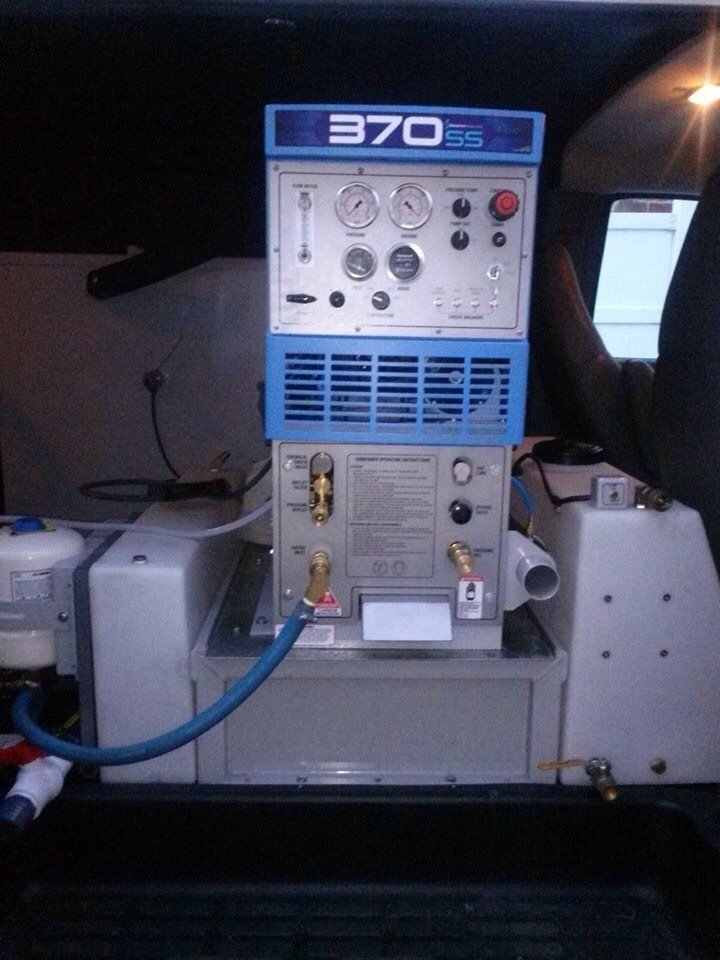

Not mine but shows the included submount water tank. If that tank prohibits the mounting of the Rokan reel on the side I may go with a wheel well fresh tank.

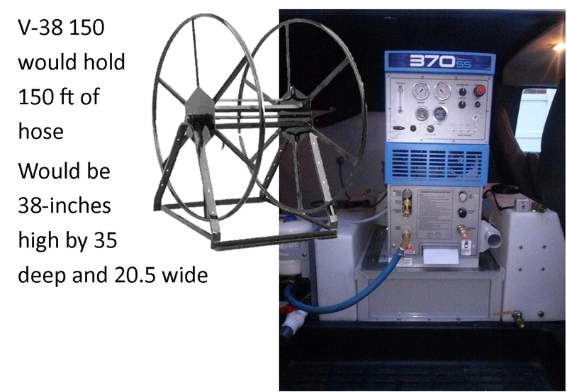

How much height from the top of the water tank to the roof?
Is their 40-inches? If so you could have a frame built out of angle or square tube and mount a V-38 to it.

Yea a V-49 250 will hold 250 but its 49-inches high so it will need to be mounted to the floor. Its is narrow though, like 20 inches wide I think. ???

No I like V49 too for carpet trucks. We use the one that hold 200 they are 16-inches wide and we just hang two 50's in the back. I don't like the short & wide ones but if you need the space I though you could fab up a frame for the V 38. For the WDR trucks we use the V49 with 250 hose and carry a couple of extras vac sections.
