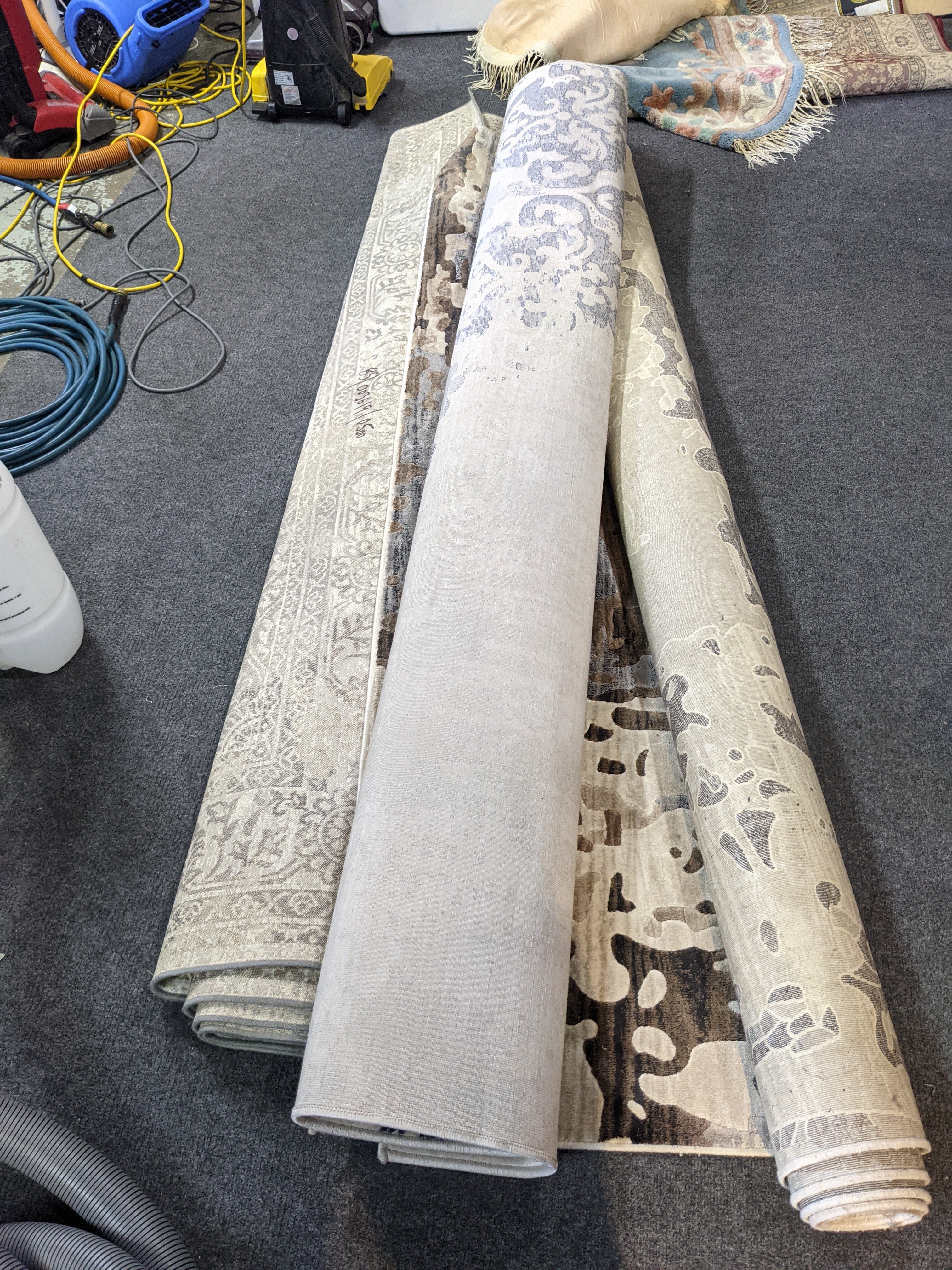

Just picked up 3-8x10 rugs. 1 is polypropylene the other 2 are viscose. Either have to learn to clean them or do without.

We do a little more than that. Might not be doing full immersion but I dust and vacuum both sides, prespray and shampoo with a 175, rinse and extract, then hang to dry. Treat any special problems such as urine or other stains. It's not a simple spray and suck.

sanitaire and pile lifter. Or beat it with a hockey stick. Pile lifter works well. Usually vacuum both sides with it and vacuum up the debris with a separate vacuum. Pile lifter is great for knocking the dirt out but not the best vacuum in the world.
27,878
Full flush, Cimex the poly. Viscose -Slowly extract with few passes as possible. Might use rug sucker to flush it more. Or DryEze Rover to extract.
Hang poly- dry flat Viscose.
I use the 175 on viscose now. Using Chemax Rayon rug shampoo. Prespray it first, then hit it with a higher concentration in the shampoo tank. Provides enough lubrication so it doesn't damage the fiber. I foam it all up then rinse and extract and hang to dry. Doesn't hurt the viscose as long as you do a good job extracting. I speed dry with flood fans and a dehumidifier.
