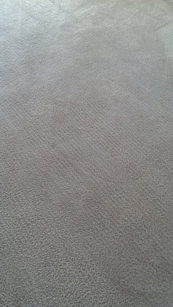

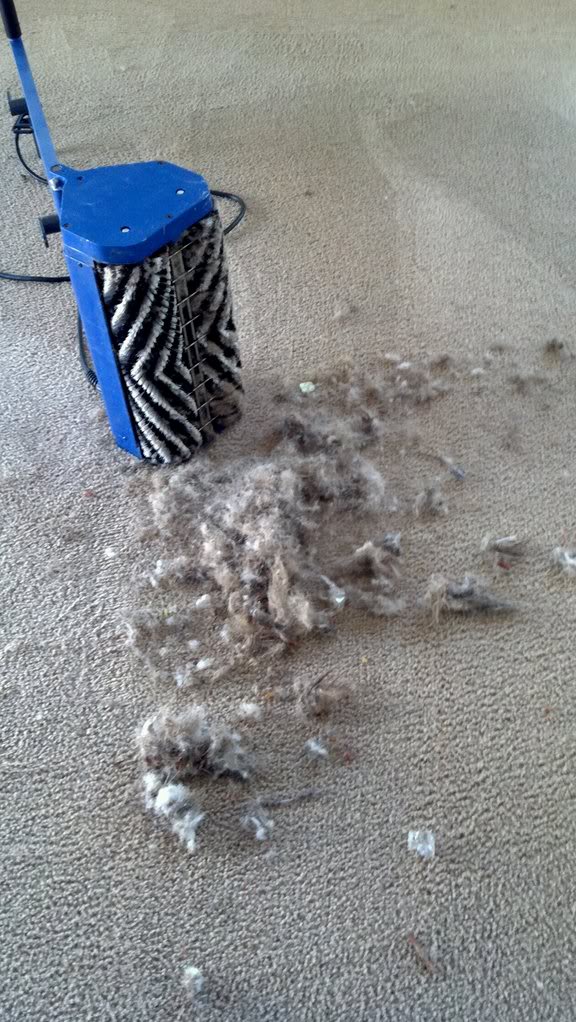

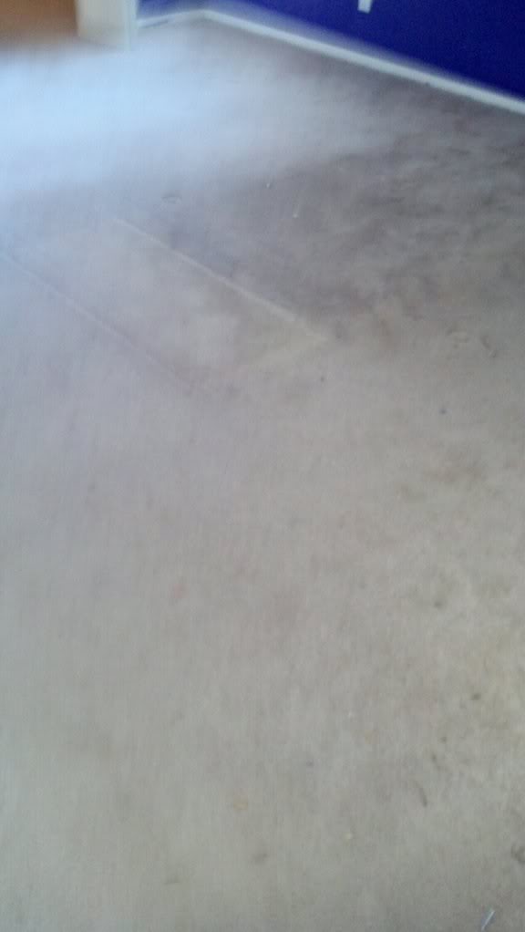

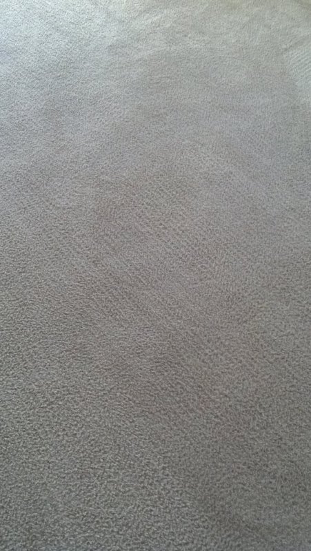

This one did not look to bad...
Before
after
this baby digs up alot of shit..
I love my cbr. and 24 flow....... :shock:

Brushes looks like it fooked up the fibers. Yes a 175 will ball up and dig out gunk. Carpet still looks bad.
Golden Boy
117,272
most of that is fiber ripped from the scalp..
I have both types of machines and prefer the manlier 175
Kicked the shit out of that carpet, of course that one needed it. What about lighter soiled carpet is it to aggressive for that? I'd be a little concerned the client might question where all the fuzz clumps came from.
