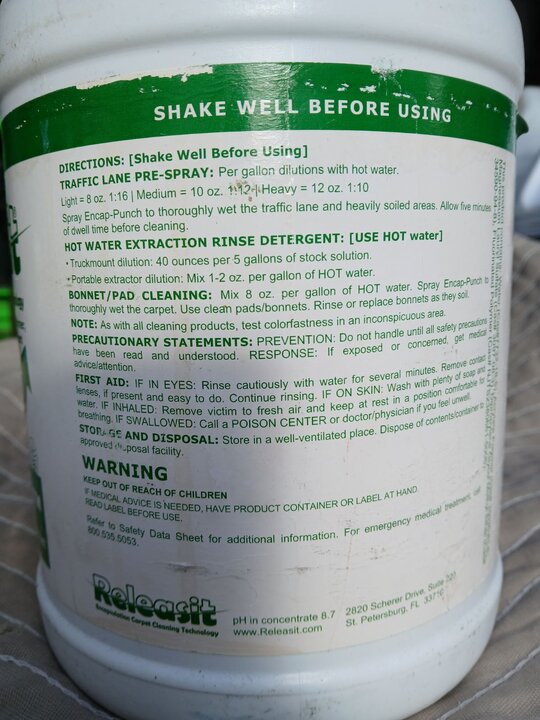

I'm not suggesting not using Punch, I just wouldn't run it through my porty. That's just me. It
says you can, but it is an encap. I use it when using a polisher on chairs.
Why does my phone say I'M ignoring certain memories!!!¡!!I'm not suggesting not using Punch, I just wouldn't run it through my porty. That's just me. It
This week I did some furniture cleaning at 2 Houses. I did one on Monday and after the sister saw the job she called me to do hers
Both Sisters have 2 German Shepherds that lay on the furniture. Lucky for me both Sectionals were dark blue but still were atrocious
I used Punch as a Rinse Detergent at 1 oz per gallon in my Heated Portable ( water gets to 200 degrees ) and was very pleased with the results and so were the customers
After doing those jobs I thought maybe I should have used it at 2 oz. It says on label 1-2 oz per gallon for portables but I think that is for carpet not furniture
What are your thoughts on using Punch as a Rinse Detergent on TRASHED Furniture

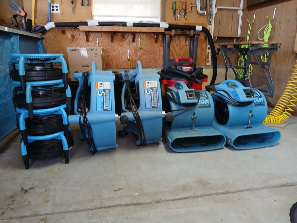

I'm a fan of my fans

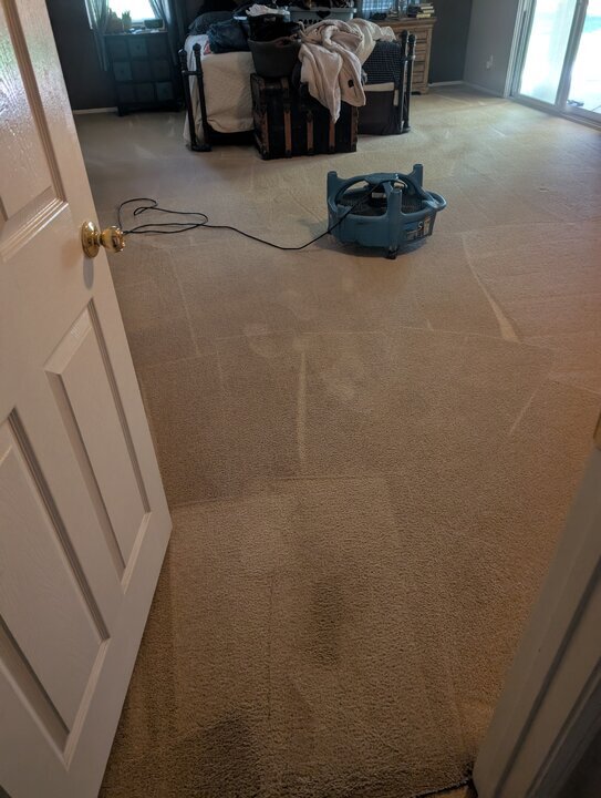

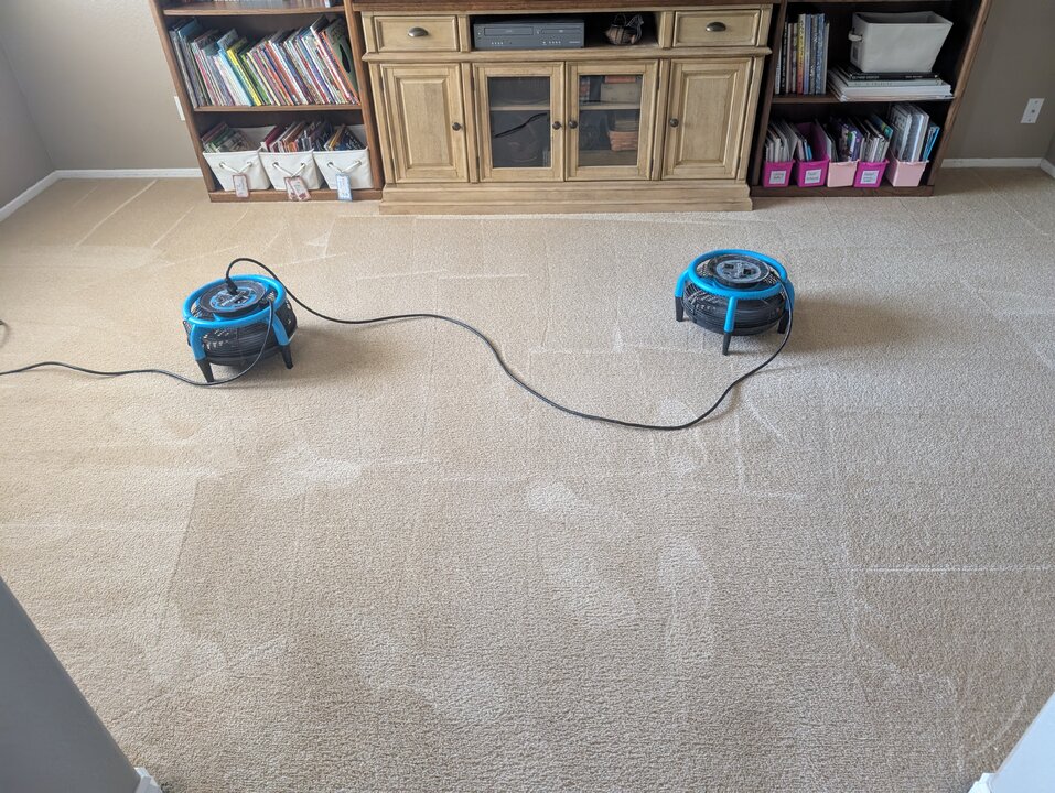

View attachment 133136 View attachment 133137
Your agitating alrightI will NEVER go back to those days when I needed fans to dry carpet FAST
Now I get Residential Carpet CLEAN and DRY in 1-2 Hours without fans
It's not the 1990's anymore
My 4 Dri Pod - 2 Air Path - 2 Turbo Dryer just collect dust today
LESS water MORE agitation !!!
I like Procyon plus powder as a rinse. On fine fabrics I sour it with Ultrachem Labs Neutralizer.Most of the time I just rinse with water but this furniture was nasty. It needed more than just water
Why not in portable ?
And what would you recommend I use on TRASHED Furniture with portable ?
