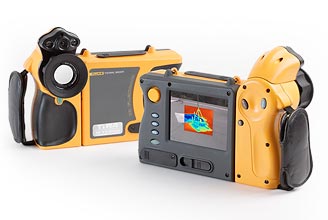

Thermal cameras like the Fluke Tir-3.

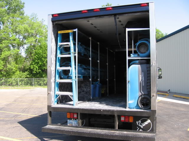

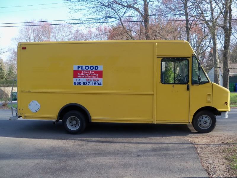

This truck was the best investment we made, we can carry a ton of equipment but we used it mostly as a dumpster on jobs.
I paid 3800. at the auction only 91,000 miles. It saved and made us a lot of money

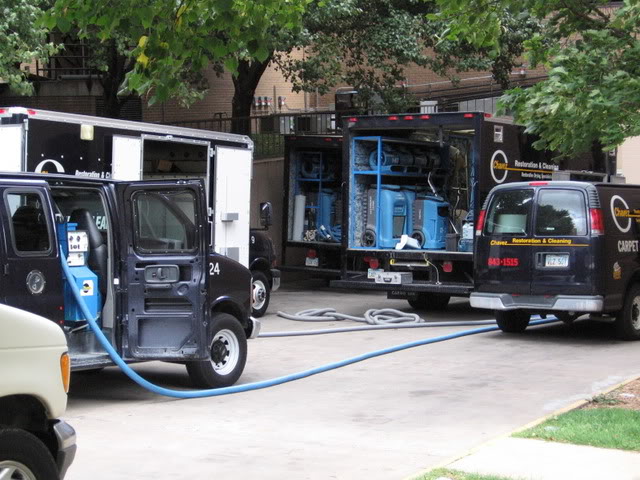

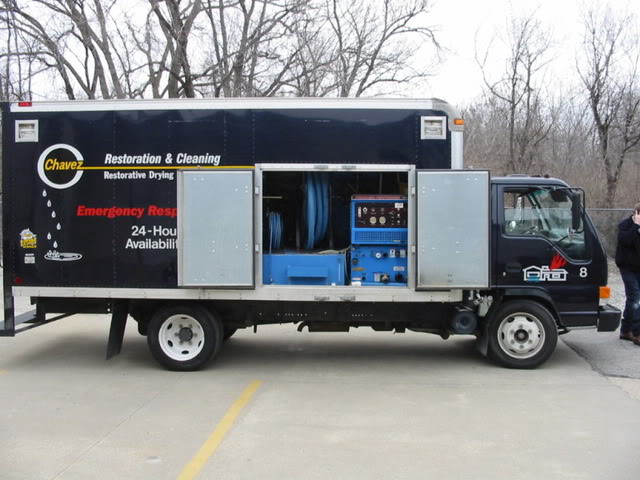

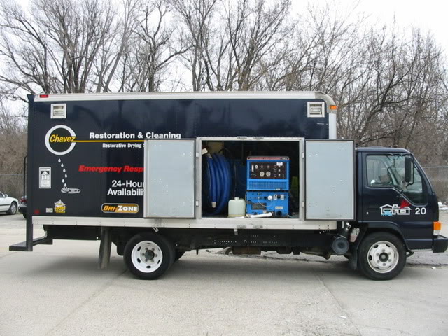

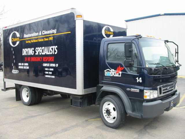

Al the first WDR trucks I ever saw were at a Water Loss Conference in the bay area. Butch Carpenter's Ideal Restoration had trucks like that setup for WDR.
I came back and told my father and he said yea that would be nice but that's California and major population. We are too small for that.
A few years later after unloading carpet equipment and reloading drying equipment we talked our father into allowing us to setup a box truck that wasn't used frequently.
We now have 5-setup for WDR, they don't get used everyday but sure are nice when you need them. (2-are out right now)
When you get a call you just roll and you have everything you need already loaded. You come back in and restock and it sits waiting for the next call.
Nice truck AL!

Thanks! It's a chick magnet too

That Fluke Tir-3 is a little spendy huh? Nice equipment though.

Yea it is, we have three of them spendy dogs too.
There are quite a few lower price cameras out there. They will do pretty much the same thing too, except you might have to step a little closer to the wet area. With these you can be much further away, but not really necessary in a home.

Richard, do you guys have truckmounts in all 5 of your water trucks?
Re: What equipment are you using for Water Damage Restoratio
Ed
Three of the five are Prochem's, one is a Blue Line Super Extractor and the other is a Butler in a box.
Then we have a WDR truck that has no machine, well no TM but is racked to haul WDR equipment.

Very nice Richard. What model are the trucks that have the slide ins?
G
What service area do you cover...like mileage radius? My service area is mostly rural but does cover six or seven small to medium sized cities...low competition. Thanks for the help .....how do you like to Butler system? (I think I saw that in one truck)
Ed they are Prochem Performers, the Nissan powerplants, one of them is an Prochem 805 with large recovery tank.
Darren our service area is 30-miles Topeka & Lawrence, but we will go anywhere they pay us to go.
Lots of competition here! thathurts
Love the Butler's especially in the box. It just gives you so much room for all your equipment.

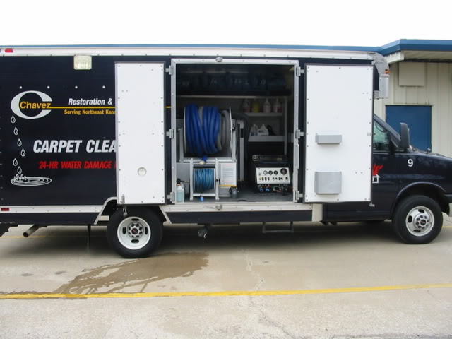

How long is that box on #9? If you have a pic handy of the inside of #9 that would be awesome!! I need to get familiar with racks for air movers and storage for Dehu's and such....trying to find good designs and set-ups.

Richard what are the "trucks" you have the slide ins in?
Sorry Ed I misunderstood.
(2) 01 Isuzu box trucks
04 Ford Powerstroke box truck
96 Ford box truck
Then the Butler in a box is a 07 GMC
