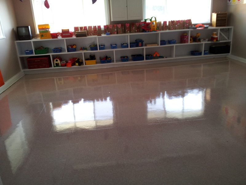

And what would make you think I need help? This was done with a 16 inch microfiber pad with a whole lot less wasted product - a little better than half a gallon.In fact, I did all 1600 sf of that job, 5 coats with less than 5 used. So- how does my purple starfish look and smell from the back rows of the dog team? No licking please. I'm not that kind of dog.:biggrin:
