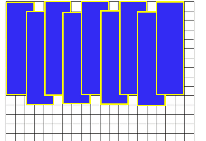

Proper stroke in my opinion is trigger on as you pull it towards you. Push wand up over the area you just cleaned. Overlap by 1/3 and repeat. Then dry stroke over the same area. Straight up and down, no sawteeth.
I agree 100%. What I am seeing in these videos is guys spraying up at a angle, coming down at a angle and then spraying back up at a angle. So your spraying water back down on a area you just cleaned.

I clean on a straight backstroke
Sawtooth over (dry) to the next backstroke..................overlapping a bit
clean straight backstroke
repeat until row is finished
sawtooth drystroke back over row....start next row
any other way is wrong..... I don't care what any of you say

You're wrong, you fooking hack who can't see straight. Who wants to see those saw tooth marks. It means you're not extracting enough. Up and down over the exact same area. Not does it look better but you've removed more moisture. You know better Fred.

No
and I "rake" except empty rentals
So that way assuming jets are all the same you double rinse two strips of 4" and leave a single rinsed 4" strip in the centre. Now that could make for a nice pattern, with uneven drying and wick'back:headscratch:
We overlap by just a smidgeon and lift the wand for the next pass when doing domestics. On commercial different story as they are usually low pile synthetics that don't hold a wand mark much

That doesn't make any sense at all. If we overlap by a third, the carpet gets flushed 3 times.
