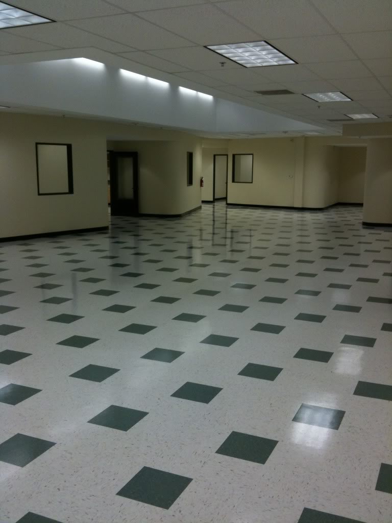

like floorguy said it is necessary but if it is an account you will be maintaining on contract, i would suggest sealing the very first time you strip it. and the first time you strip it strip everything off , if need strip it twice, rinse the hell out of it and throw two coats of sealer before two or three coats of finish and you will see what a good vct job is supposed to look like.
but agian if these are just one time jobs just use a good finish.
sorry picture quality (taken with iphone) but you will get the point.
