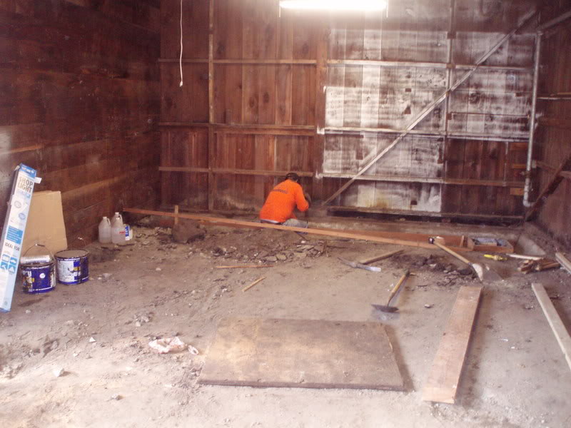

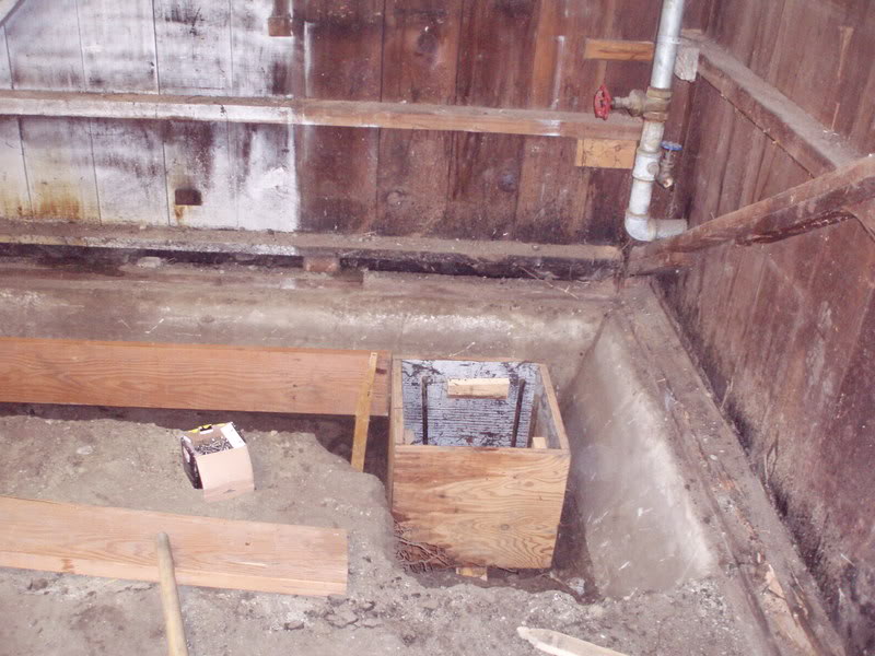

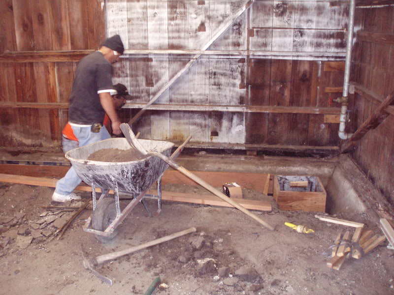

Prepping the ground to install the sump pump for the 12 by 16 Concrete wash pit.

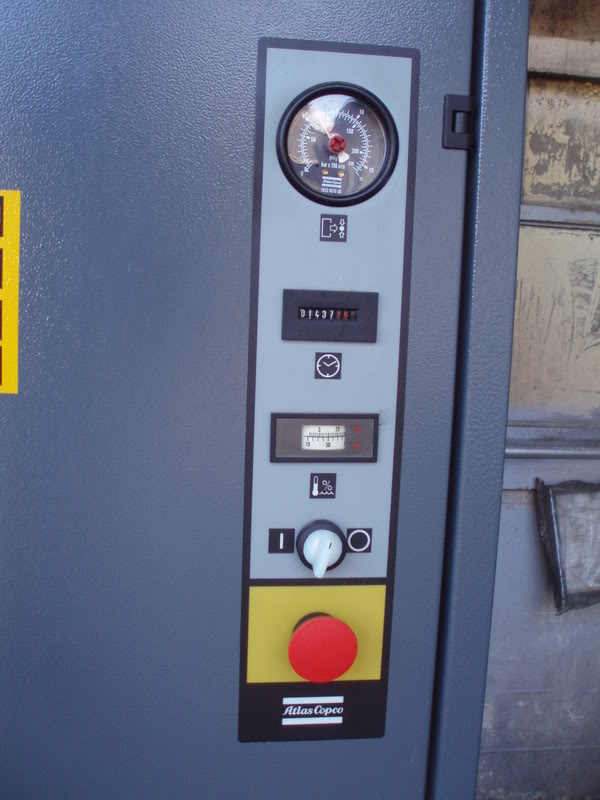

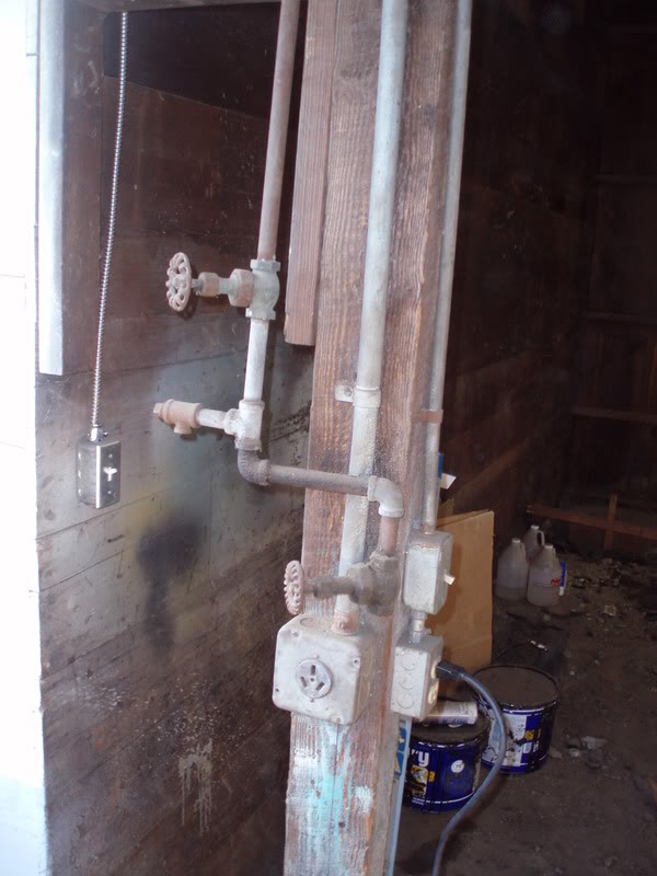

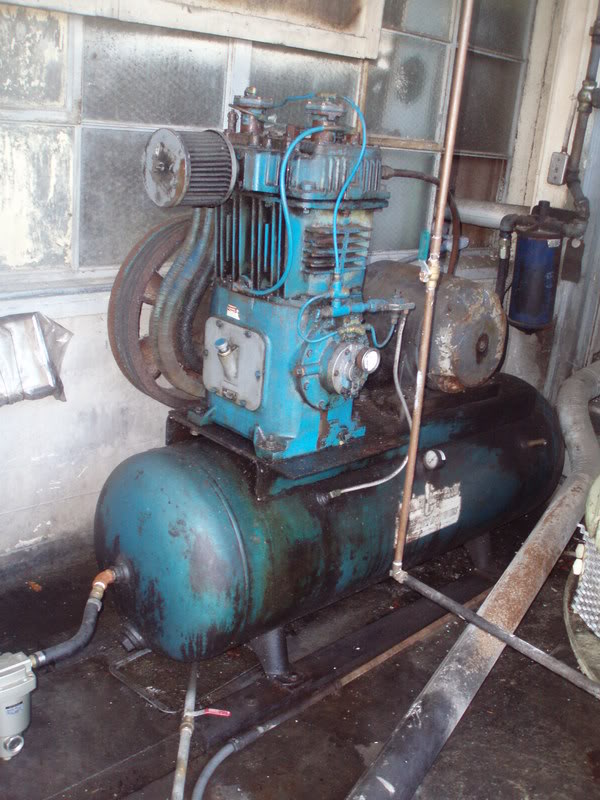

Air Pressure hook up just to the left of the Pit

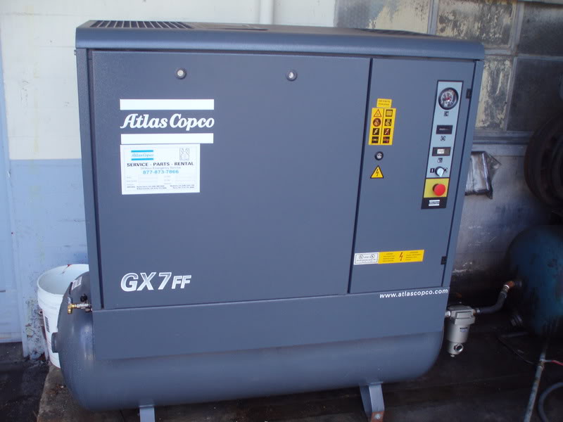

Think this baby can handle the job?
If not we have this back up compressor.

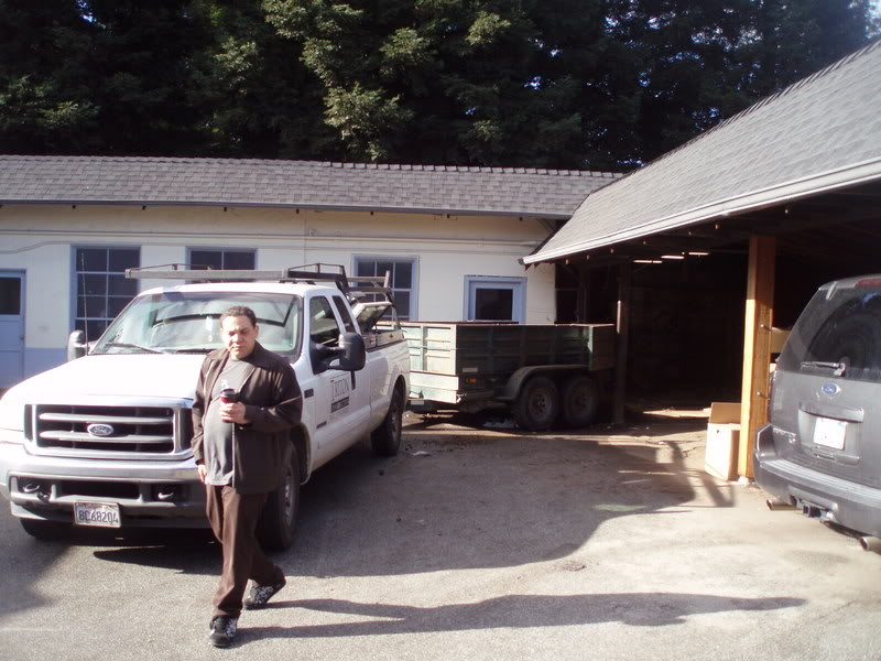

White building in back will be the flat cleaning area, site of future Centrifuge wringer and storage.
Drying room will be off to the left.
How much pressure is needed to effectively needed to blast the dirt out?
And what kind of gun/wand do I need?

Are you planning to do an Auserehl style air dusting, or just use compressed air to blow water out of fringes? If you want to air dust, call Phil Auserehl at Castle Rug Cleaning or orientalrugcleaning.com and ask if he will sell a wand without the rest of the 'system.' You can ask him if your compressor is big enough for air dusting while you're at it. He told me he recommends a 25 HP unit.
Make sure you get a box of these:
Would you air dust and use the RugBadger too?

I think I'll stick to the Badger and just use the air for extreme messes and drying.
