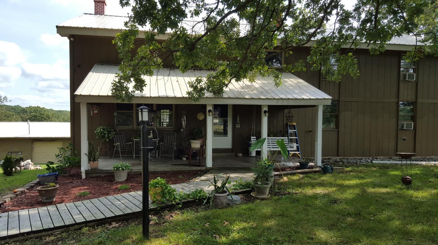

The beautiful home in this case study is nestled high atop 35 acres of gently rolling hills in Mid-Missouri. During the initial inspection, the ambient air had a pungent odor of fire, as the smoke residual particles were still wafting through the air. Power was out and the uncomfortably excessive humidity of a typical Missouri summer day was so thick it could be cut with a dull knife.
Unusual construction changes the standards for cleaning and preserving the building materials.

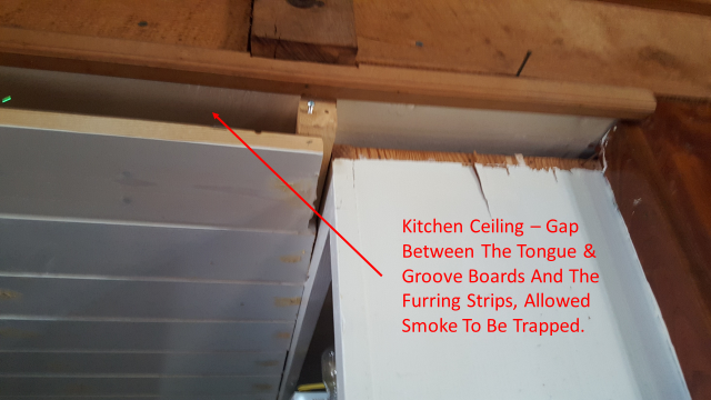

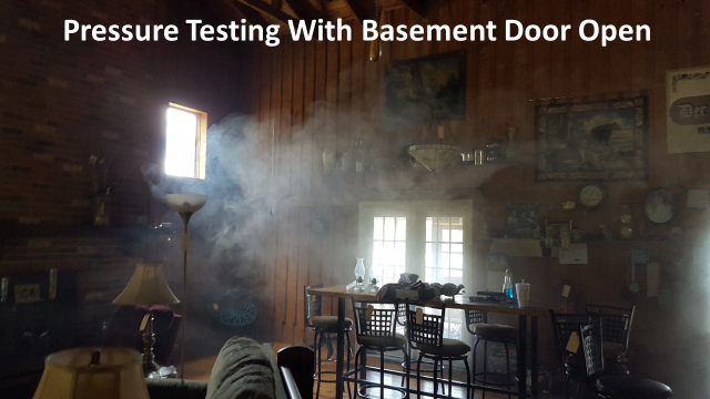

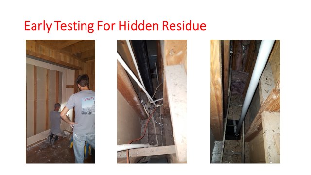

Step 1. This case study commenced with three days of exploration and aggressive testing with the intent of locating any and all areas with hidden smoke residue. The ceiling peak in the colossal great room was 26 feet in height requiring the use of scaffolding. Testing involved recreating as close as possible to the morning of the fire by introducing a commonly used process referred to as Thermo Fogging “imitation smoke”, also used as an odor counteractant, for the purpose of having first-hand knowledge of what paths the real smoke during the fire may have taken. To assume that smoke residual particles had found their way to the back side of the interior walls and insulation, would have been mere conjecture in the absence of testing. Therefore, several of the planks on walls in each of the rooms were gingerly dismantled for the purpose of testing for residual soot using dry sponges and wet towels. Testing proved that the back side of the planks and the exterior walls of the structure had narrowly avoided residue contamination, which of course would have completely changed the outcome of the repair plan.
The main level and upper level of the property had very little sheet rock. Even so, we removed some in each of the areas, once again to determine what if any smoke related damage was in the wall cavities.

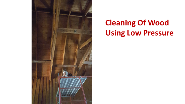

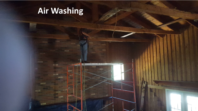

Step 2. After testing, all areas of the property were cleaned using a process known as Air Washing. High compressed air was applied to all surfaces, vertical and horizontal to dislodge dust and smoke residue particles.
Step 3. After air washing the structure, we began the process of wet chemically cleaning all surfaces, vertical and horizontal using a power sprayer rated at 150 PSI to emulsify the smoke residue and capture the waste in the catch basin.

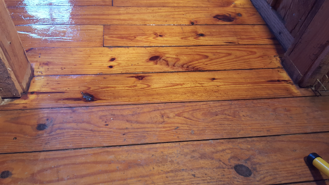

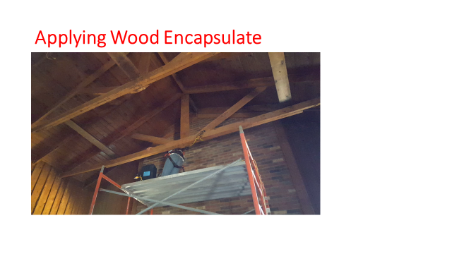

Step 4. After wet cleaning of all surfaces, vertical and horizontal we began the process of applying a wood encapsulation product directly to the surfaces. This process was repeated for a second time seven days after the first encapsulation.

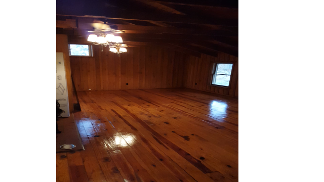

Step 5. After the above listed were completed the hard wood floors throughout the main and upper level were hand cleaned and sealed with two top coats of polyurethane.
