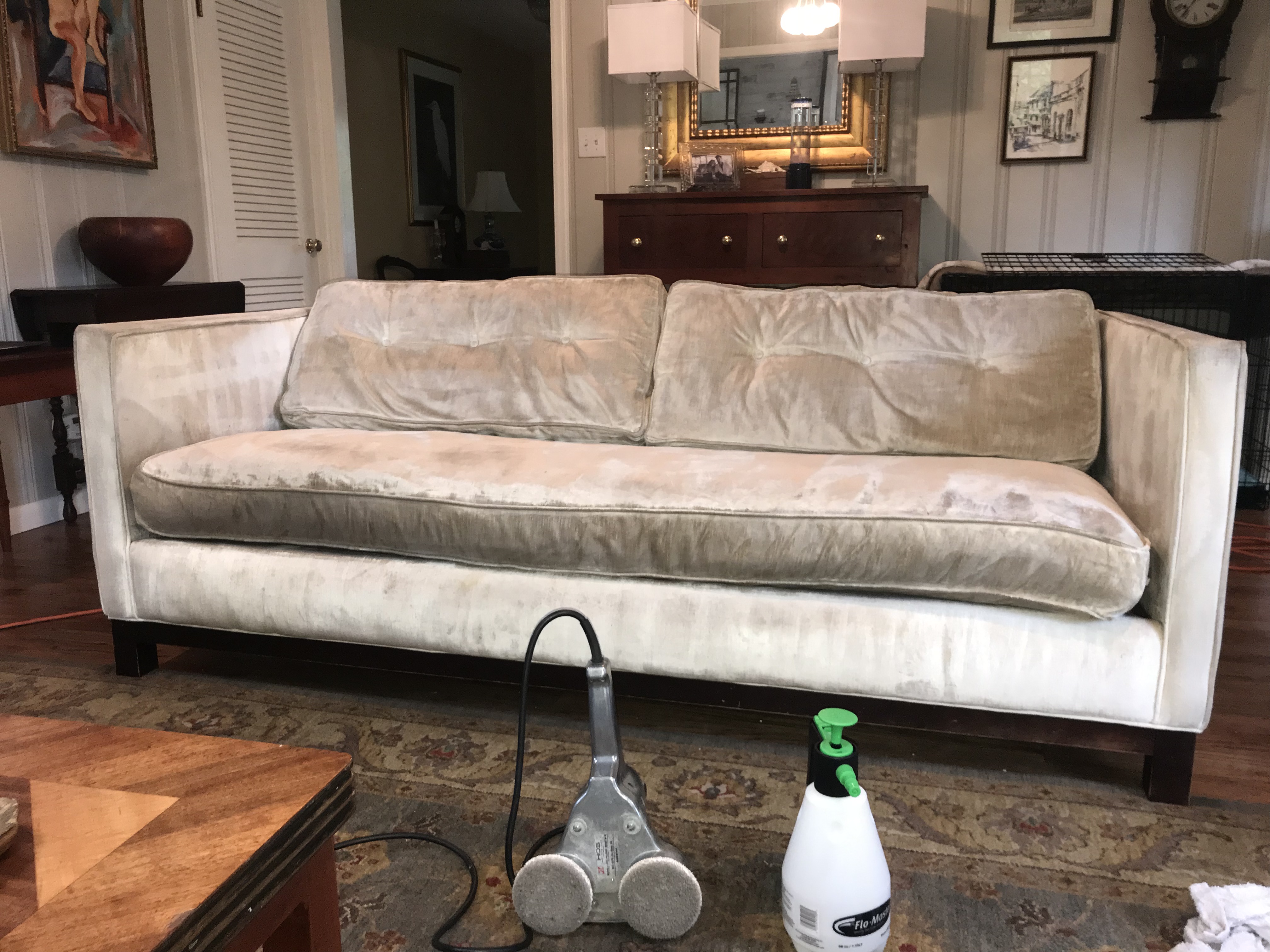

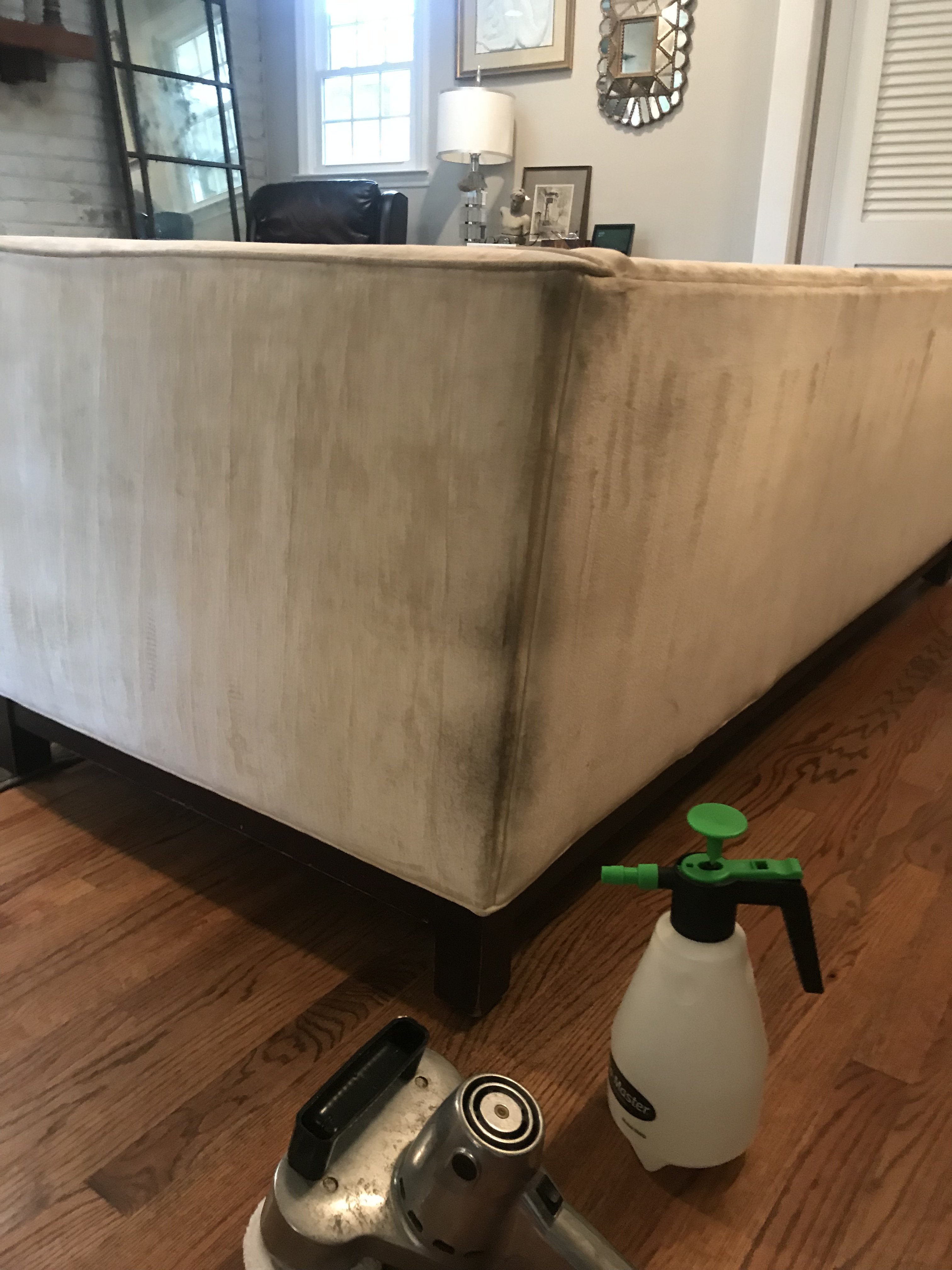

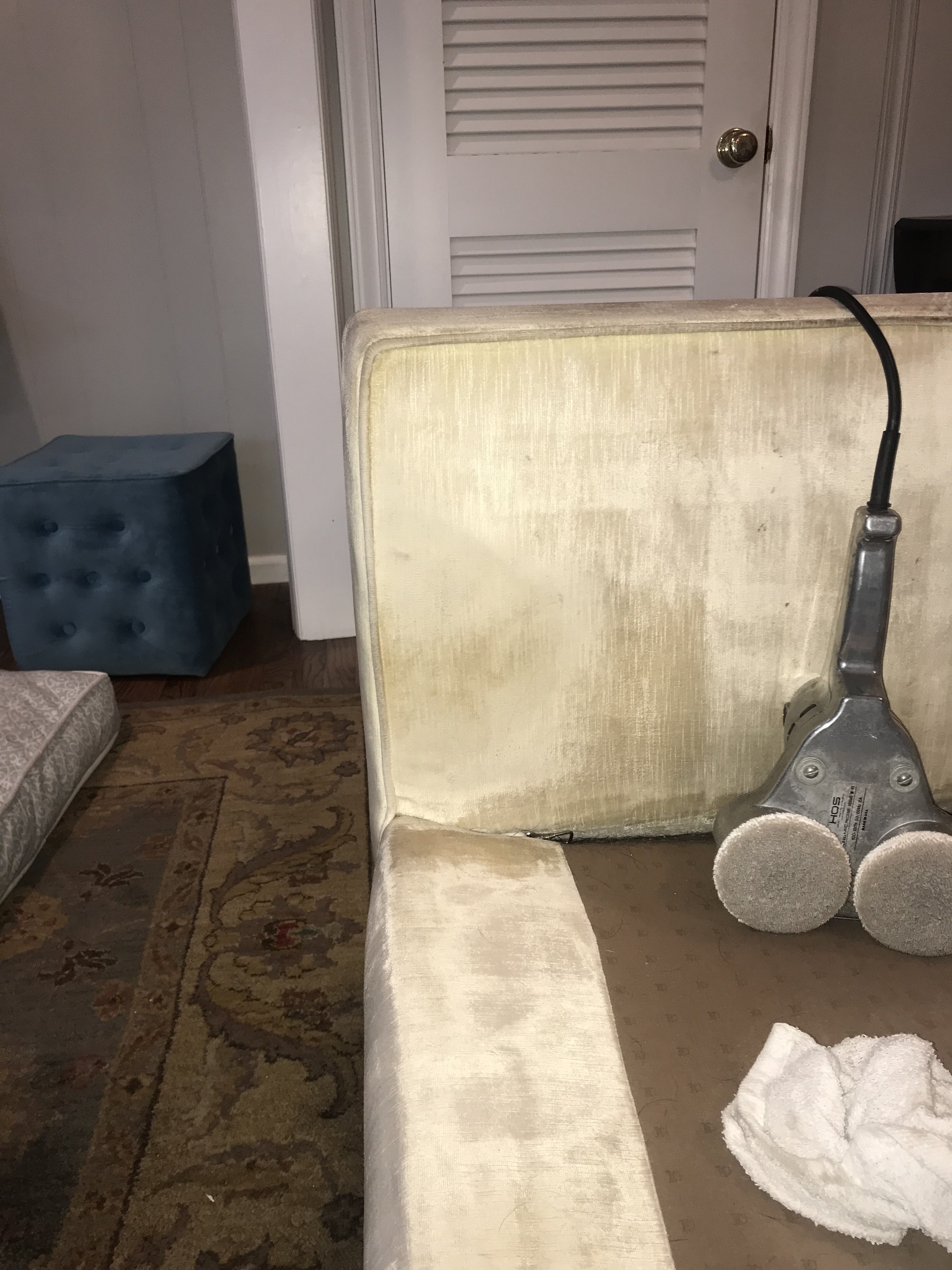

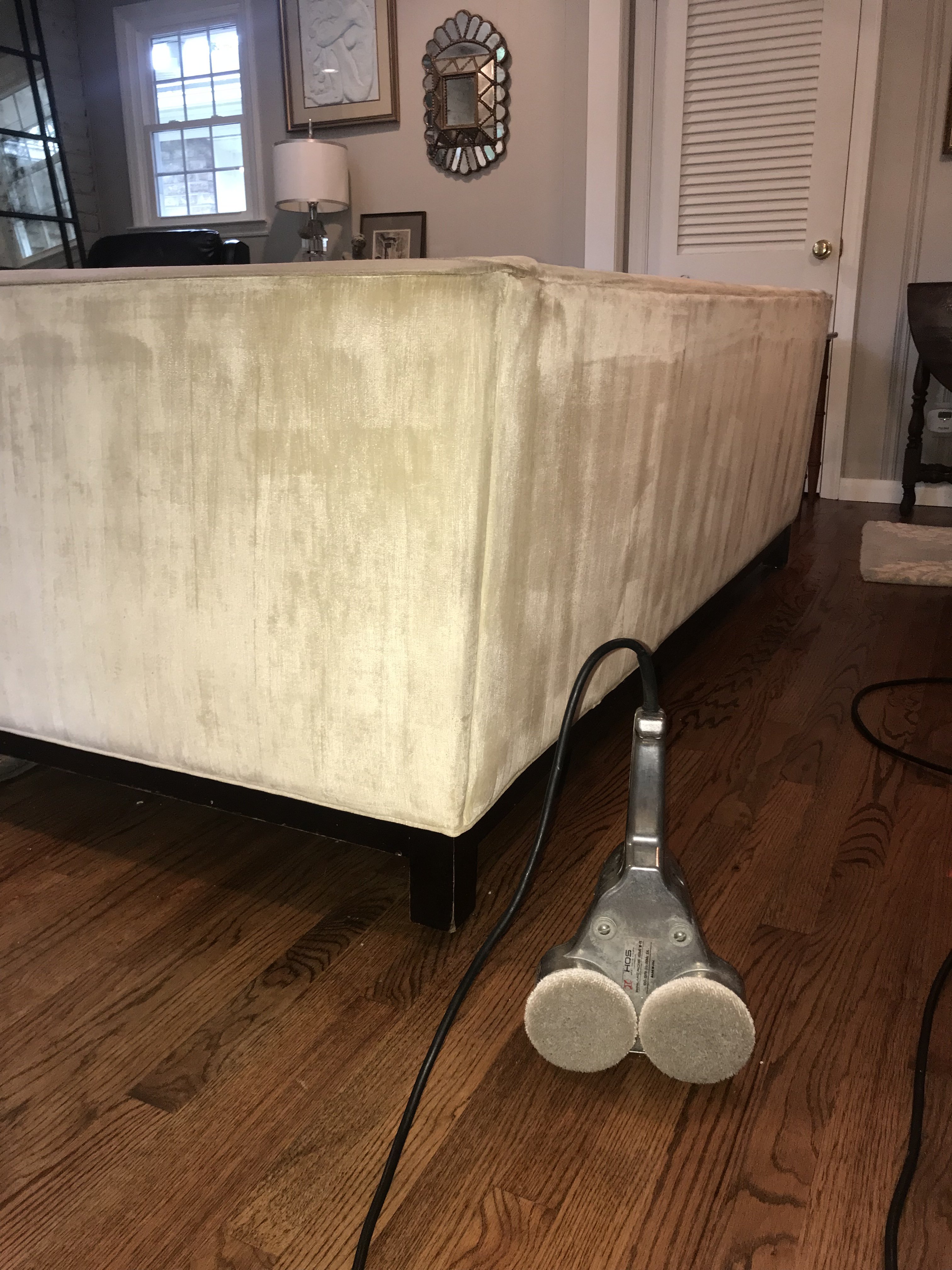

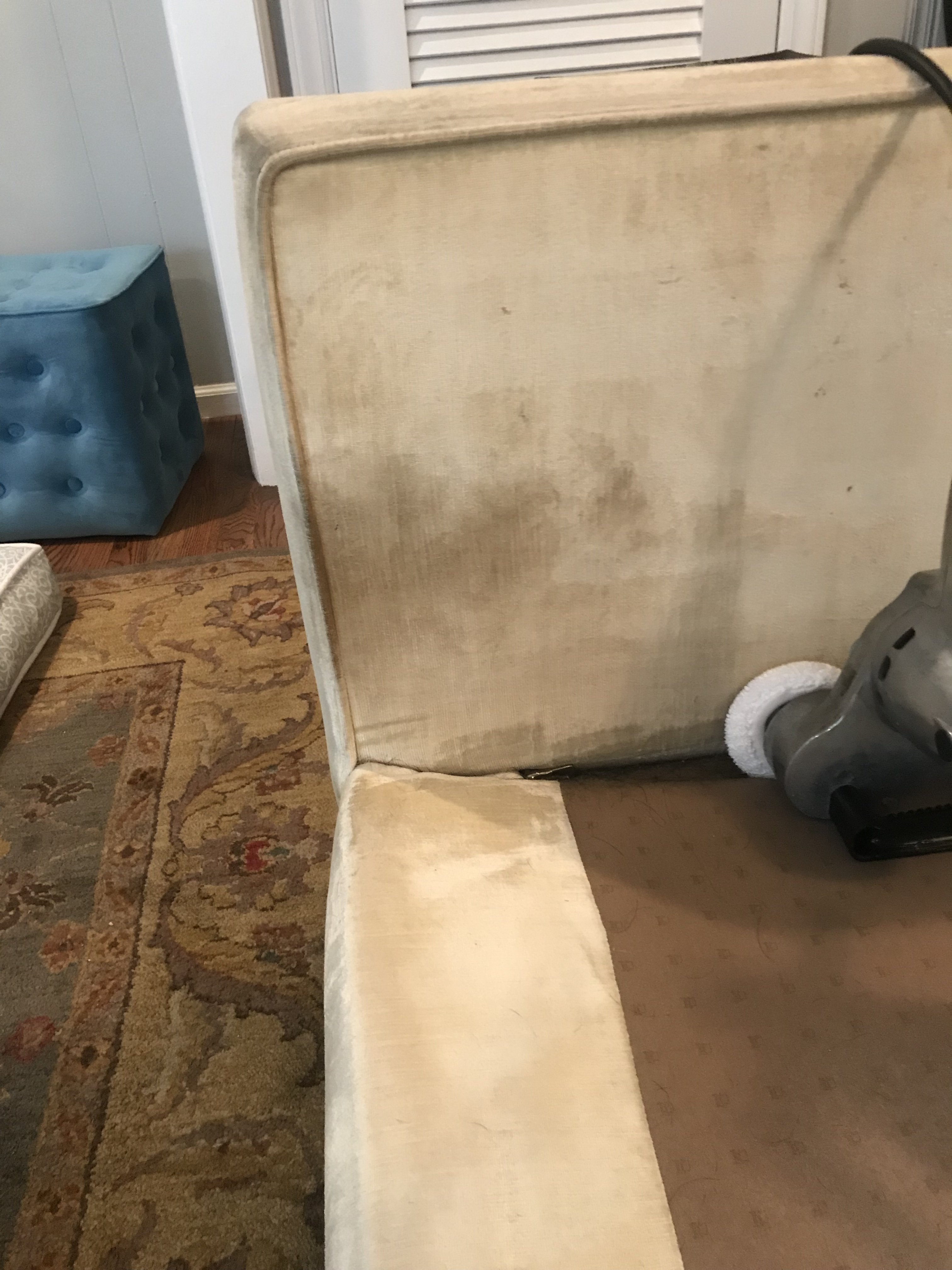

What makes you think it's viscose? Looks like microfibre to me.Just my Orbot Micro, Releasit DS2 and a rag.
Black Lab + White Sofa
View attachment 93626View attachment 93628View attachment 93627View attachment 93629View attachment 93631

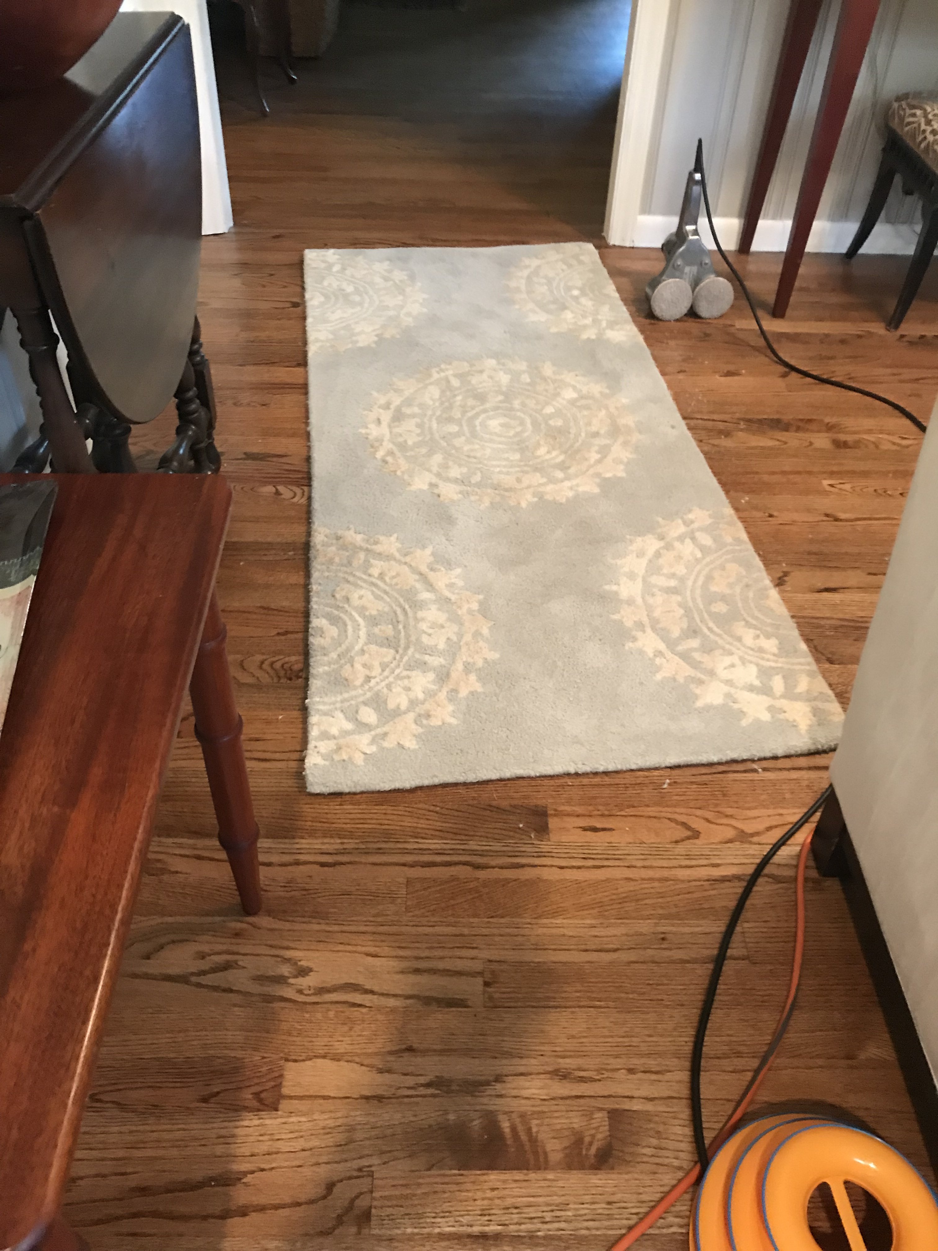

Then I buffed the hallway runner on the way out the door.
The label said Art Silk.What makes you think it's viscose? Looks like microfibre to me.
That's probably what it is then. Best to err on the side of caution. Looks much betterThe label said Art Silk.
I premix in a gallon container according to directions the put it in the little sprayer. One sprayer did the whole sofa. I don’t have the dilution ratios handy. It’s either 4 or 8 ounces per gallon. @encapman
If I used a solvent I would want to flush it with the truckmount. But that being said, if a particular piece of furniture has a lot of miles, I will use the EncapHydrox instead. But DS2 continues to impress on its own.When ever I have body oils on furniture I mist on BP's solvent clean and wipe off with a towel.............then use that scampoo.
No point in using solvent if you're going to flush it out. I use Picrin and get good results with rapid dry times.We have not found the need to flush if using a dry solvent - Trich III for years, latterly Isoprop, or Perco.
