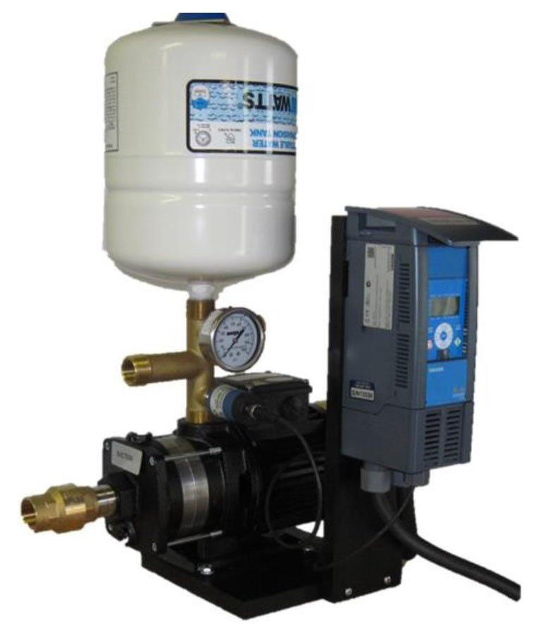

The TW1000-30W-50 Flag Frame Booster System (Shown above) is equipped with a centrifugal pump regulated by a variable frequency drive that controls the pump operation to maintain constant pressure regardless of varying demand or fluctuation in incoming pressure. This system will supply 30 GPM with a 50 PSI overboost.

The suction (inlet) on that pump is 1-1/4". If your domestic water piping isn't at least that size then you probably won't see 30 gpm. And the description matches my earlier comment that the pump's function is to maintain pressure, not boost flow. Same suggestions as before. Not a bad looking setup, though.
I have had two water pump engineers tell me that you can boost pressure and a measure of flow with a booster pump (Similar to the picture shown above earlier) if installed directly after the meter. The idea is that the pump (not oversized for the attempt) will pull a greater g.p.m. through the pump and increase the p.s.i. too.
Having said that, there are limits and parameters. 1) Size of the meter and supply line; 2) size of the pump; 3) size of your lines after the pump.
In my case, I have an one inch meter and supply thereafter that is maintained in the entire building until we get to faucets, toilets and outdoor water spigot. My current pressure is about 50 p.s.i. at the end of the line through a one inch unrestricted pipe with a measurement of 20 g.p.m. This is fine for most things I will do. I am making a boost for some other tricks I want to accomplish in the warehouse. I will be able to increase both pressure and flow a bit above my current situation with a booster pump sized for my situation. If you oversize the pump, you can starve for water and that would be stupid. The meter will only allow so much siphon.
