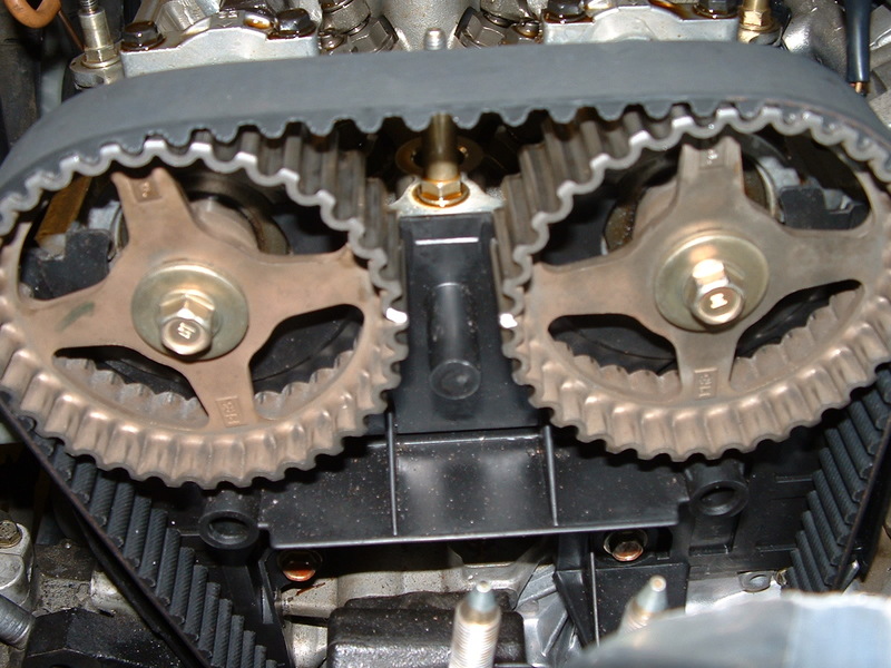

Still so many don't get it..
Slotted belt on a slotted flywheel or pulley, the belt acts as a chain on a bike. The pulleys are like a bikes sprockets.
Slotted or solid belts on normal pulleys are pretty much the same in function and are not gear type drive like a timing belt.
