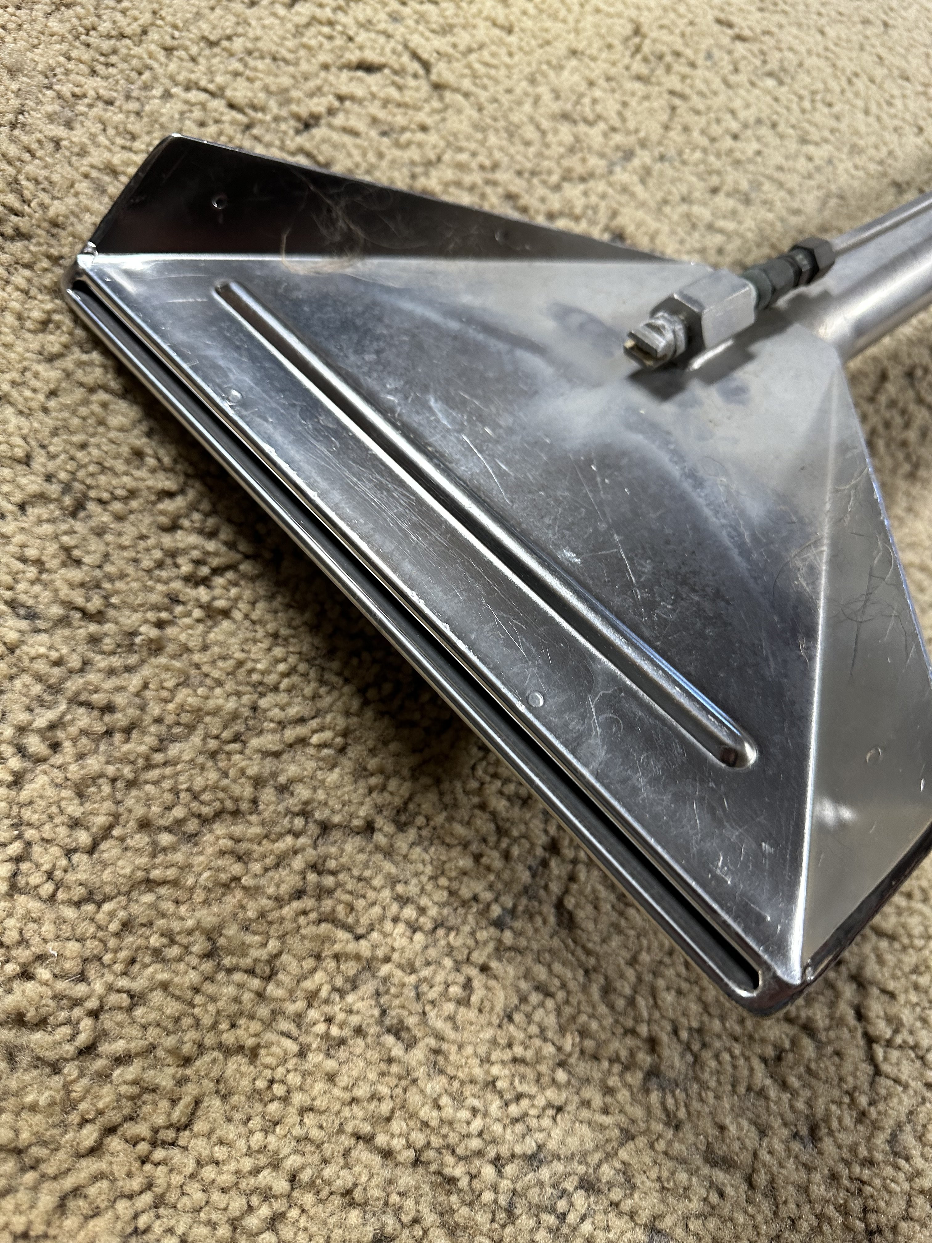

A little positive feedback for you on the flat front slotted glide Ti wand.
It grabs the carpet much more than the previous green glide, which I think is good.
115,928
The only reason you're feeling a grab more sensation is because it's new. the interface is exactly the same but as a GG wears in they become easier and easier to push as the Teflon essentially glazes over..
