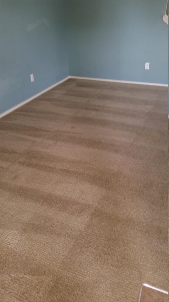

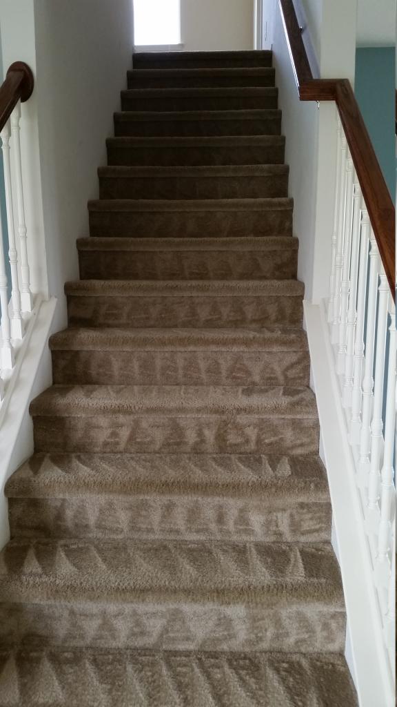

should of taken befores on this one as they thought they had to replace the carpet. i believe many kids might have contributed to the mess, but with cobbs powermax some dwell time and the hoss made quick work of about 1200 soft in about 1.5 including the stairs which were very matted down and flat. took a bit long because cleaned by my self which doesn't happen too often.
you should of seen the ball of cat hair i pulled out of that house.
