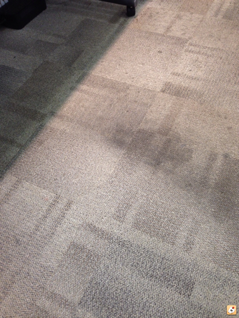

Ashley;
What was the left side of the photo ?
Was that cleaned at the same time with another method ?
